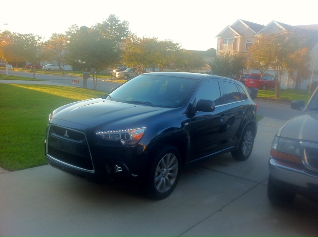

Try YouTube, that's how I found out how to hook up mines, I just wired them to my parking/city lights, I wanted them to come on just by turning the headlight switch on. The sweet part is they come on when I lock the car to.
