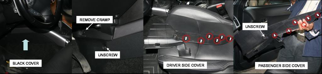

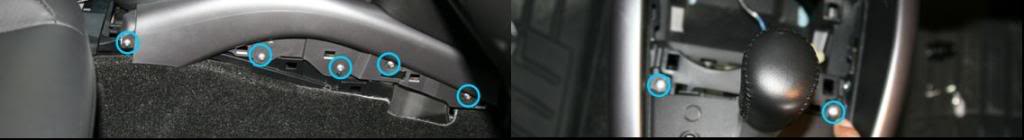

1. I followed these steps from jsrd to remove the panels.
Remove, pulling upwards, the cover in where is the 4WD selector, is fitted by clips, and unplug 4WD conector
http://i339.photobucket.com/albums/n...d/Imagen12.jpg
Remove black cover indicated, driver and passeger side: first, unscrew and uncramp; second, pulling gently for release it of clips
Attachment 7335

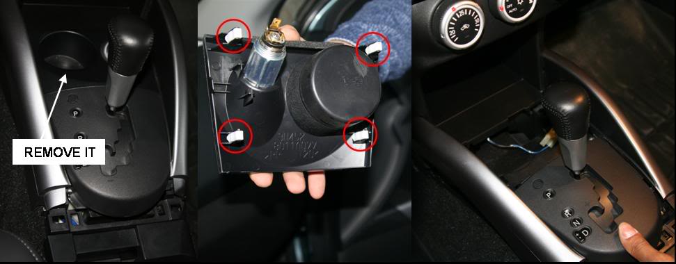

Remove the power outlet cover; pulling upwarsds, is fitted by 4 clips; after, unplug the power outlet conector (this is where I piggybacked my power wires, I did have to extend the wire to run to the front of the car)
Attachment 7336
Attachment 7337
I tested everything and it worked like a charm, had great sound and charges the Ipod only when the car is on. It only took about 45 minutes and probably would have been faster if I didn't keep running in and out of my house to look at the instructions online.
