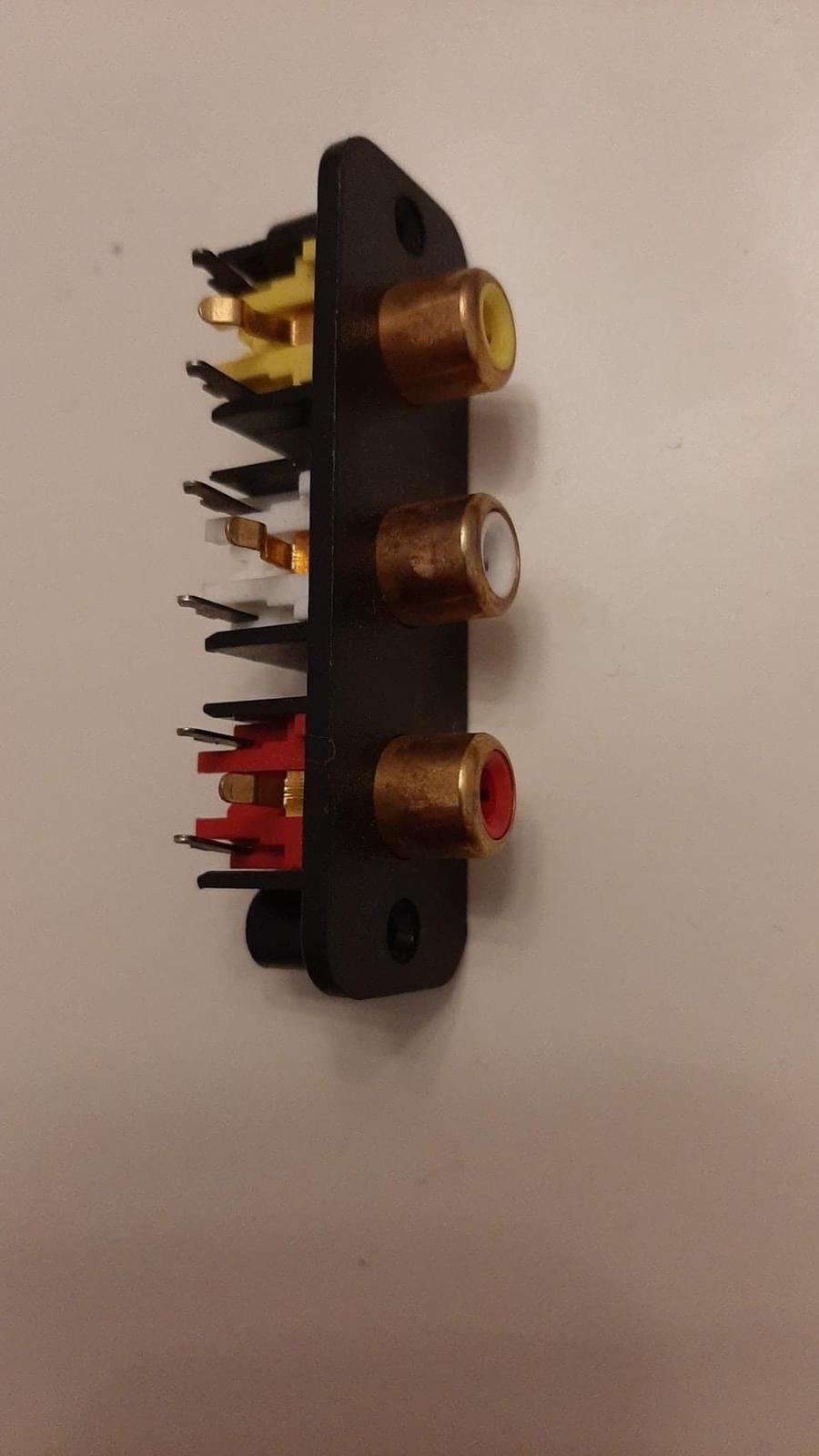

Hello guys ! First of all excuse my spelling ,I really like the community here ! I'm the proud owner of a Mitsubishi Outlander 2008. really nice car, It has navigation with hdd , aux function active in the menu, rockford fosgate sound system , original rear view camera bud sadly NO PHISICAL RCA / AUXILIARY INPUT in the armrest. My car is equipped with the D-117 wire ( as you can see in the picture ). Can anyone help me with the arrangement of the wires from my standard 5 wire ( black blue white (empty space) brown light blue ) or D-117 to the common 3 jack RCA ( red yellow white ). or is there a possibility to buy the jack that fits in the D-117 socket. The desired resalut would be a audio jack input, or ideally bluetooth input for listening music ( the car has bluetooth for calls only ).
Any suggestion is appreciated. all the best !
→Car port :
→Standard Audio Video RCA
→Desired result / possible outcome :
Really looking forward into reading your reply's !

The most simply way, just solder RCA connector directly to cables as is difficult to find compatible for that plug connector
I made drawing for You, unfortunately, I can't solder via internet
3 way RCA socket I desoldered from old broken DVD player, You may find them may kinds in local electronic stores or at least if You have time and wait for delivry is alliexpress
Hope You can hold solder tool in a hand and connect it
Succcess
