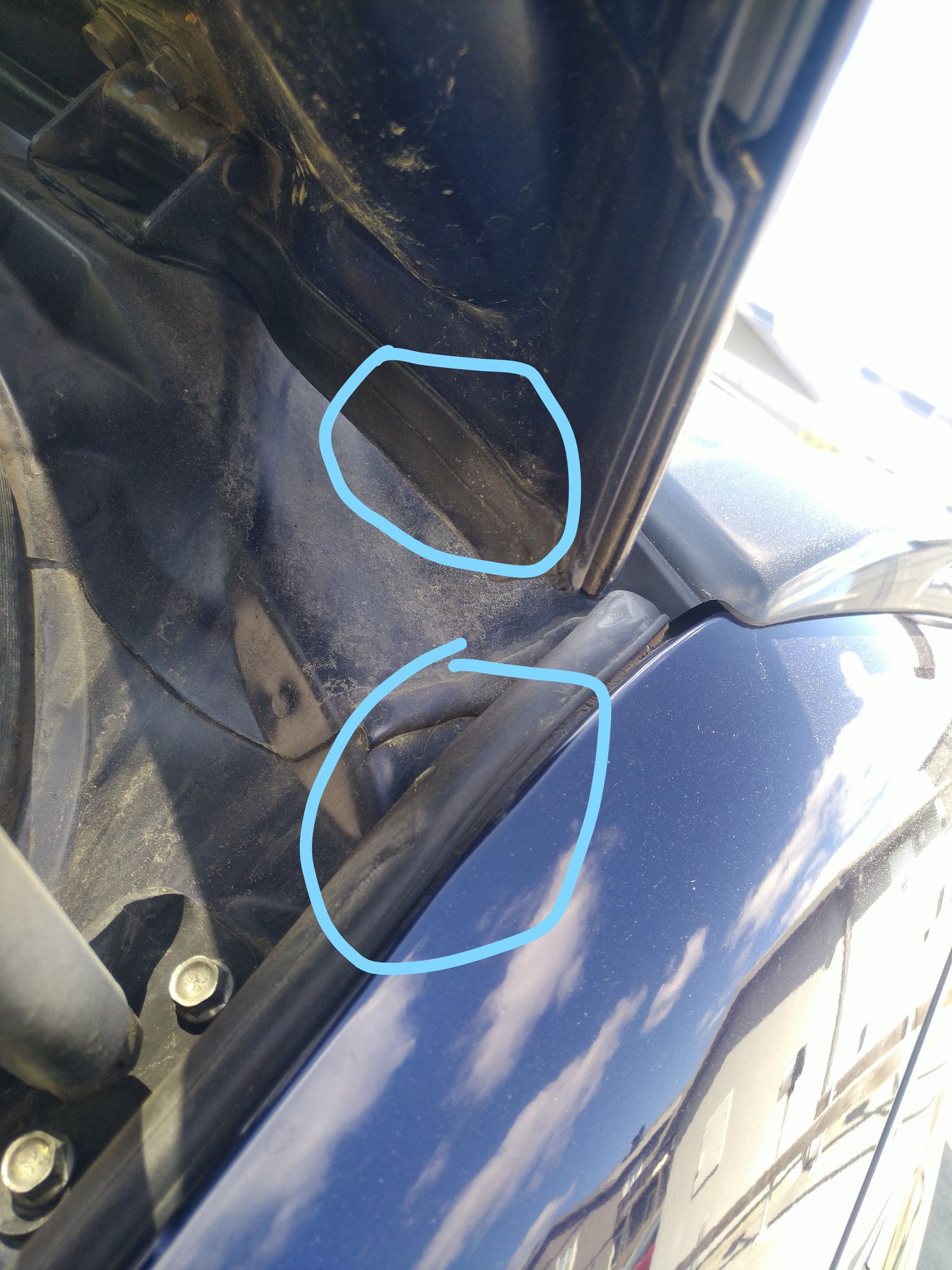

I am so guttered I have had my new outlander for 3 weeks and I have found that is it leaking.
My car has wet roof lining a inch above the rear door and over the seatbelt front and back both sides.
my seatbelts are also wet, and all inside the door hinges are also wet.
The dealer can’t find the leak and said they have never seen it before.
Has anyone experienced this?
Would you be demanding a new car?

When there is a design fault, the dealer will always tell you that they have never seen it before.
The wet frame between the doors is normal fot Outlanders because they do not put outer door seals or these are made of crappy and too soft rubber. In my 2013 i had to install additional outer seals and insert thin silicone hoses inside the all 4 inner door seals to make door slamming feel more solid.
If you have wet linning on the ceiling then it is a major fault. Tell your dealer that they must replace all seals on that door regadless of where the leak is. The seal is leaking!

Hello same here - the recess in all the doors are exposed to the outside weather that's why they become dusty as well which is normal. The seat belt does not sound right are you sure it was not jammed in the door well.

Just wondering if you had this issue resolved to your satisfactopn? We have a brand new 2023 PHEV Outlander Exceed and it is leaking into the roof along the drivers side and also into the drivers seatbelt pillar. The dealer is pulling it apart right now.
