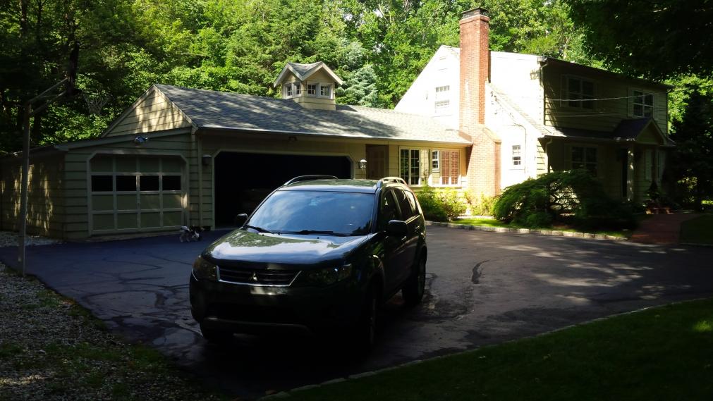

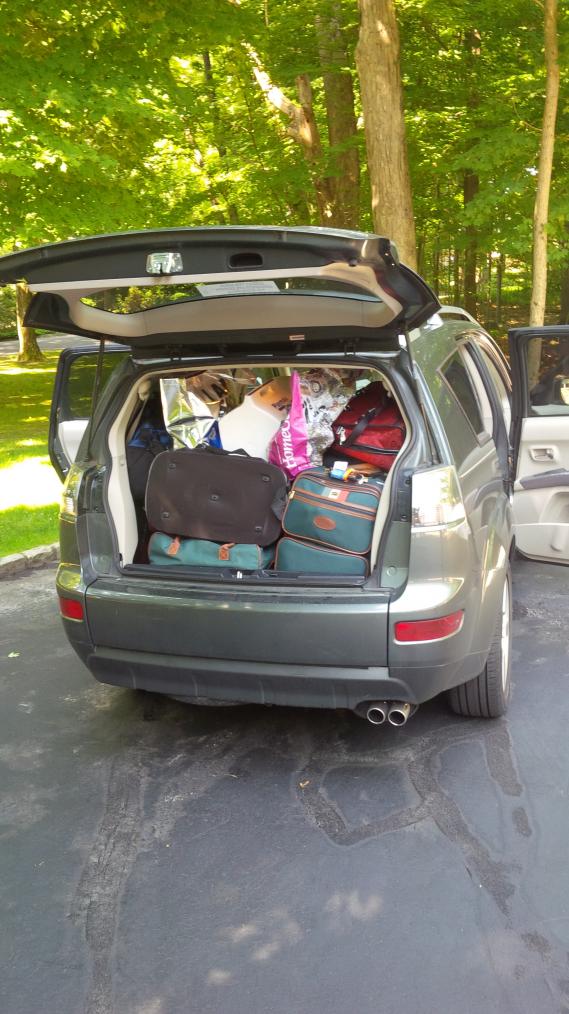

I never envisioned driving my wife's Outlander across many states, I thought it was too small and darty for a long highway trip. But we did it, and I was pretty pleased with the Outlander's cruising ability. Before the trip, I got new tires and new front brake rotors and pads (one of the OEM front rotors caused steering vibrations at highway speeds since the car was new).
We started in South Florida and drove to Amelia Island (just north of Jacksonville), then Charleston SC, then Baltimore, then New Haven, then Narraganset RI.
Me, my wife, two teenage kids, and a small dog, and a ton of luggage (I removed the third row seats to lighten the rear and get a bit extra space.
Here are some pictures I took of the Outlander while in CT

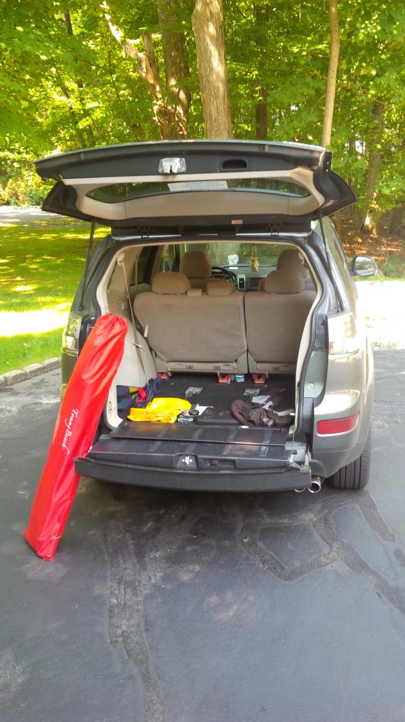

Unbolting was easy. Lifting the sucker was a bit hard... it is heavy, and I am not a wimp.
It has these "ears" and you need to maneuver it out while dealing with the heft.
No, I did not remove the seatbelts.
You don't gain much space at all by removing the third row. All that fit in there was:
- an emergency kit (like a small briefcase)
- a foot pump
- a half bag of dog food
- a small wrench/socket set
- a torque wrench
- a few small loose items
all that came flush with the main floor.
But I was glad I didn't have that extra weight in the back.

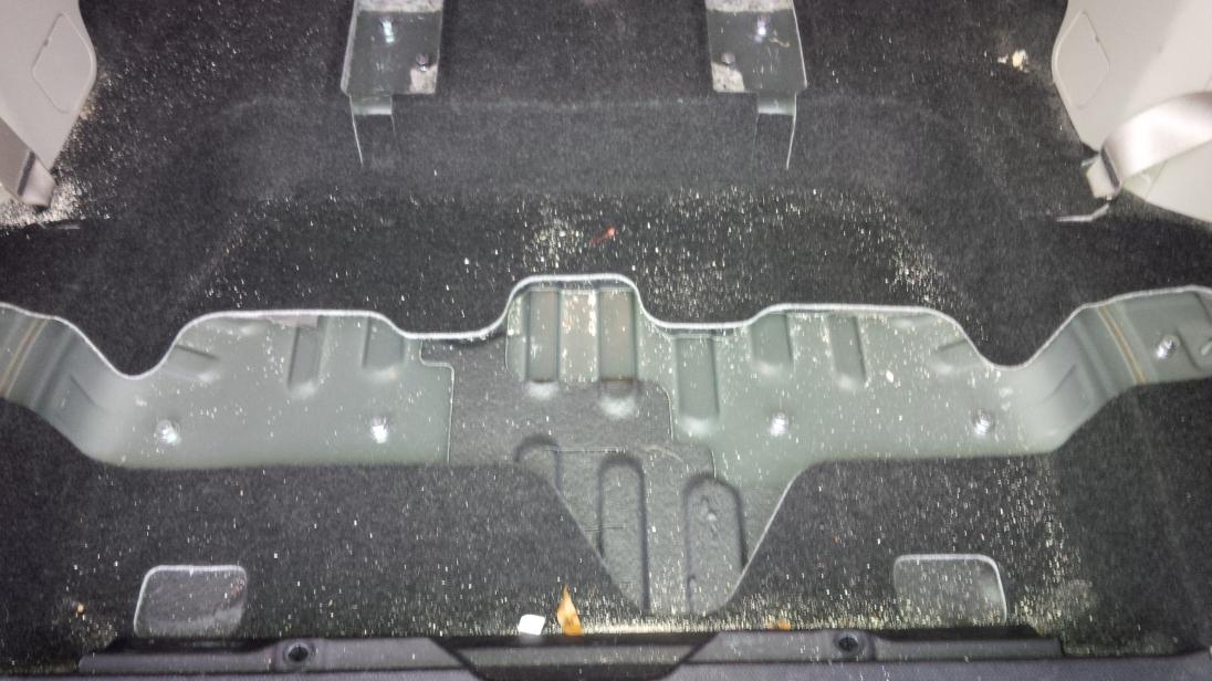

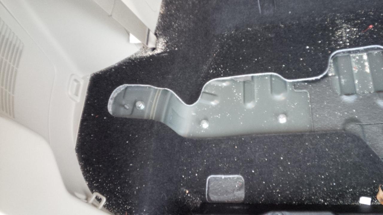

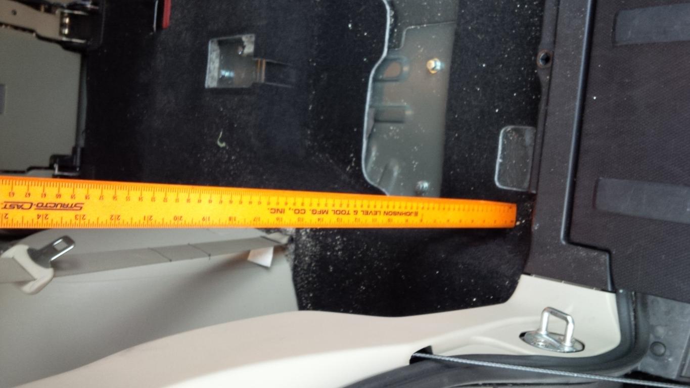

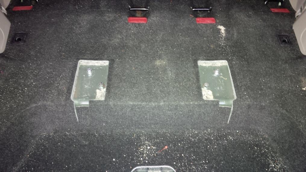

Took some pics before I put the 3rd row back in.
While the seats were out, I left the bolts in their holes (didn't want any air whistling through these holes on my road trip )
So you can see exactly where the bolts are.
All the carpeting is on velcro, easy to remove or flap away.
Except one piece of carpet that covers the seat's spring mechanism - that piece of carpet stays with the seat assembly.
And there are two plastic covers that cover the bolts where the front legs go. They easily come off and just as easily get reattached.
I would say the best way to start removing the seats would be while they are folded:
undo the bolts that hold the front legs and the sides.
Then pop up the back and undo the bolts around the spring mechanism.
