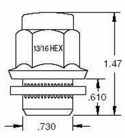

The thread is 12mm x 1.50 mm (first # is diameter and second is pitch)
They look like this

Thanks,Claude_A, so I assume that I can reuse the current 18' rims set of 20 nuts for the 19' rims, or to buy a separate set of 20 of these?

You can reuse the Nuts as long as the wheel web is close to the same thickness as the 18" and the hole is big enough to accommodate the nut shank.
Remember the studs are on the hub and they don't change with the wheel.
Also those wheel are located by the Hub spigot (the raised 67.1 mm disk in the middle of the hub) and the lug nuts only clamp the wheel to the hub.
Torque is 66 to 80 Lb-ft
Have fun
Also the .2% difference is negligible and within the wear limits of any tire don't worry about it.
Exactly (the 19' will actually run 2 miles more than the 18' to reach the ODO 1000)
