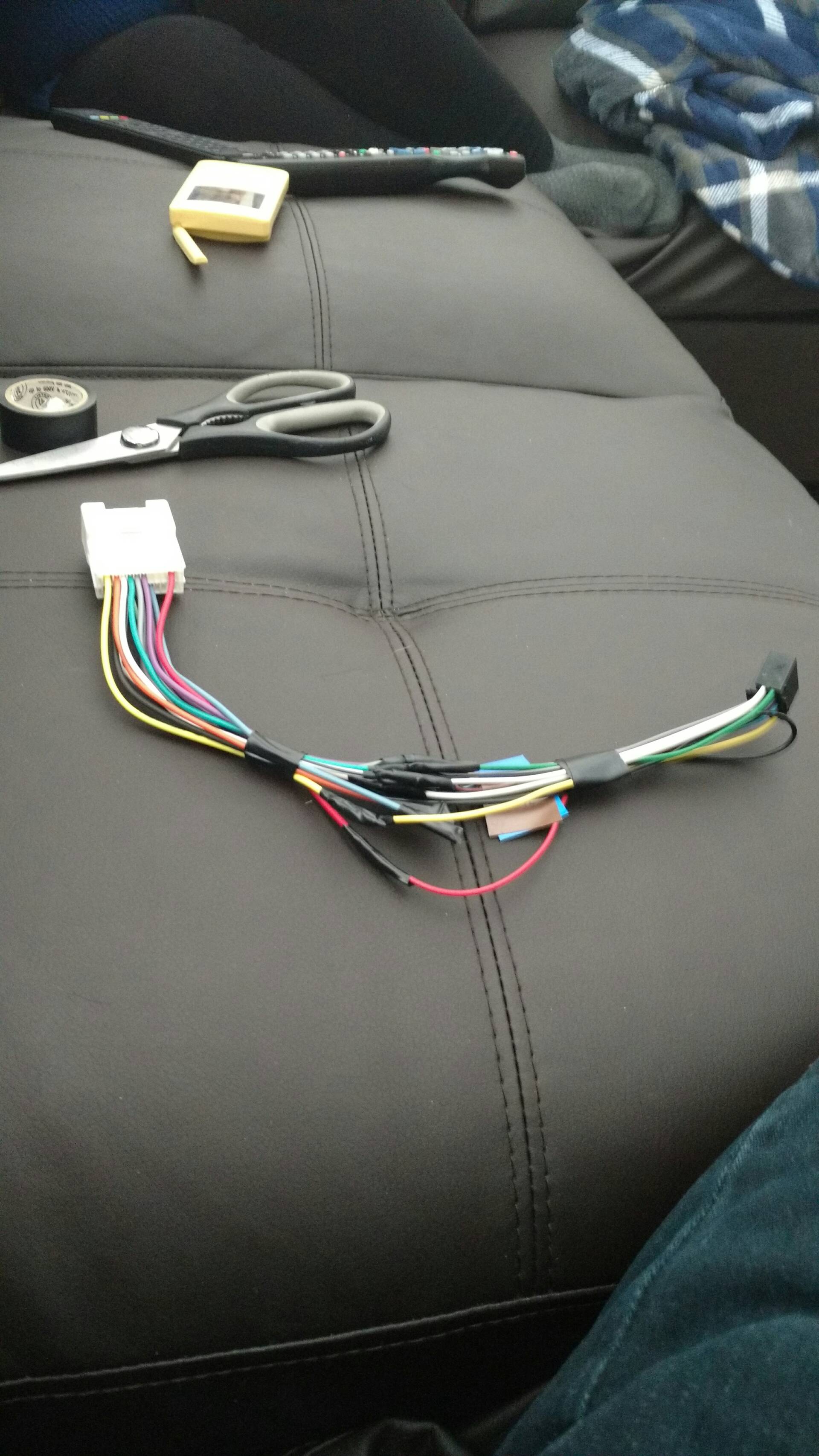

It's easy if you buy the wiring kit. I replaced the head unit in my RVR, unfortunately shortly before trading it in for the Outlander. I bought this wiring kit for Mitsu's '07+:
Metra 70-7005 Wire Harness for Mitsubishi 07-up at Crutchfield.ca
just solder and tape the color coded wires and it plugs directly into the existing wiring. Everything worked for me.

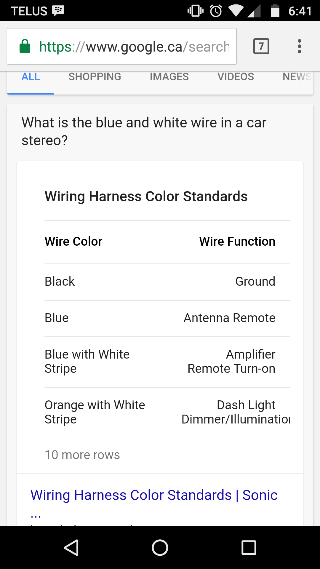

One of the links you posted didn't work, but the other leads me to believe that the blue/white wire coming out of the plug may be the culprit. Where exactly should that be attached?

Both links mentioned issues when either the amp remote or antenna remote wires weren't connected. Here's a screen shot.
