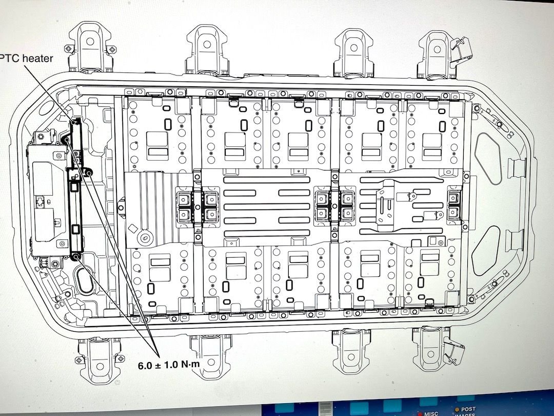

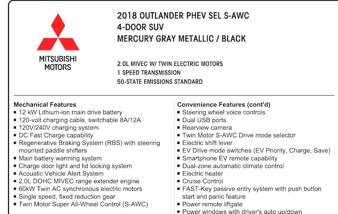

Hey guys - thanks for the reply's - Concerning the Outlander's Drive battery in Winter, here’s a few battery images from older Outlander’s which incorporated a battery warming PTC heater circuit. As shown on the 2018 Outlander sticker, the battery warmer was standard equipment. You can find it under Mechanical Features; “ Main Battery Warming System”.
While this past battery heater only worked while being plugged in, it allowed owners to pre-heat the battery before departure, allowing the battery to have additional capacity, prevent battery damage and also prevent the drive battery from getting cold-soaked and shutting down.
My research found two different heaters were used, one heater was side mounted on the battery case and the other integrated into the AC cooling system where the AC fan is used to circulate warm air throughout the battery.
For reasons totally unknown, Mitsubishi did not include a drive battery heater in the new 22-23’ generation Outlander. Even though almost every EV uses some form of a drive battery heater for winter they omitted it. As I mentioned it took me months for them to answer my heater questions and they only admitted there was no heater no other details why? Mitsubishi has been tight lipped on this battery heater decision since a cold-soaked battery could leave the occupants stranded with no way to start the car or even heat the cabin which could result in Outlander being liable.
As I mentioned in my article, if you live up North you should give careful consideration if the Outlander PHEV is going to provide the security and safety needed for yourself and family for winter commutes or trips.

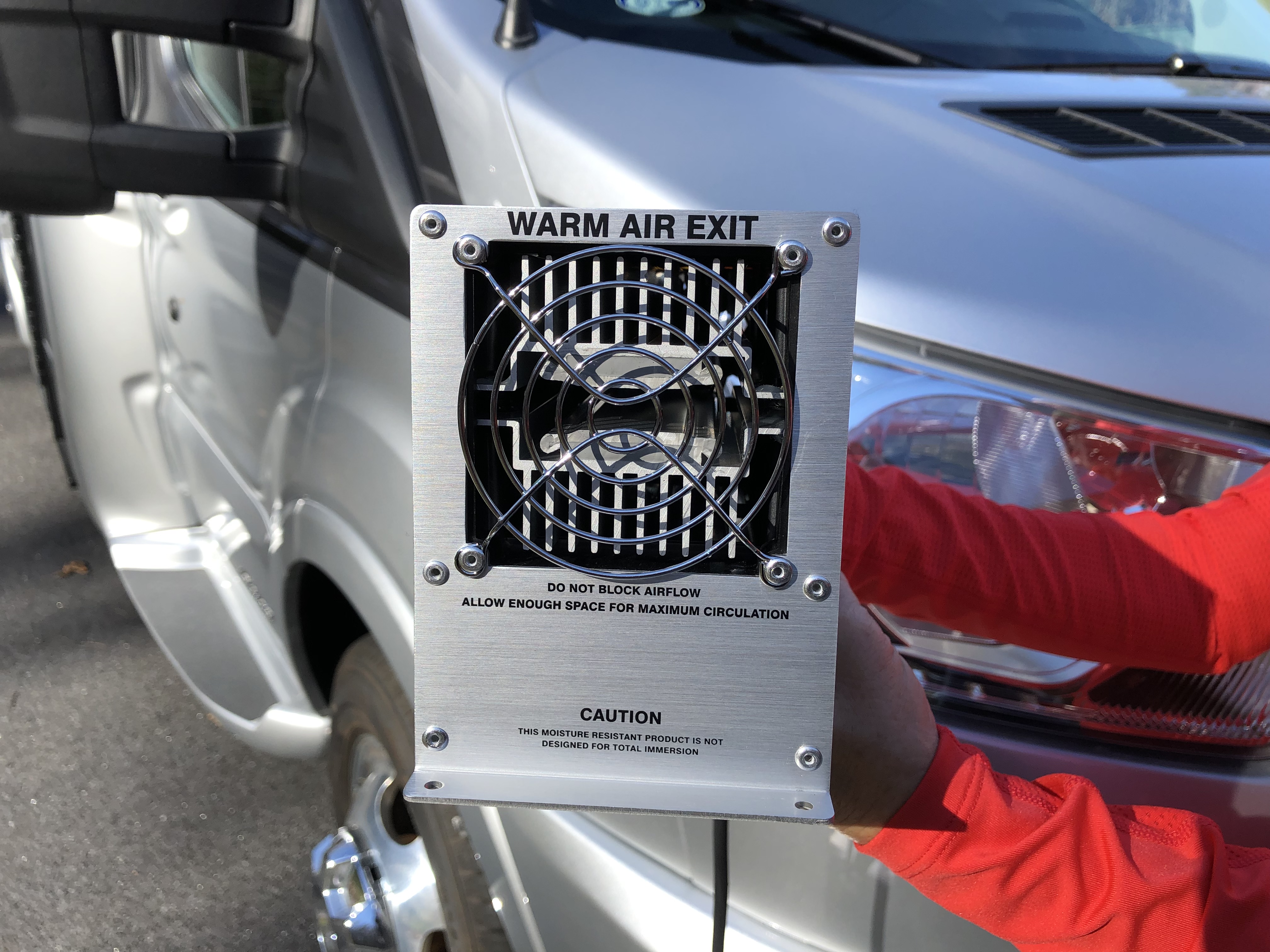

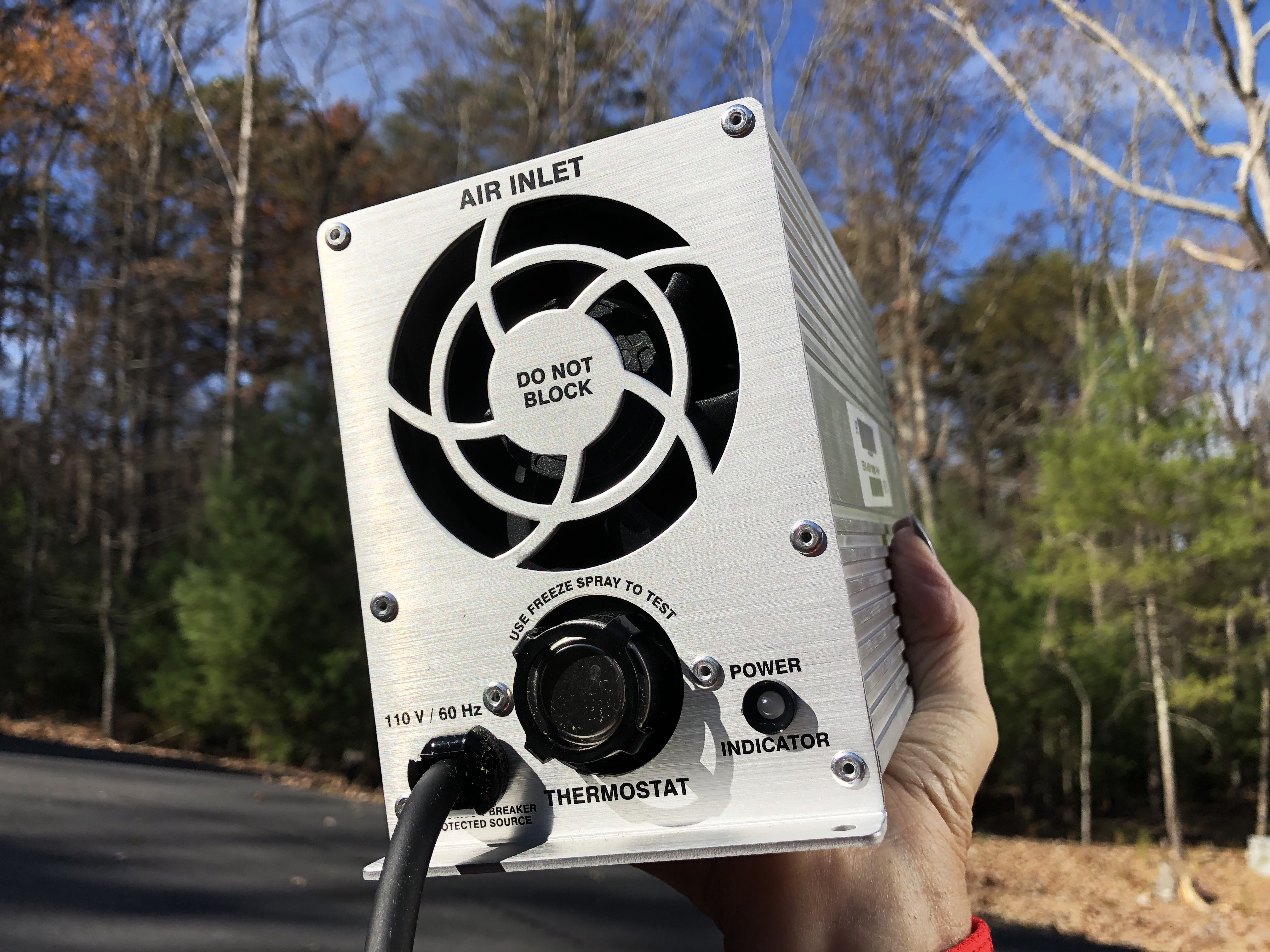

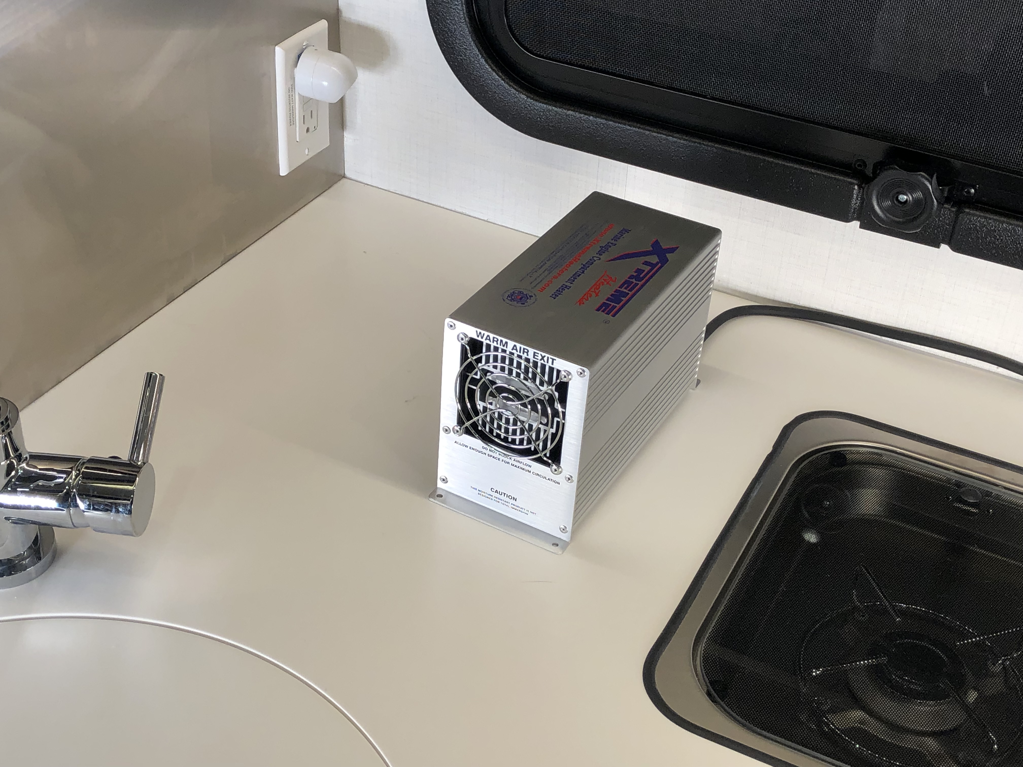

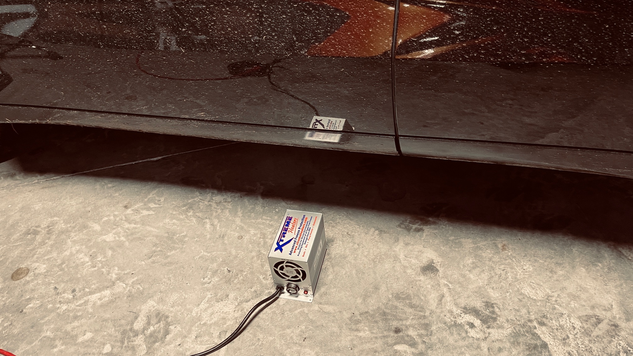

Hello all - definitely a cold spell we're having - A tip to help keep the HV battery a bit warmer is, I use a 800 watt Xtreme Marine & RV heater. These coast guard heaters are manufactured by www.xtremeheaters.com This heater is very safe and constructed 100% of 6061 T6 aluminum so there is no chance of fire. I have been using this heater for years in all my RV lithium installations.
By positioning the heater along side the car, the fan blows heated air to the undercarriage where it rises to maintain or warm battery temperature. Since the battery case is aluminum it readily accepts heat (or cold). I position it right by the drivers door as a reminder to move it.
While its certainly not a HV battery heater, it will help to at least maintain temperature of the Outlander battery. On warmer days in the 30-40's F, I actually witnessed the battery on my EV6 increase 3-4 degrees overnight.

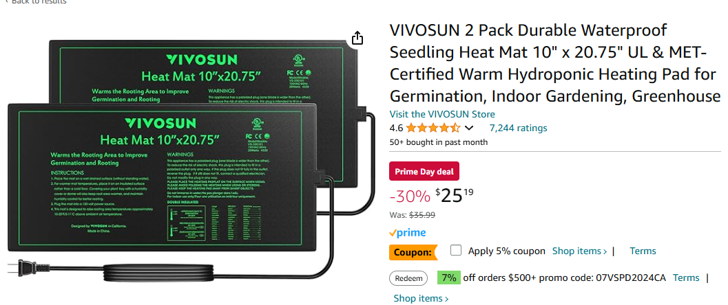

After reading your article and trading a few messages on a Facebook forum, it seems that Mitsubishi's answer to the concern over a battery becoming "cold soaked" leading to possible plating was a software update, I am wondering how that is supposed to address the issue it there are no components like the heater that was installed in previous models.
It also occurred to me that a warming mat like those used to start seedlings could be affixed to the outside of the battery and the mat could be plugged in like a block heater in colder weather. I am wondering what the battery case is made from as if it is plastic or metal as metal is much more conductive. I am aware that a class action lawsuit may force Mitsubishi to install a heater of some sort that could work as a block heater as a result of the suit, but for those with an 23 or later Outlander PHEV if they are in cold climates maybe a seedling warming mat would get them by until then. Any thoughts on this idea?
