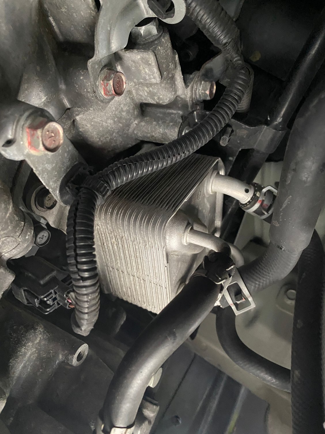

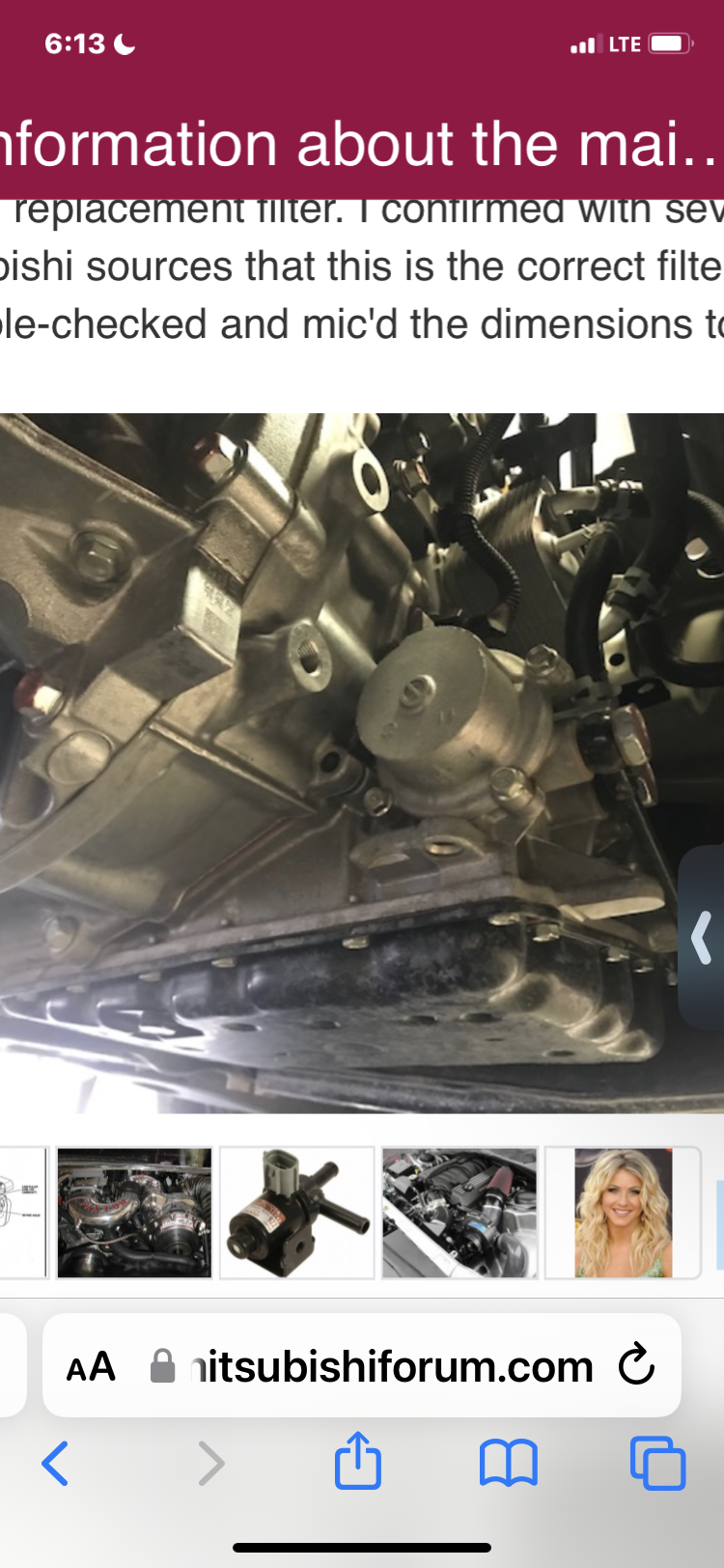

Hello,
I have a 2017 Outlander ES model and would like to know if anyone can verify the location of the second Cvt filter? Uploading a pic of the possible filter locations….Thanks

But n my 2016 it’s that 2nd picture.

Found the location, The filter is located inside the cover in the second picture.
