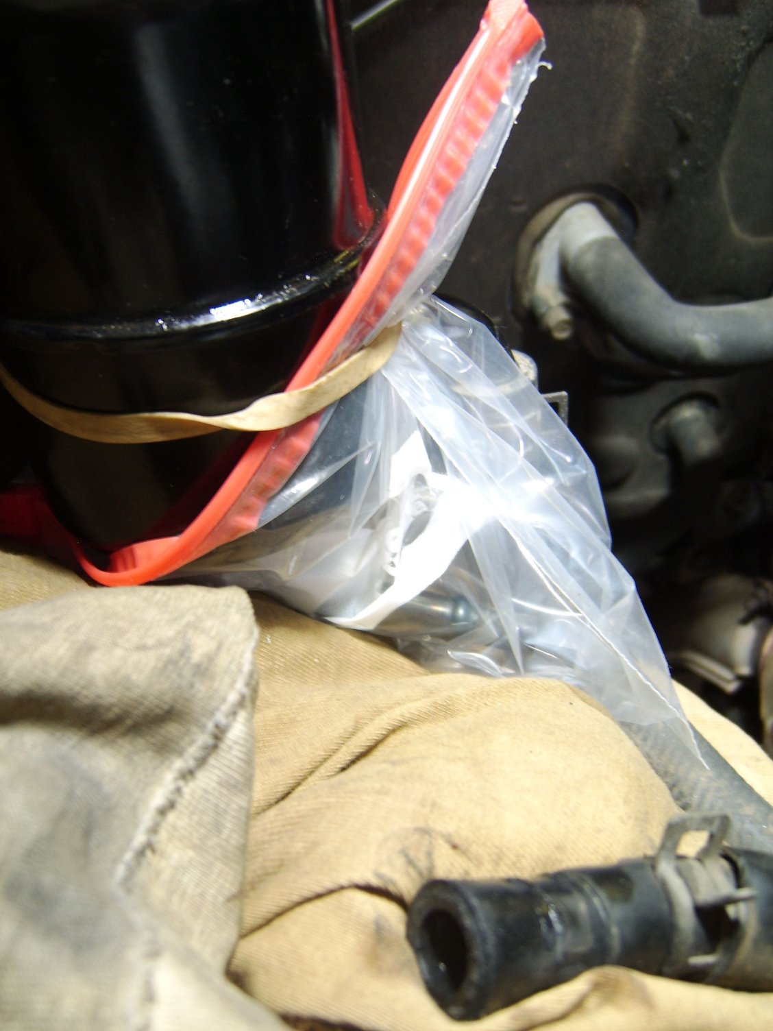

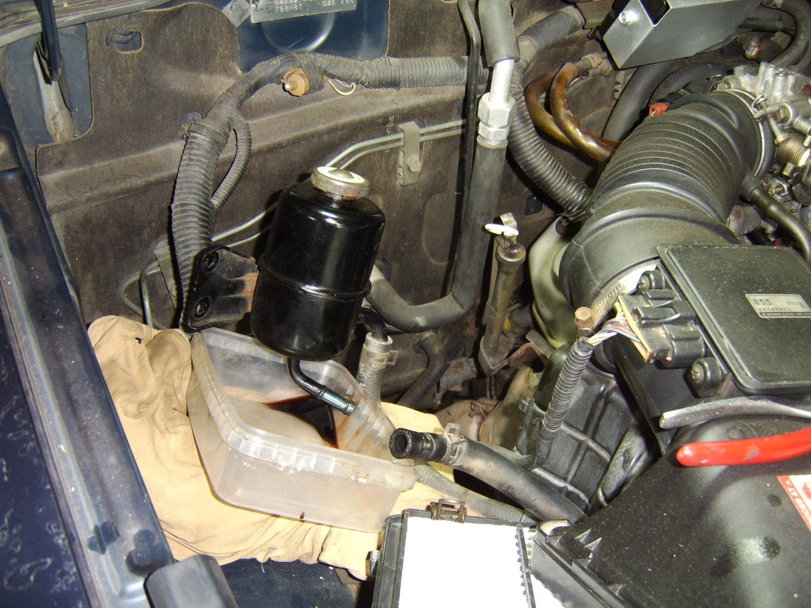

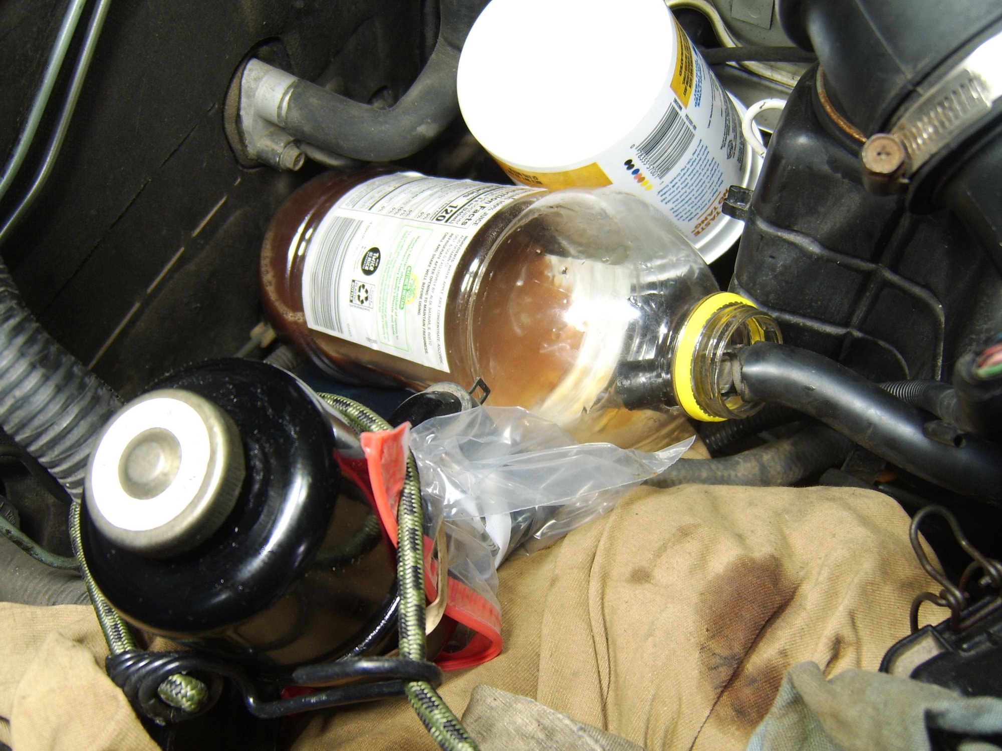

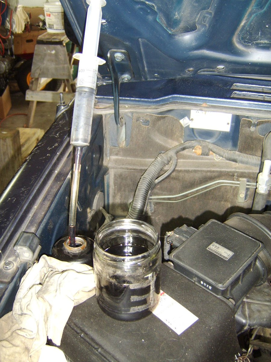

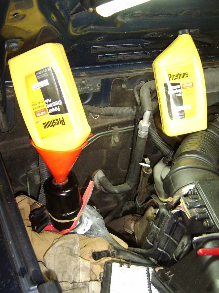

Howdy pilgrim. Regarding changing the Power Steering Fluid, be sure what you know what the mechanic is offering......Is he just getting a syringe and sucking out what is in the resevoir, and then re-filling with fresh? That does almost no good for the power steering system. I will show a few pics here of how you should change the fluid so that you are dumping out ALL the old fluid from the lines, the power steering pump, and the steering box.....and its something you can do at home if you want to save some bucks and ensure that it is done right.
These pics are from my 94 Montero. First I use a syringe to suck out what fluid is in the resevoir.
Pretty dark and dirty fluid for sure. I like these power steering reservoirs which has a removable filter/screen tube that can be pulled out and cleaned:
You can see the dark particles of dirt trapped on the filter:
I then unbolt the Resevoir and let what remains drain into a container.
I then cork-off the Return nipple of the resevoir with whatever you can find. It just needs to be plugged up good enough to not leak as you are adding fluid to the system, and it is being drawn down into the pump, lines, and steering box. I think I had a couple sizes of Vacuum Hose Stoppers, and one fit pretty snugly:
Then fill up the Resevoir with fresh fluid:
I put a plastic bag around the Resevoir bottom just in case that plug came out and it leaked some....but it turned out unnecessary:
Then bungee cord the Resevoir so it does not flop down and mess up the process. Also, place a jug with the Return Line going into it so you will capture all the foul fluid. At this point you can try turning the steering wheel from the 12:00 position all the way in one direction. Stop, and do not turn the steering wheel back until you go and refill the Resevoir. You DO NOT want to get air in the system which will happen if you turn the wheel too much, and it draws all the fluid from the resevoir. Thus, it would be good to have another person to fill the resevoir as you are turning the wheel. In some models you can do this without the engine running, but for my Montero it required that I start the engine and then turn the steering wheel.

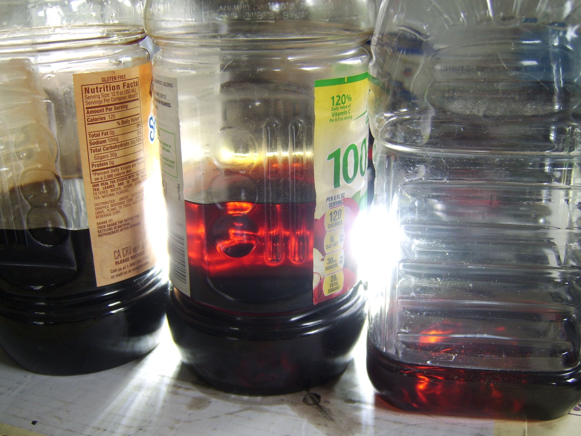

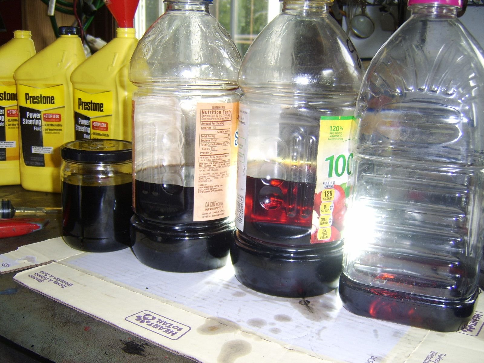

Note: What you see in the Jug above is the cleaner colored fluid that was coming out toward the end of the procedure. Here are the Jugs that I used in the process.....from left to right, you will notice that they go from Midnight Black to Nappa Valley Pink Zinfadel as the fluid gets cleaner and cleaner looking: If you can afford to keep adding the expensive fluid (now $8 can), then you can continue the process and eventually come out with a clear White Zinfandel tone.
The big tip is that you DO NOT want to turn the steering wheel too far and draw in air into the system. Might be best to only turn the wheel about half way in one direction, and then add more fluid, and then keep repeating until you are done.
Hope this helps.
