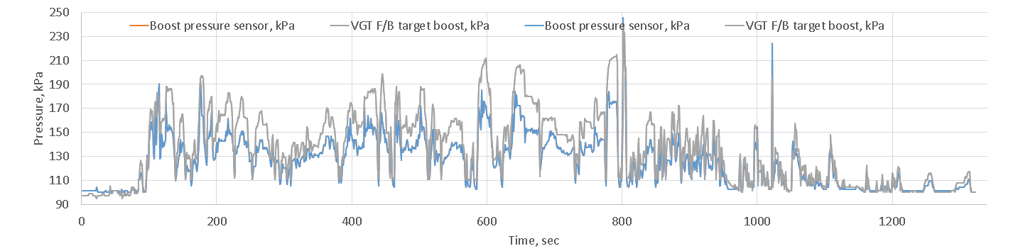

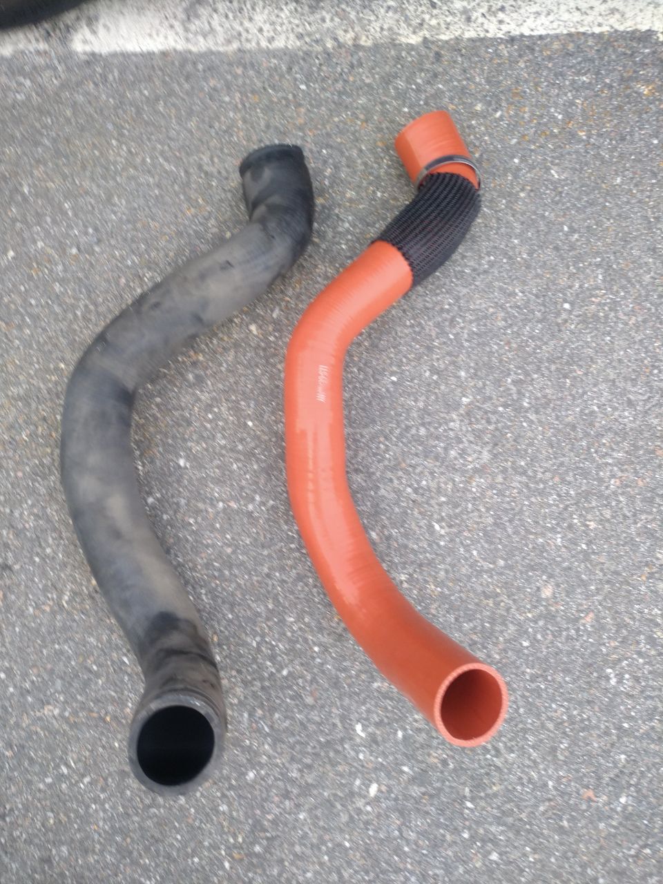

Most likely you have a loss of air pressure. Check all pipes after the turbo and intercooler for leak/damages. In my case a rubber pipe after the intercooler broke twice. At the end I bought a silicon pipe for €80. It might be tricky to find the leak. If you have MUT-3 or any other tool capable of looking at the target and actual boost pressures, then use it to check. In the attached plot you can see how target pressure was way higher than the actual one measured by builtin sensor.
