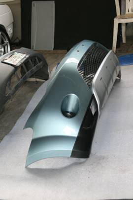

In 10 minutes it was removed
Old Dec 30, 2008 | 06:15 PM
mitsupartsman.com's Avatar
Joined: Aug 2008
Posts: 391
Default RE: Should I be pissed at my dealer or what?
now that was fast...maybe we should run a road school for mitsu techs...lol
