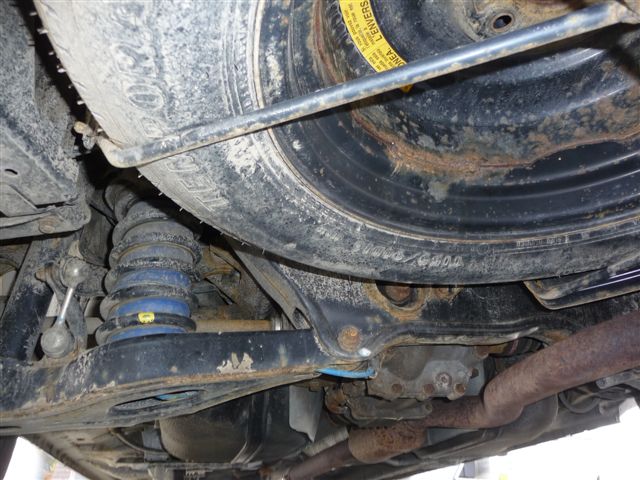

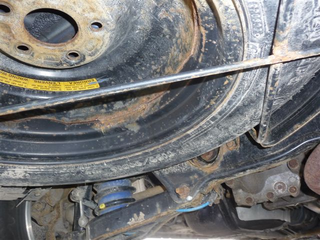

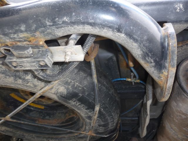

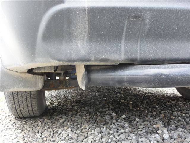

Hi !
I changed my Outlander 2007 for a 2010 (LS Canadian model)
Last summer, i had installed a kit from Firestone (coil rite)
On my outlander 2007, the rear suspension was to low when i tow my RV.
The kit works great.
I ask Firestone, if i can install the kit on my new 2010.
Firestone told me that no kit is avalaible for 2009 et 2010 outlander.
I check the dimension of the coil, it look identical.
the dealer can't confirm me that the coil are the same.
Today, my mechanic installed the kit on my 2010.
I can confirm that the kit work great
in canada i will pay around 150-160 $ + installation
i buy it when i was comping in Maine USA, i pay 90 $ (no installation)
my mechanic take near 2 hour to make the job right
unlike what you can see and read on the instruction
you can't install it without take off some piece (believe me i try it)
you have to take off the coil to put the bag
i don't forget protect the hose with a rubber hose
when i don't use it, i put 5 lbs ans around 15-20 lbs when i tow my rv
i put a T connector to make a jonction with 2 air line (1 from the right, 1 from the left)
after the T connector i have only 1 hose to fill air
Some pictures of my installation on my outlander 2007
presently, i did't take picture yet on my outlander 2010
When i drive with my camping trailer (Aliner 2009 expedition, 2300 lbs with nothing)
the rear is not saggy and it's more easy to drive
because i don't feel the trailer pull the outlander back
and when i drive on road with bumps the ride is great
i put 15 lbs in the air suspension, it's enough
Attached Thumbnails tow with weight distribution bar-p1020019.jpg   tow with weight distribution bar-p1020020.jpg   tow with weight distribution bar-p1020025.jpg   tow with weight distribution bar-p1020026.jpg
