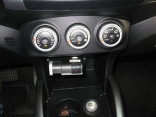

I pick the trailer up in three weeks in New Hampshire and driving it back to Nova Scotia (1,100km) and I will come back and let everyone know how well it tows at max capacity. I will also get some pics up of the awesome install on the brake control and 7 pin.
Attached Thumbnails Towing 3,500 lb Trailer, my experiance.-img_4515.jpg   Towing 3,500 lb Trailer, my experiance.-img_4516.jpg

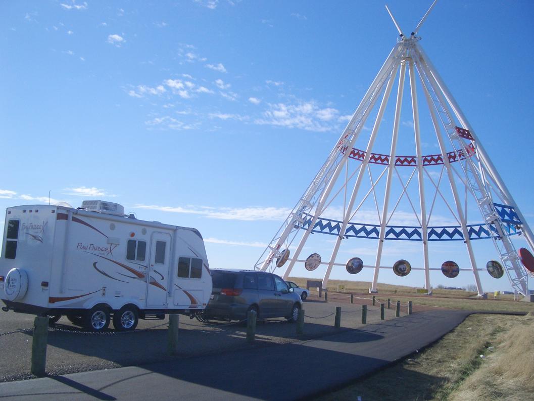

I haven't tried towing my current trailer with the outlander, but i do tow it with our 2005 Sienna, so I've got a bit of experience with large(compared to tow vehicle) trailers.

I had a Curt brake controller installed and a Eaz Lift 550 pound equalizer hitch so I am confident I have a good set up for towing.

sounds like all you need is to adjust the WDH to match the trailer when you get there and you're off. The giant teepee is actually in Medicine Hat, Alberta. That is where we bought the funfinder last year. I have visited Halifax though and loved the place. Spent 2 weeks working just across the Canso causeway in Port Hawkesbury. Did a lovely tour around and had a quick peek in at the Glenora Distillery. Lots of great memories.
LOL, I meant you have had to find the right set up for a small tv and full size tt. I have actually been to Medicine Hat and saw the giant TP. I was on my way to BC. It really is impressive.

The van actually makes a great tow vehicle. Long wheelbase and low to the ground. With airbags and the WDH keeping things in check, I can tow that 4000lb trailer through the Rockies with ease. The engine and transmission are tough.
