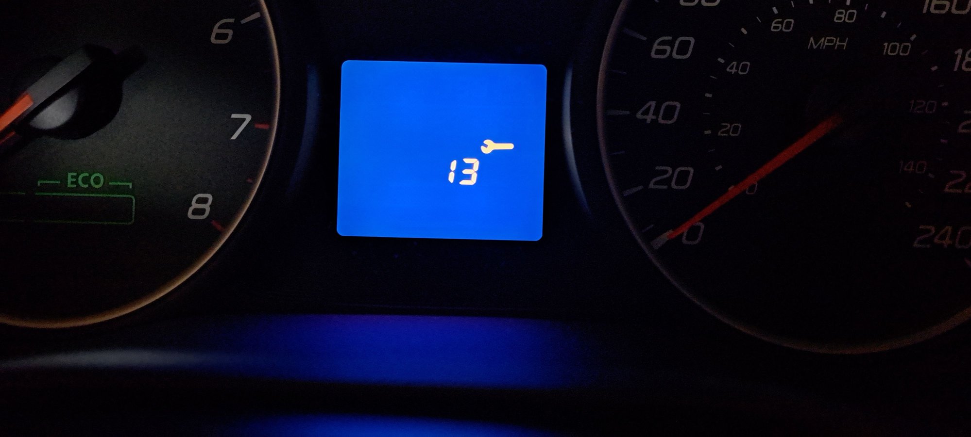

I"ve got a 2014 Outlander 3.0 V6
when ignition is off I see number 13 with a wrench icon. Anybody knows what it means and how to clear it?
Thanks
Neil

It means 13 months till your next service. When you have a service they should set it to 12 months or xx thousand miles/kms

What happens if you press dash board control button?
Never seen that before, looks like a BSOD.
I recommend to acan for errors via obd2.

Its a service indicator. Not a fault code.

Thank you for your replies. Glad to know it's nothing to worry about.
When I long press the contol button, it starts blinking then I let go of the button and press again it just stops blinking. No option to clear.
I scanned it with OBD2, no dtc as well.

you will need a bi-directional scan tool capable of resetting the service indicator to reset it correctly.
