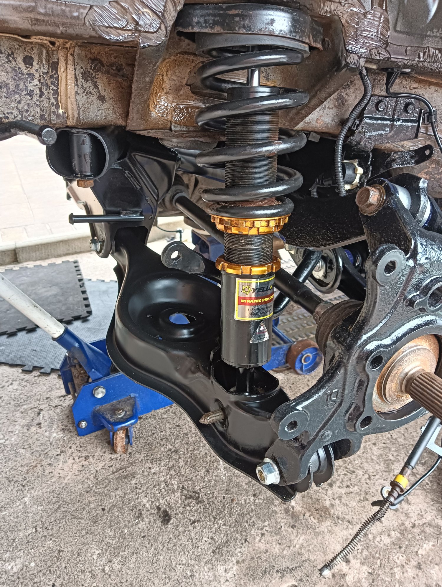

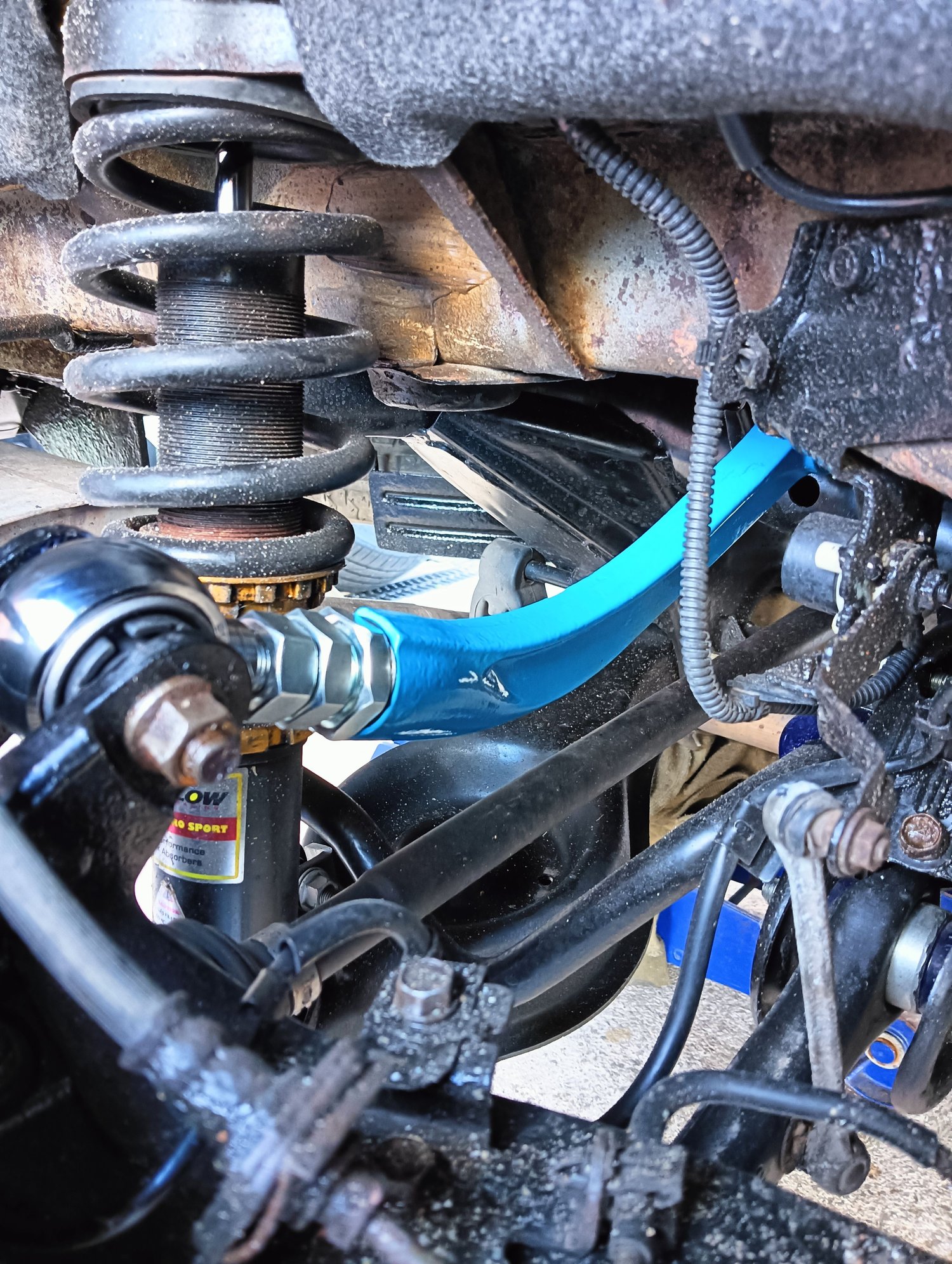

Hello, as we know there is no camber adjustment on the rear of the Outlander.
Which is a big problem if you have fitted coil overs.

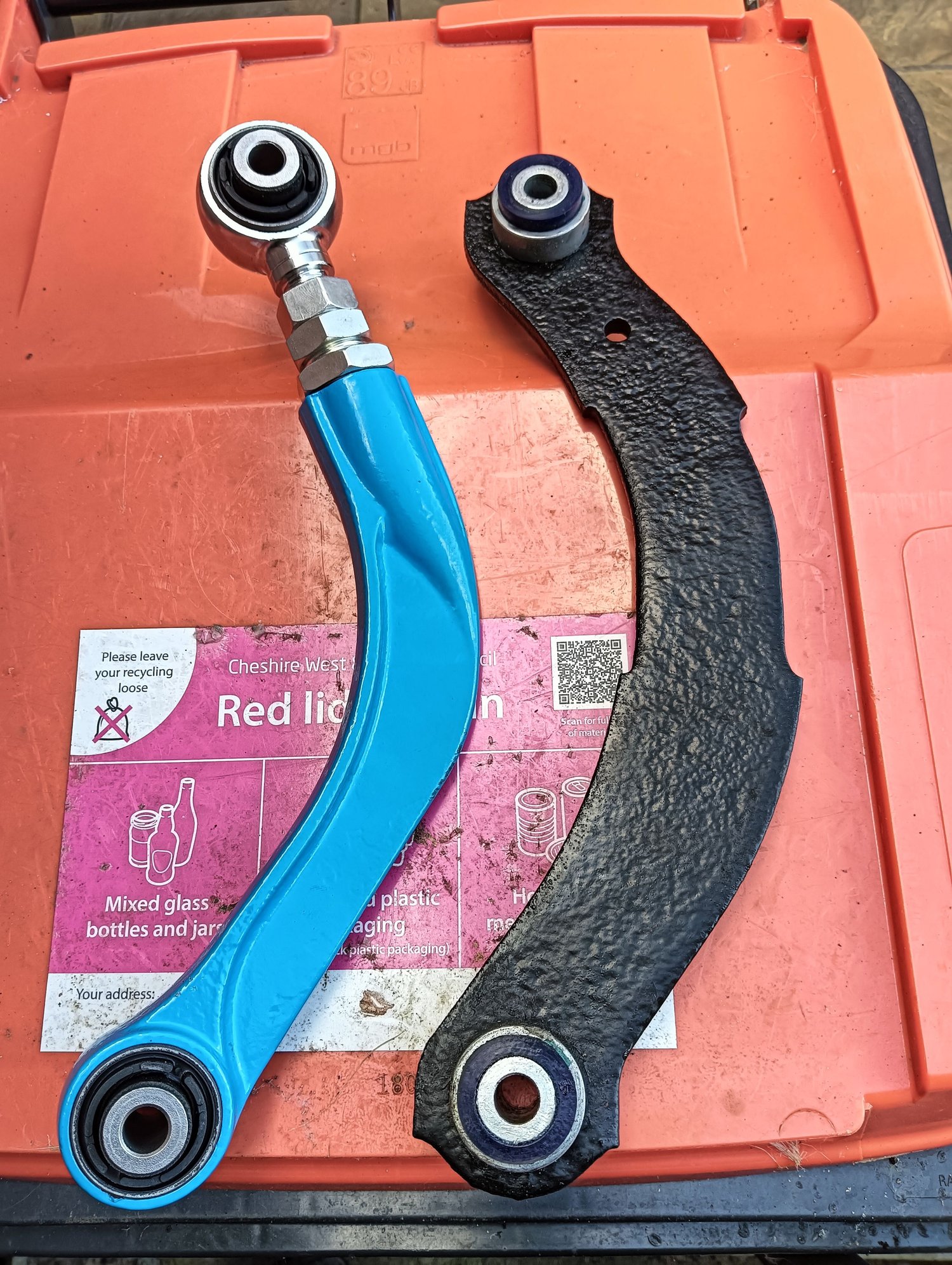

I found a set of adjustable rear upper control arms. They are very good quality and sorted my problem out.

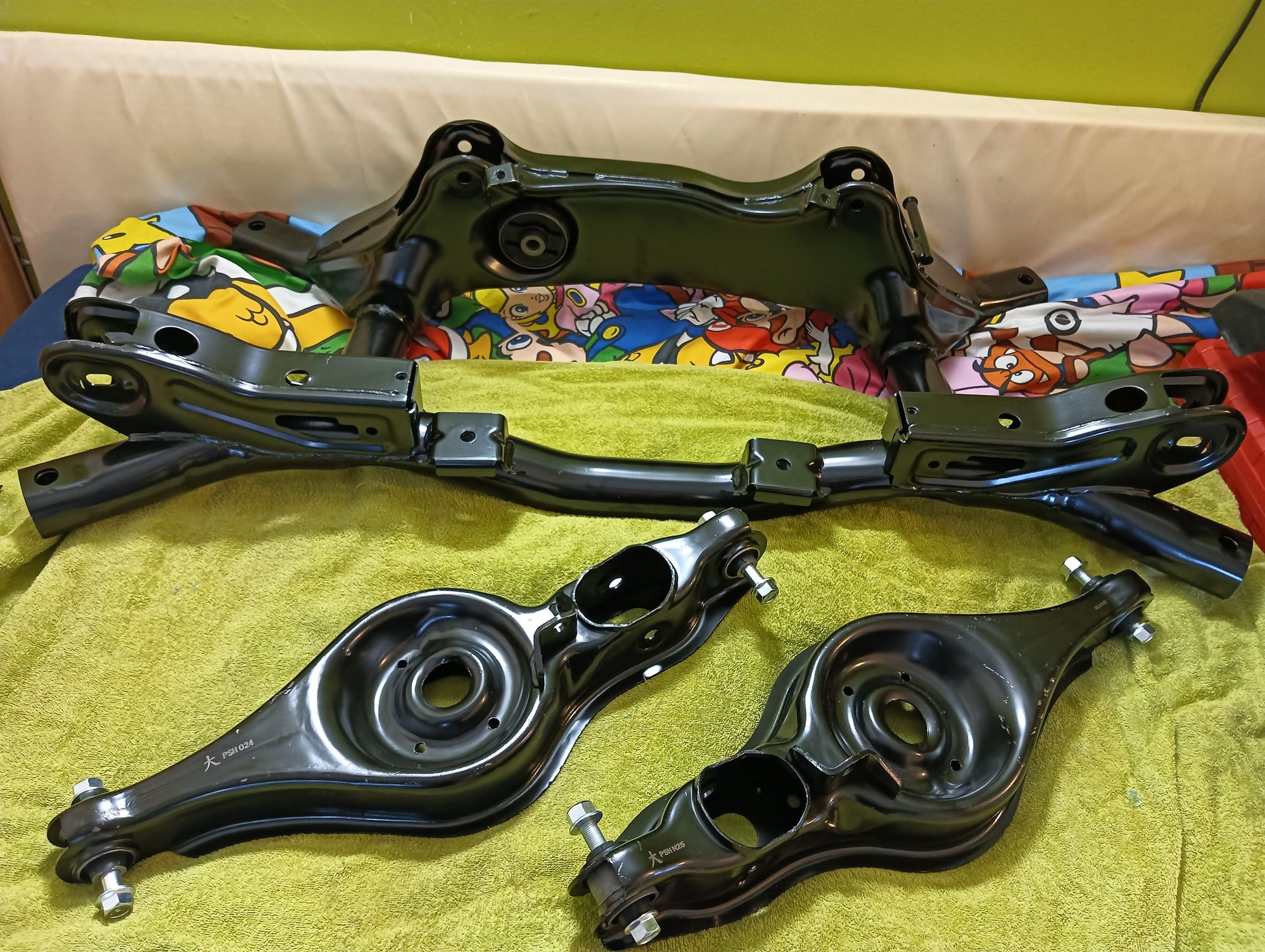

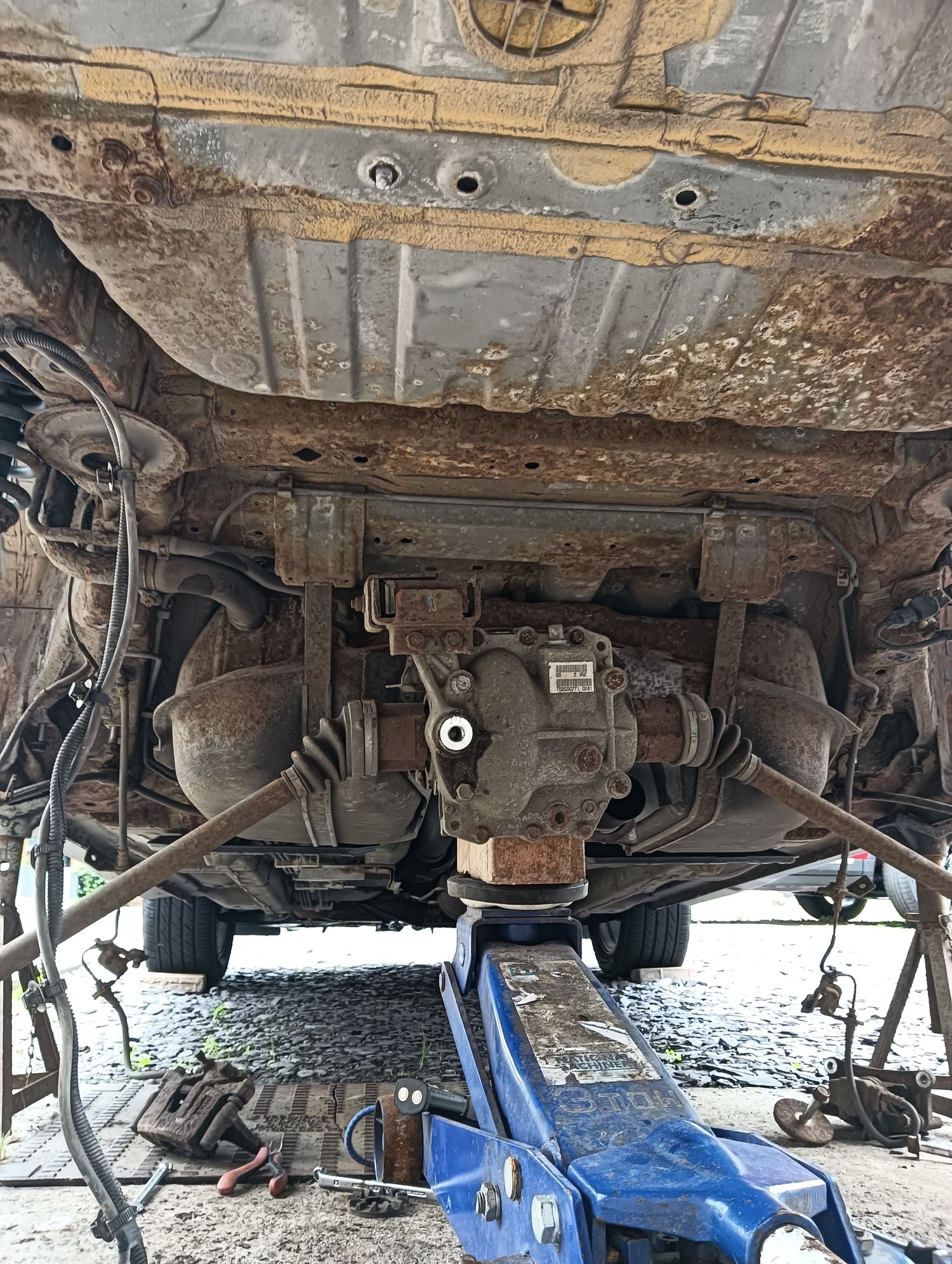

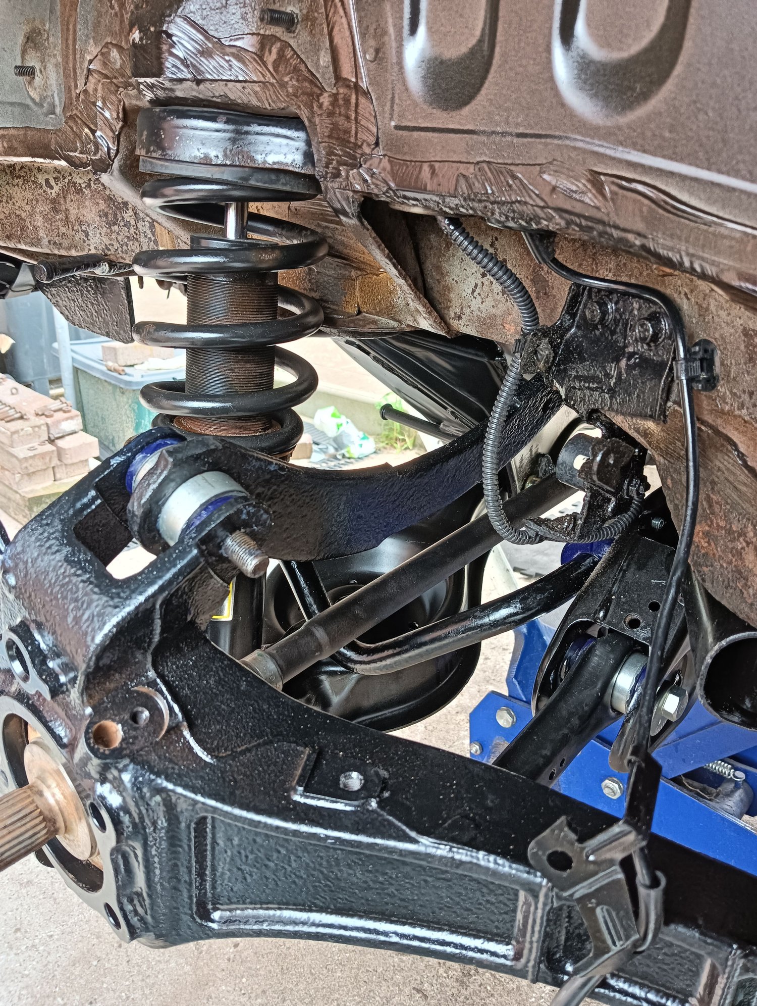

I also fitted new rear subframe, new lower control arms, the other arms where blasted and powder coated.
Fitted new Power Flex poly bushes as well.
