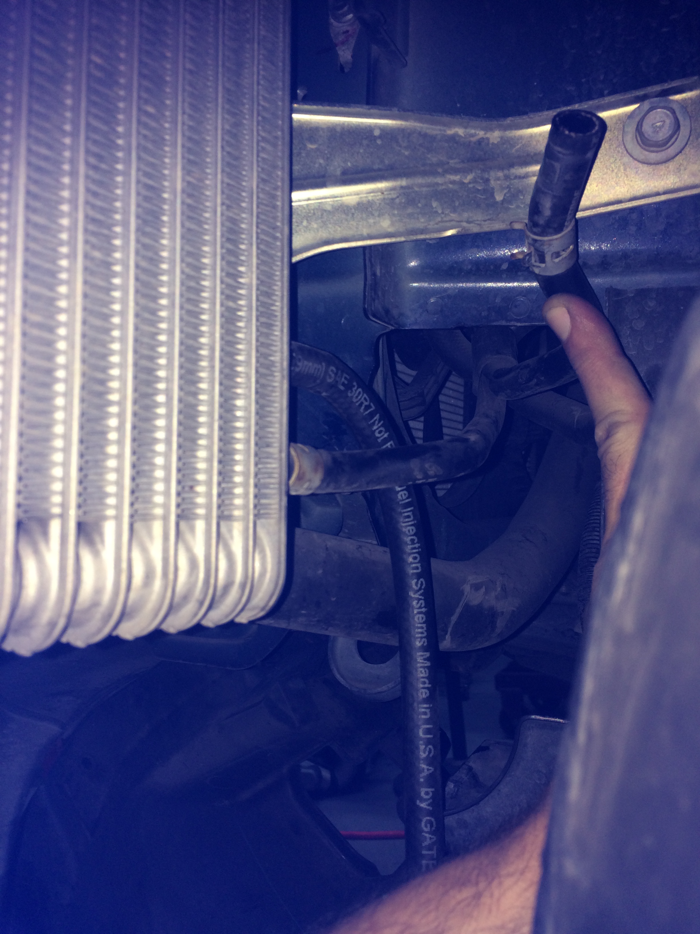

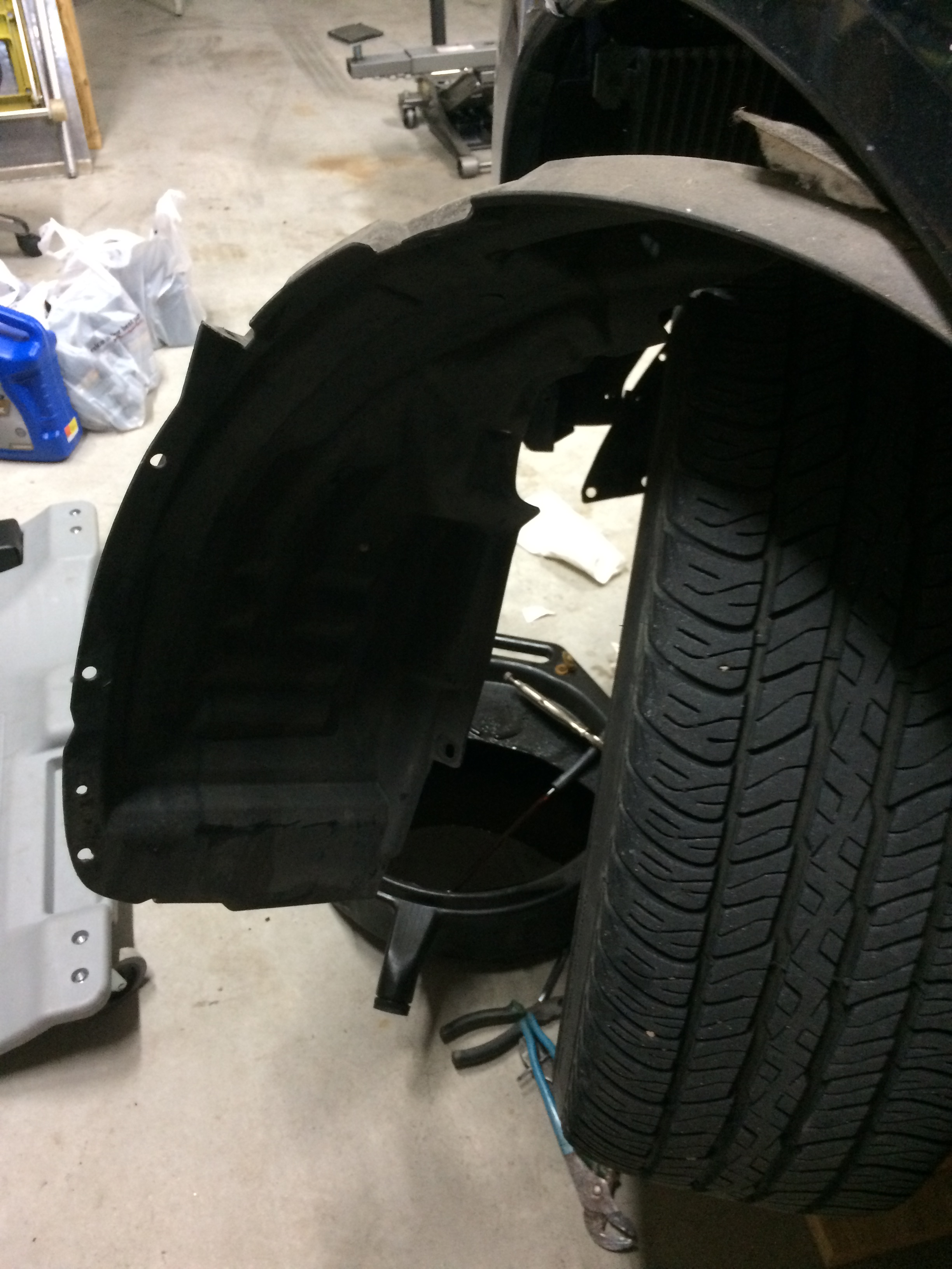

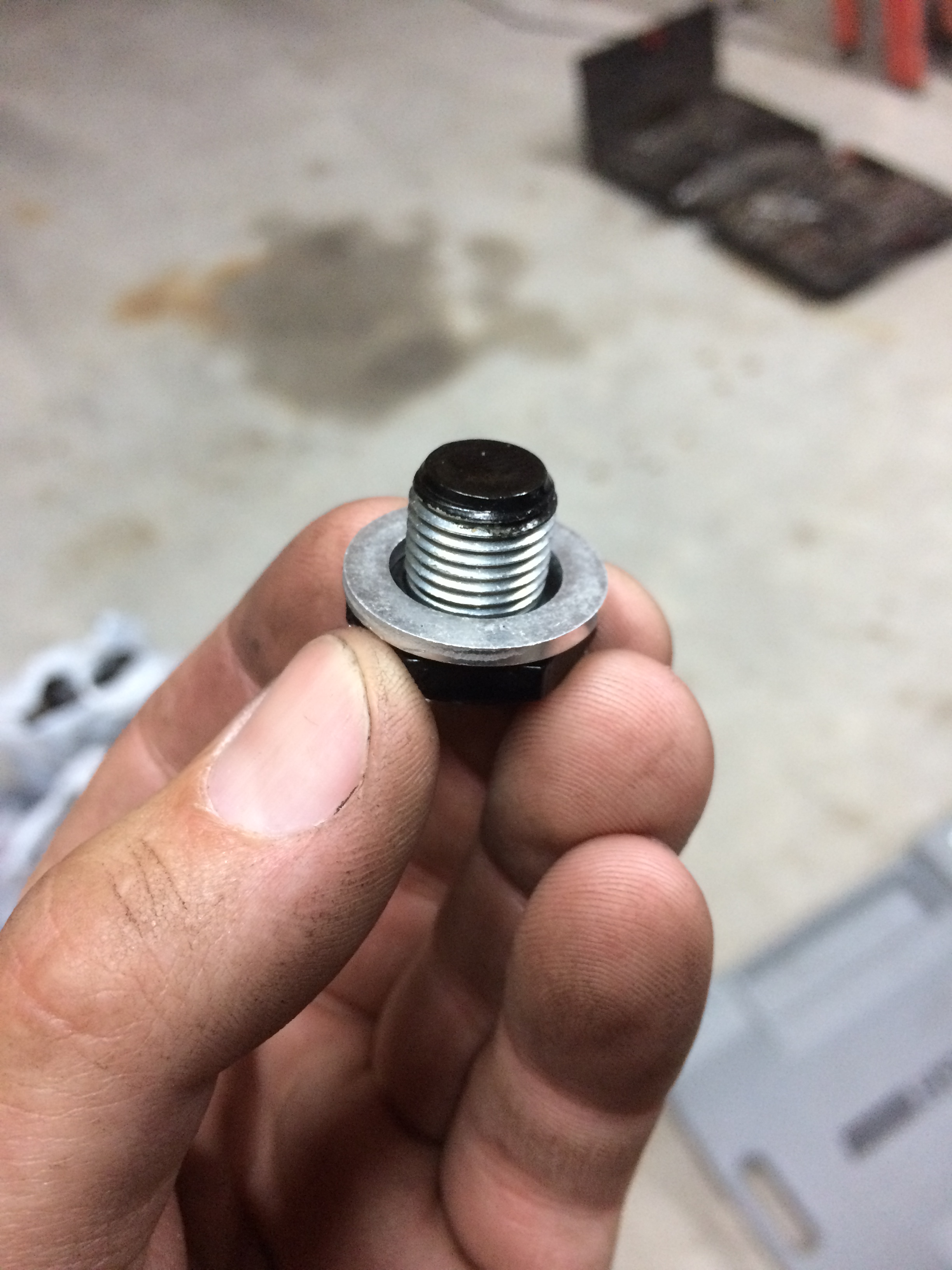

Last night, with the car at 40K miles and due for an oil change (I service my vehicles every 5K miles), I added a CVT flush to the agenda. I followed the service procedure someone posted from a manual (Thank you!) where you drain the fluid from the cooler's outlet. Reading it, it sounds lengthy and complicated but it all went very well and I didn't spill a drop. Attached are pics to document how I did it. First pic is of the cooler as accessed by pulling back the inner fender liner. I have the upper (return) hose removed from the cooler and a 2' piece of scrap hose pushed over the cooler's outlet nipple. I routed the hoe to my drain pan and lightly clamped locking pliers on the hose to hold it in place. Second pic is my view from the open driver's door area. Third pic is a close-up of the fluid being pumped out while the engine idles. Fourth pic is the pan draining and how I jacked up the rear of the car to level it so more of the fluid would drain from the pan. Fifth pic is the gasket I used on the drain plug. I didn't get a new OEM plug gasket, but I have a bag of aluminum crush washers left over from an Accord I used to have so I used one of those. I also used one on the engine oil drain plug for good measure. Following the remainder of the CVT service outline, I added about 5.5 quarts through the filler tube and idled the engine again until the fluid coming from the hose went from dark amber to dark red then about 15 seconds longer to ensure the old fluid was well-flushed. I put everything back together and topped off the trans fluid. I bought 10 quarts and have about 1.5 quarts left. I'll use that to replace any that may be spilled when I replace the trans fluid filter later. By the way, I used Castrol Transmax CVT. I got tired of researching if this was a suitable replacement or not and read plenty of "I've been running it with no problems" posts and Castrol's MSDS says it's compatible (for what that's worth). Plus, it was on sale for $5/quart at Advance.
