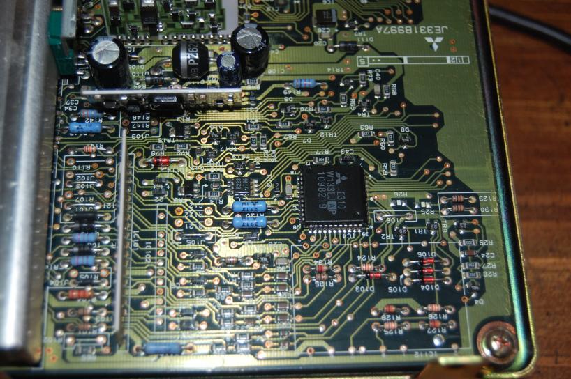

Sounds good, post pics if you can.

Ok! I pulled it out, (Kinda like pulling teeth) took it apart smelled it and did not smell nothing, did not see any capistor's leaking nor swelled. Cleaned all the battery post, cable, disconnected the ground from firewall cleaned it put it back.hooked everthing back up and switched it back on. The "Check Engine Light" stayed on about 30 sec's and went out. switched it off and back on several time's all the light would do is just blink when it was switched on. briefly then go out. is there any way to check them. here are some pic's cant tell much but here they are. Thank's for your support.
