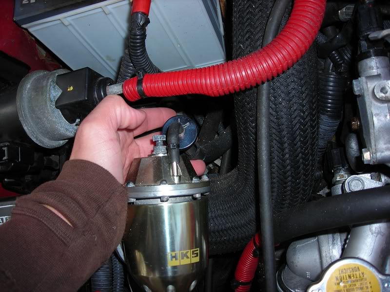

is that the hose you're talking about?

^^^^No thats the hose for the vaccum. On the other side of the bov does it look like this, can you see those 3 fins, or is there a tube coming out of there?

i can see the fins

then that means u are venting to the atmosphere... you need to get a recirc kit and recirculate it back into the intake.... the reason why this makes ur car run crappy is cause this BOV is after the MAF, so the ecu is reading a certain amount of air that will be going through the motor and compensates with the right amount of fuel. With the BOV venting to the atmosphere, you are shooting a bunch of that same air that the ecu is compensating for into the atmosphere. This will cause ur car to run rich with too much fuel and not enough air, and will make ur car run crappy. But like bestwiseguy suggested, the HKS for whatever reason is notorious for not working well with our DSM"s, so I would suggest selling it and buying a Greddy like he had mentioned... also having OD on all the time is no big deal... It's basically a 5th gear that ur car will switch into on the highway so it'll use less gas = better gas mileage... hope that all helps

you have 2 problems here. your car is using one of the worst BOVs for your car and its venting. you 'should' fix both. or at the very least but a recirc kit so its not vented
