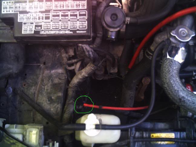

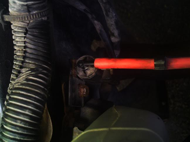

Here you can see the location of the BCS with the intake pipe removed circled in green

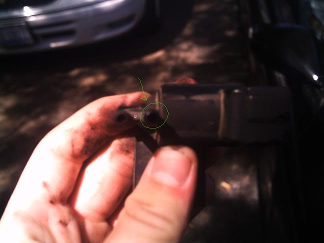

Here is a closeup of the BCS
1. Remove the BCS from the vacuum lines

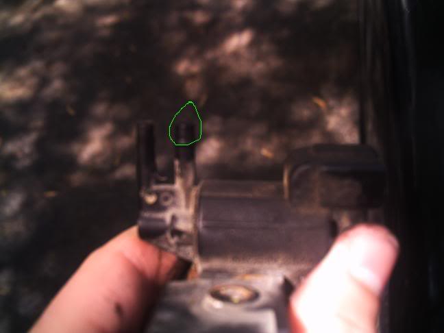

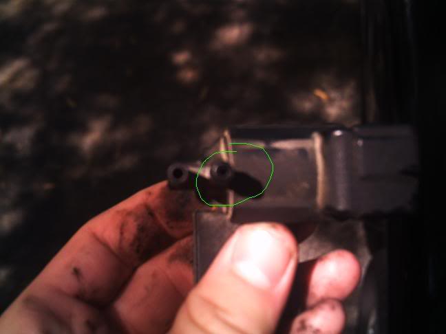

In these 2 pictures you can see the fitting in which the restrictor is located again circled in green

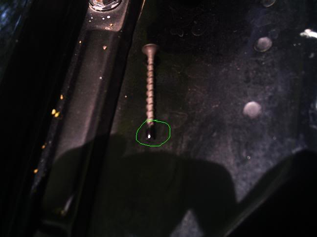

2. Now once you have the BCS out take a screw that can tighten inside the fitting and screw it slowely into the restrictor slightly then pull on it to remove it from the fitting.
Here is a picture of thefitting with the restrictor removed

Here is a picture of the restrictor on the end of the screw
3. Hook the BCS back up and you are done. You have just gained a few more HP for free
