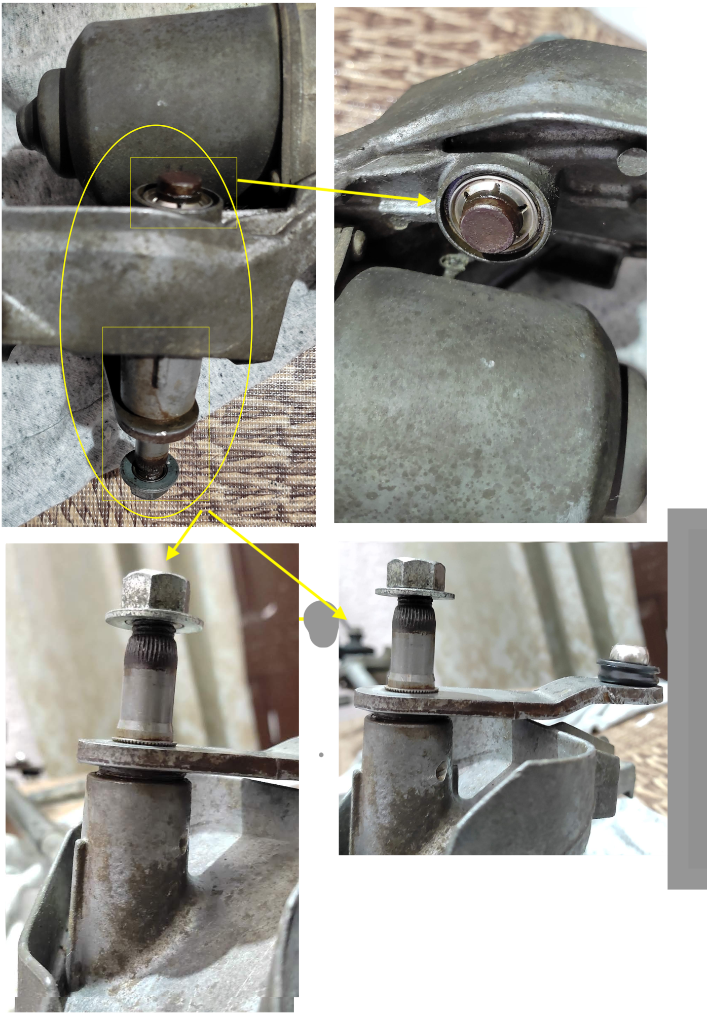

Hi, I need guidance in disassembling the wiper linkage spingle.
I am not sure where to start. I don't want to damage the part as the replacement is expensive.
Thanks

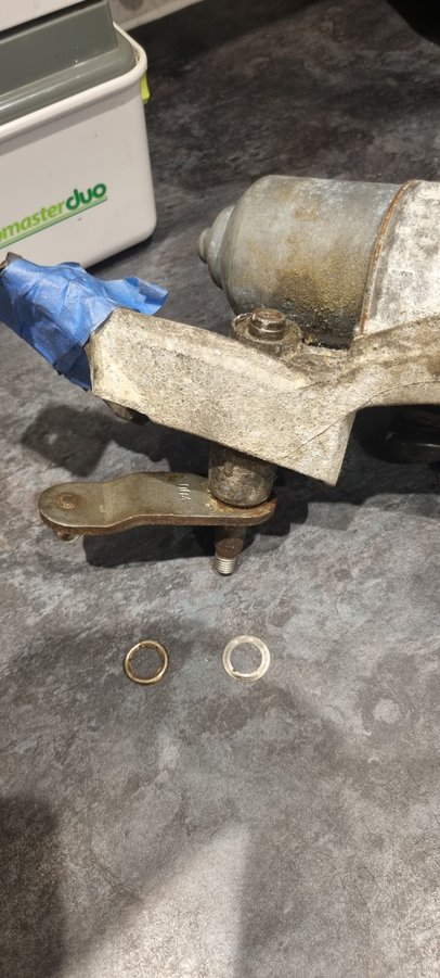

I've just removed mine by removing the securing nut ,starlock washer, and steel washer ,I then had to punch out the spindle as it had rust jacked inside the body, , try not to damage the starlock washer to much as you may need to reuse it unless you have replacements. .

Wow, thanks for letting me know. I was afraid to touch this part just because i have no replacement available for this. its too expensive here.
Could you pls share some pics of the same, that I could get a better idea.
Thanks
Old Jun 2, 2024 | 03:29 PM
cml181's Avatar
Joined: Jun 2020
Posts: 11
From: Dorset UK
Hope these help
