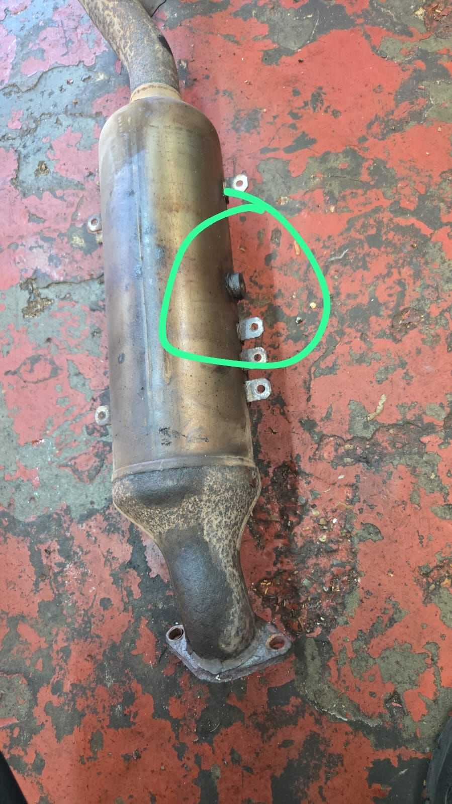

Hi All, I have a 2015 Outlander III 2.2 d.
Following issues with lack of power, smell and economy and found a split in the intercooler pipe. I replaced this and thought I'd remove and clean the EGR (for the smell, you never know...)
Problems remain and long story short it transpires the CAT had basically 'crumbled' inside which led to the DPF clogging - or so i'm told.

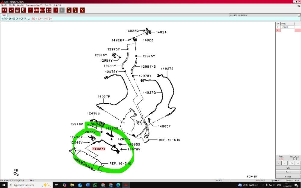

Had the DPF and CAT removed, cleaned DPF and got a CAT from the breakers. Now I am having problems sourcing a temperature sensor for the DPF. The OEM part is 1587A120 and when in stock retail for around £500. This on top of £350 for the CAT + £??? I owe the mechanic for removal, cleaning etc..
Has anyone had similar issues and is this the only part that will fit as it seems I'm still weeks away from one being available?
Thanks for reading 👍
