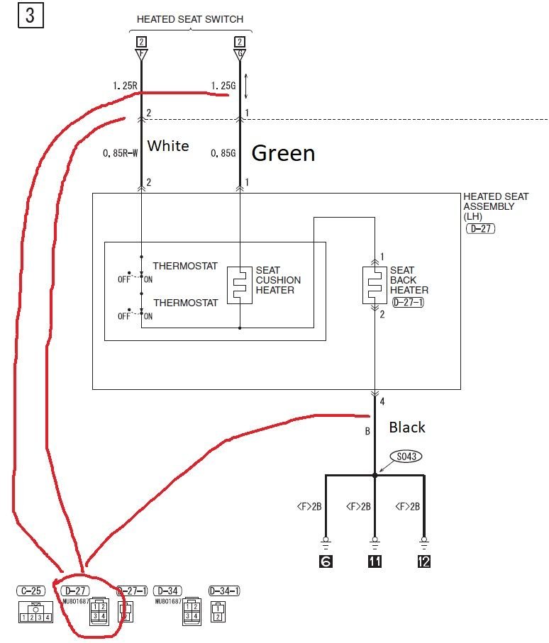

My car doesn't have heated seats!
I've identified the wires and believe that the seat is already equipped with the heater!
I do believe that the harness are there and just have to add the switch and the relay (as shown in the attached pictures)
I was unable to identify the switch PN as 8610a070 might be suitable for 2010-2017 but I'm ain't sure it will fit the 2018 model?
I'll appreciate any advice or previous experience
