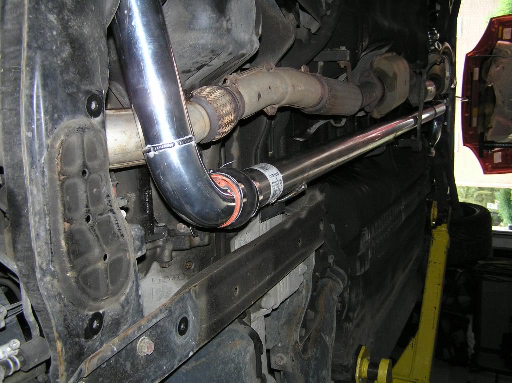

We DOUBLED the wheel horsepower of a stock SL by doing a custom rear mount turbo kit.

that is a frickin sweet setup! How much more expensive was it than doin the SL to VR-4 swap?

That single turbo set up is pretty cool. crazy but cool

theres more pics on my myspace, auto velocity, It ended up close to the same cost, there is a significant amount of work to do it right.
