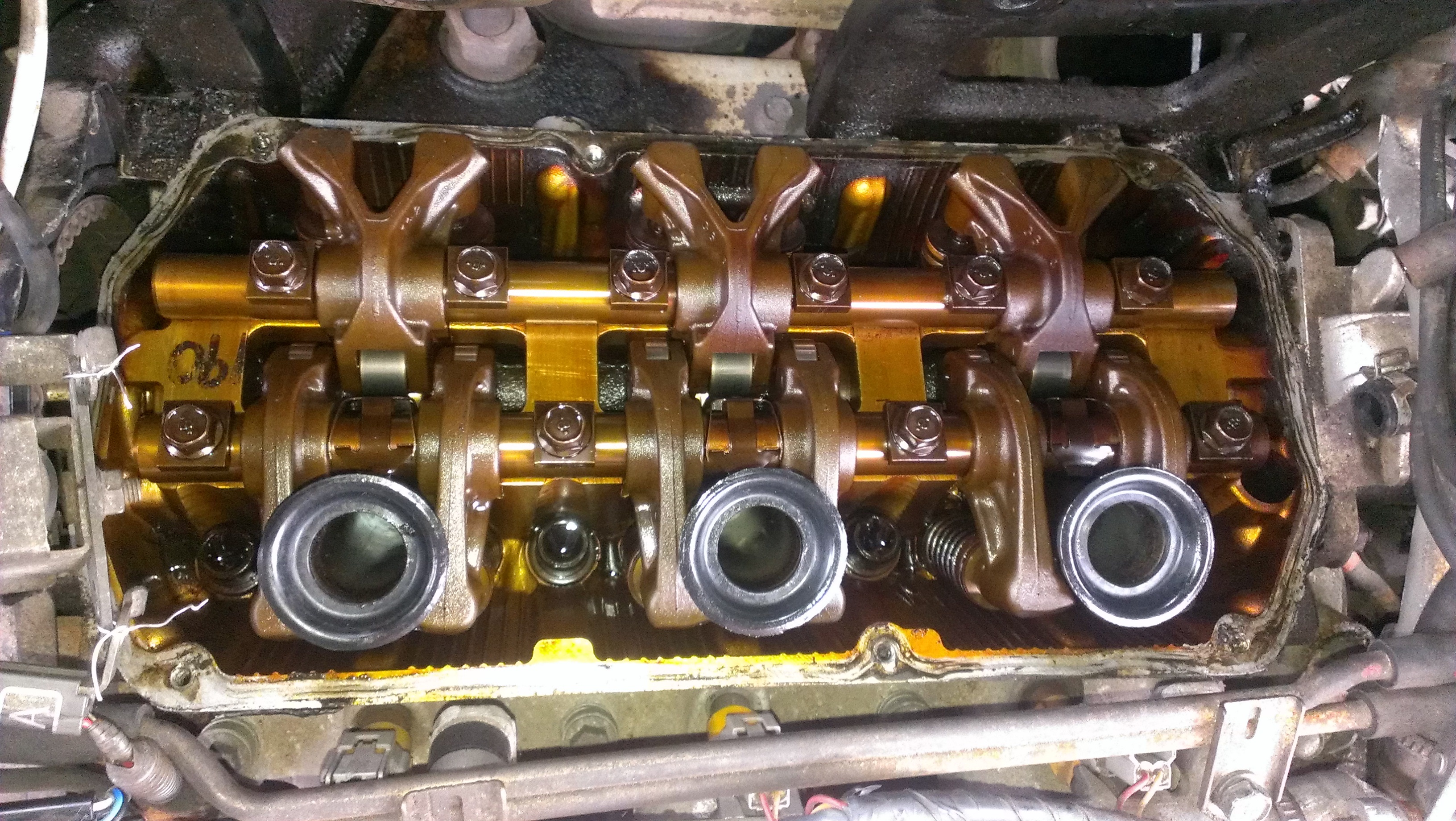

It is 3.5 SOHC. I opened valve cover again. And attach a picture here. Can you tell me where to locate two camshaft plugs so to replace both o-rings? I hate to work under the car. Really appreciate your help.

Ok, you have that engine. It looks like that is going to be a one hard to do. The two photos i dug up on the internet. I wish I had one to photograph. I hope this helps. I'm kinda shocked that nobody else piped up, well not really. I would also put black RTV on the o-rings on the back cam plugs, that will help. I hope that helps.
