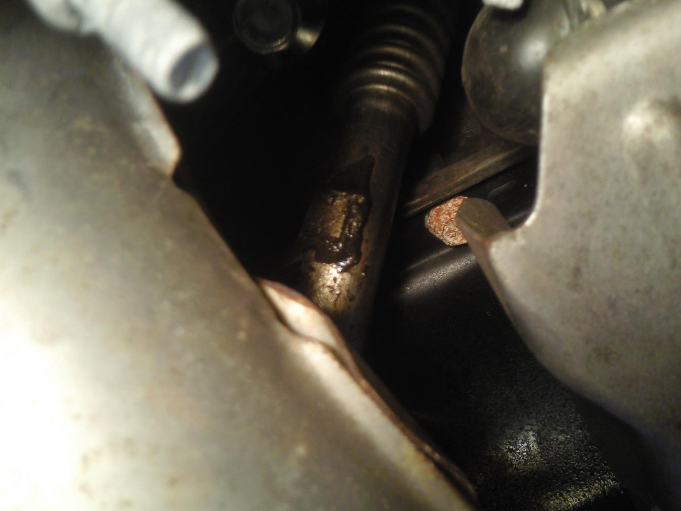

I lifted the car to see where the leak is coming from . It looks like the turbo return line itself and not the oil pan . it looks like its running down the oil pan and the oil pan plug. the car is stock and with no modds that i know . I 'm the second owner. just ordered the spark plugs for the misfire on cylinder 4 .I also notice that the service engine soon light goes on and off after a couple of miles.

Old Sep 10, 2009 | 07:37 PM
have the ECU scanned to see if there are any codes in it. Autozone will do it for free. But its probably just the random cylinder misfire code, if thats what you say you have happening
