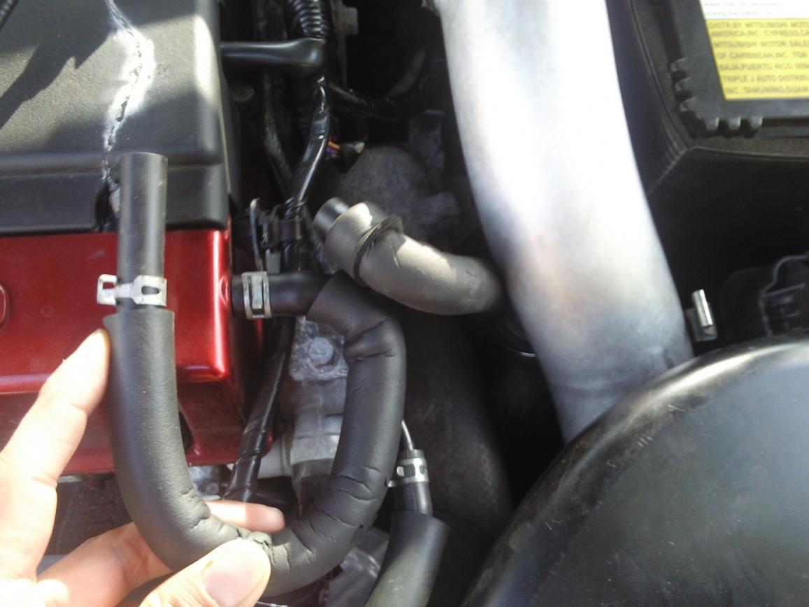

must the breather hose be Connected to the diverter before the air filter . having a p0172 code after i connected this hose so i disconnected again.
Old Sep 29, 2009 | 07:50 PM
on the stock intake setup yes. Or you can block off the hole on the intake tube and put a breather filter on the valve cover
