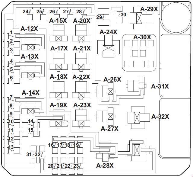

Yeah... I'm back. I've found that the transmission is too different internally to be ran by my 2011 electronics and I can't swap in all the 2016 electronics. So, I swapped in the original transmission. This cured one or two of the codes but I still had two others remaining. I then discovered that the harness is very different. The older trans ran off of 16 wires, the new one uses 8.
Anyway, I was in process of overcoming this (and hopefully the final) hurdle and I had a little accident. So, now I need a wiring diagram for a 2016 Outlander Sport ES. It's the smaller of the two plugs on the engine/trans harness that goes to the underhood fuse box. It has two rows of pin slots- 11 on top and 13 on the bottom. I believe it's the A-31X connector.
Anyone know where I can acquire this? AllData doesn't do Mitsubishi and I'm not sure if Mitchell truly has this info.
A-31X is the connecter pinout I need
