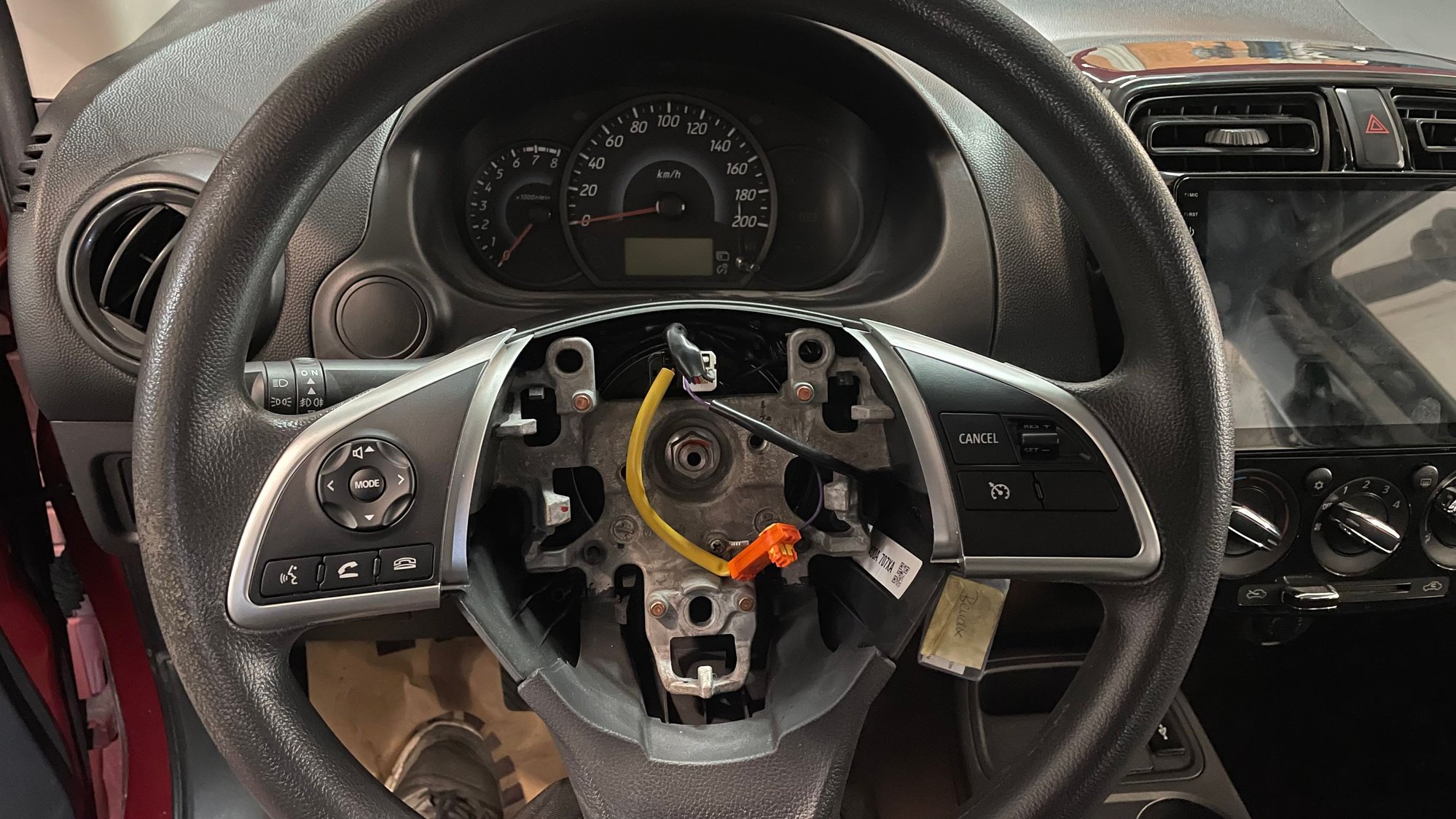

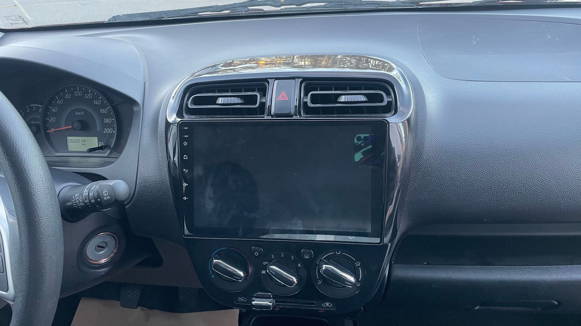

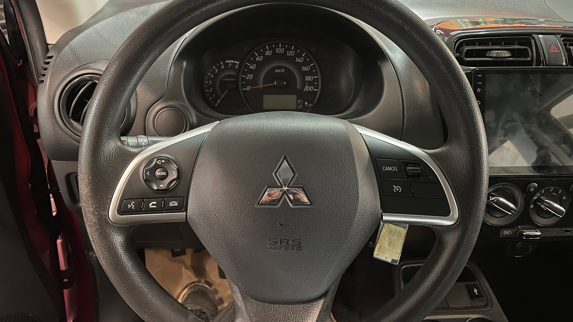

I have 2019 Mirage on which I installed additional OEM steering wheel stereo and cruise control commands which were plug n play and didn't require wire splicing along with 2 din android stereo but I can't get them to work with aftermarket nor with original stereo.
Cruise control doesn't work either.
Any tips ?

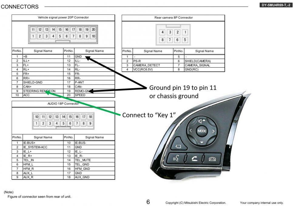

Wiring diagram I've tried but had no luck
