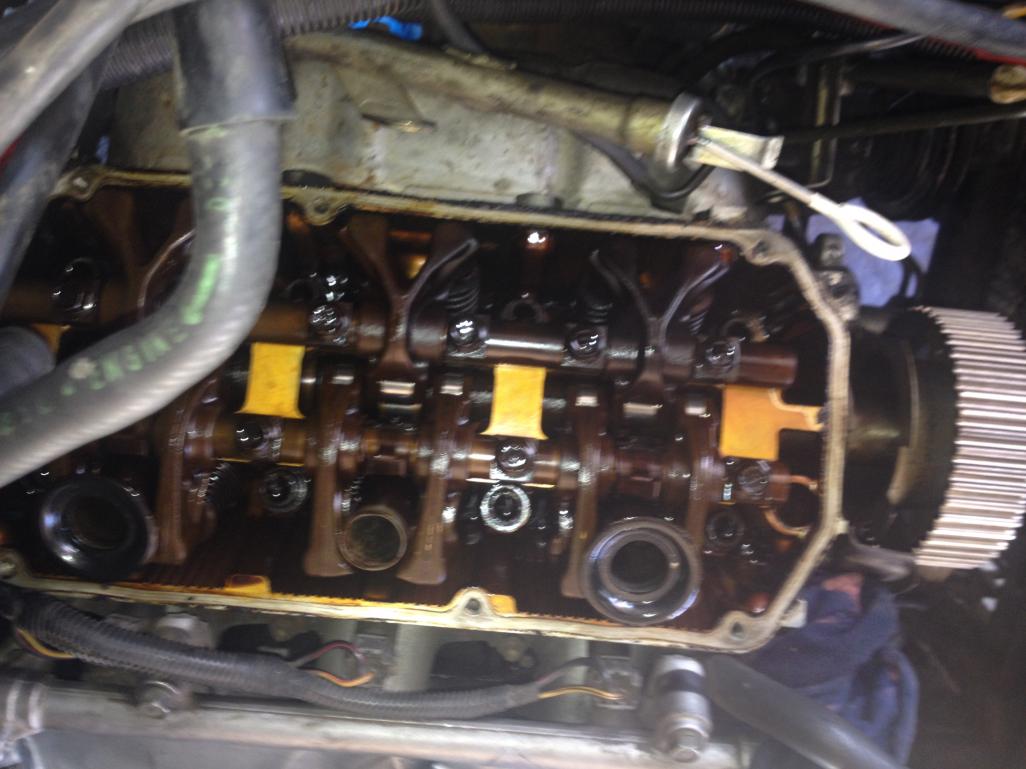

I purchased a 95 Montero LS 3.0 about two months ago from a local College girl, for camping, fishing, etc.. I knew nothing about the model honestly. I inspected it, at our local Ikea parking lot, liking what I had seen so far, 3rd Row seating, straight body, and I am partial to the boxy SUV. I noticed a few spots with fresh oil, but the entire Engine compartment was caked in one fluid, or another. I have never seen a rig with this level of neglect.The Mrs. liked it from the go, so I did too of course.
Picked it up for $1300, drove it home, Steering was very loose, but other than that it had a decent amount of power for a SUV in as much need of TLC as this one. I began the servicing, changed the oil, PCV valve disintegrated in my hand when i went to inspect it. I was downloading diagrams, and troubleshooting guides, as I could find them online. (No local auto Parts store here in Portland had the current Chilton for my rig, so I signed up with Aldata DIY instead. Spark Plugs ( which could have been original) were changed, plug wires, etc...roughly two weeks into owning it, I get a call at work from the Mrs. from the side of the freeway, telling me the Montero "Got Hot".

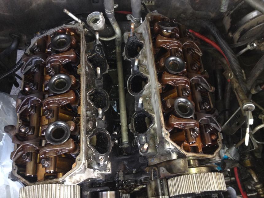

Running Horribly, billowing white smoke pouring out the rear, my fresh oil turned to milk chocolate...The bottom Radiator hose had popped off while she was doing 65-70MPH for , I have no clue how long. A mechanic friend comes over to help me assess the damage, Blown Head Gasket for sure, So I tear it down, ( BTW we have recently moved into a Townhouse a week prior, in a community that does not allow the hood open more than 30 minutes on the property)So I am pulling parts off, tossing them in a basket, and toting them into our still unfurnished Kitchen, which is getting a salvage yard smell/ feel, and the Mrs. is not happy about it. I have never been deeper into an engine, than a Valve Cover gasket replacement, but how tough could a new Head Gasket be?
I have included a few pics of my Early Mornings, and Late Nights for the past week and a half, Heads right off the block, headed to the machine shop, The head gasket kit I ordered off Ebay ( and was sent the 12 valve version in error instead of the 24) which I was happy about, after I saw the Fel-Pro Kit and the difference in quality. I was able to clean the heck out of darn near each and every part. Met this infamous Sludge face to face , a burnt Valve, a Cylinder that had a foreign object pass through it, and what that does to Aluminum. I can still smell the funk of the Intake Manifold like I just pulled it out. My first timing belt experience, and how ones O.C.D/ A.D.D is affected when someone explains what an Interference engine means... I believe I set the Belt, had everything put back together 3 times total, before I started second guessing myself, as to what Stroke had I set the #1 Piston at TDC...
This was the first forum that had come up on a google search, and I want to Thank You All for your posts, Diagrams, How-To's, Tweaks, Do's, Dont's, etc... you are all the reason I have gotten this far but here is where I am at: I have everything replaced, cleaned, Nearly Leak free, I fired it up last Saturday, let it idle for 10 minutes, while a crawled all over, inside, and under it looking for leaks, MIA sockets, etc.. Drove it around town for a few hours, checked the 4x4 on a dirt road nearby, which functioned as supposed to. Parked it, had a good nights sleep, woke late, wanted doughnuts, hopped in the NEW Montero, and it cranked, cranked, but wouldn't fire. I have checked Fuel, Spark, and compression. I have all three, and has on two occasions came very close to firing. I went back in Friday night to look at timing, and the Cams have not moved off the Mark, and am set at 5 degrees BTDC. I checked the coil Pack, resistance is within Spec. on all three. I have found 23 version of the Plug Order from various sources on the web. My questions are:
1. Any ideas on the No start, I apologize for the format, and length of this post, but I just let it flow.
2. The TRUE Spark plug order for a 1995 Montero LS 3.0l 24 Valve.
I do look forward to owning the truck for a long time, thanks for listening, and I am ready to try any suggestions you are willing to throw at me.
-Gary
Attached Thumbnails 1995 Montero LS 24 Valve...ummm...Adventure, and a few questions.-img_0955.jpg   1995 Montero LS 24 Valve...ummm...Adventure, and a few questions.-img_0958.jpg   1995 Montero LS 24 Valve...ummm...Adventure, and a few questions.-img_0814.jpg   1995 Montero LS 24 Valve...ummm...Adventure, and a few questions.-img_0754.jpg   1995 Montero LS 24 Valve...ummm...Adventure, and a few questions.-img_0927.jpg

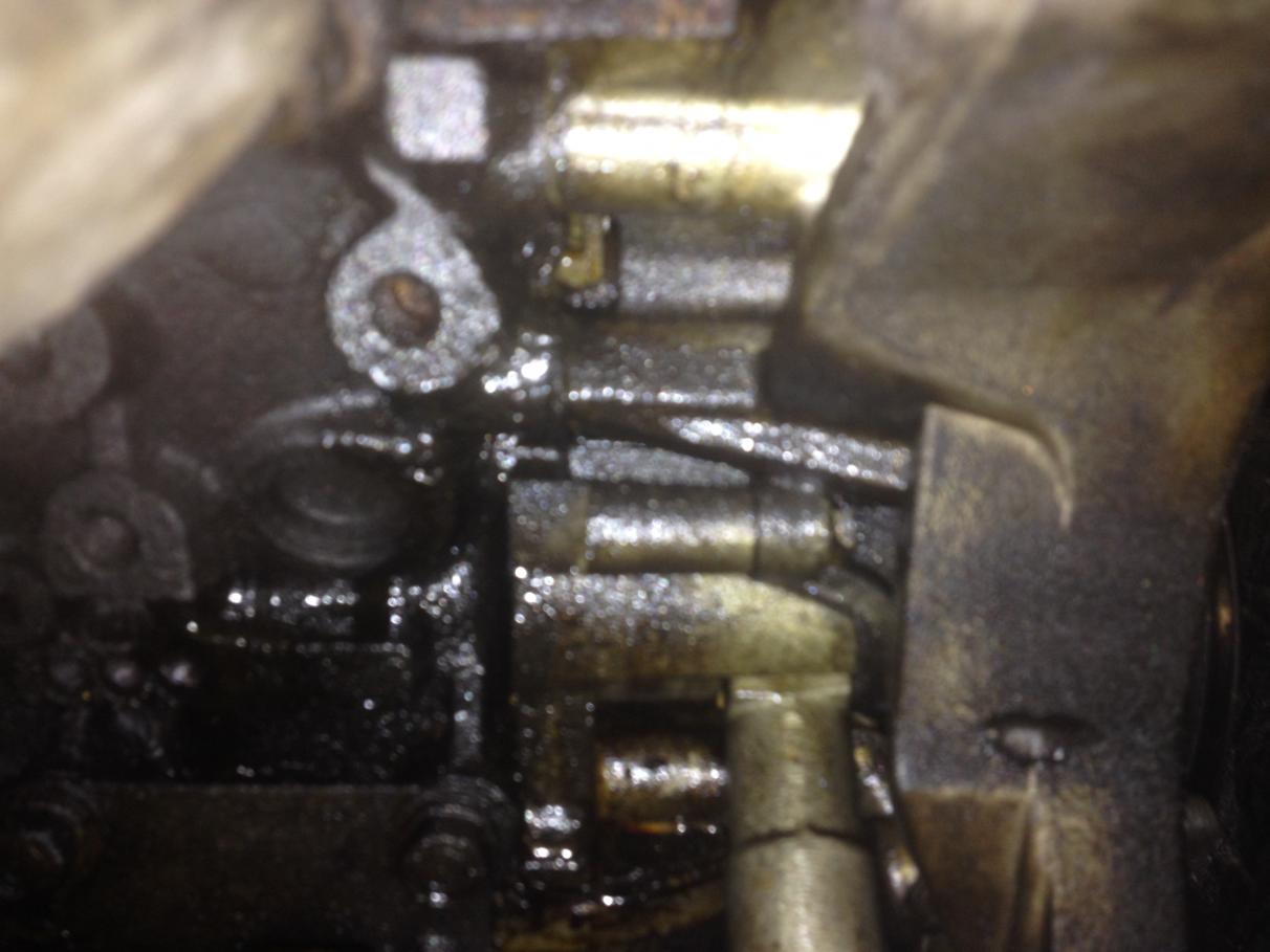

I believe I pinpointed my leak(s), Rear Passenger side Valve cover, when removed showed oil activity for a good 6" just out of eyesight. one of my Exhaust Manifold bolts was quite loose, I re-torqued after I replaced both valve cover gaskets(using a Touch of RTV in the four corners) after cleaning and decontaminating the perimeter.

Ok maybe not out of the woods on the leak. There is no oil coming down the side of the engine after I removed the Valve covers, cleaned, and re torqued them. now, but there is still a noticeable amount on the ground, and it shows on the dipstick. It looks like Oil Pan gaskets are in my near future, those are the only fresh oil spots I can see from underneath. I think I might try turning the bolts just a hair, and see if that makes a difference.
