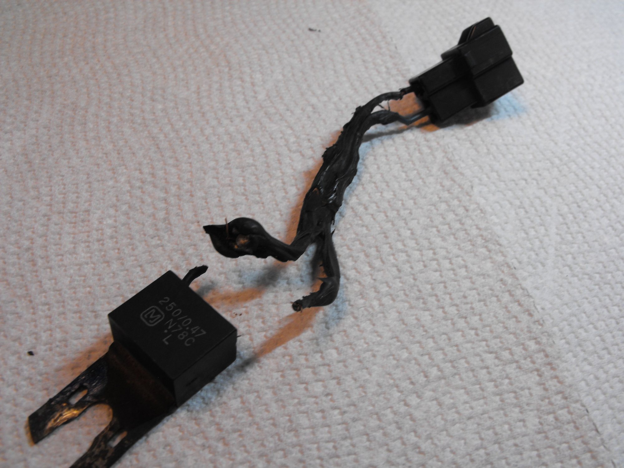

After getting the engine all back together, he has the "Crank-No Spark-No Start" issue. It ran fine before working on the engine. There is no spark coming out of the three coil paks, and a bizarre voltage of only about 6 volts going to the coil paks.
We finally noticed that the "flux capacitor", with a real name of "Ignition Capacitor" had worn wires coming out of it which had finally broken away. Here is a picture:
The wires had broken away, and we believe this is why the coil paks are not producing spark.

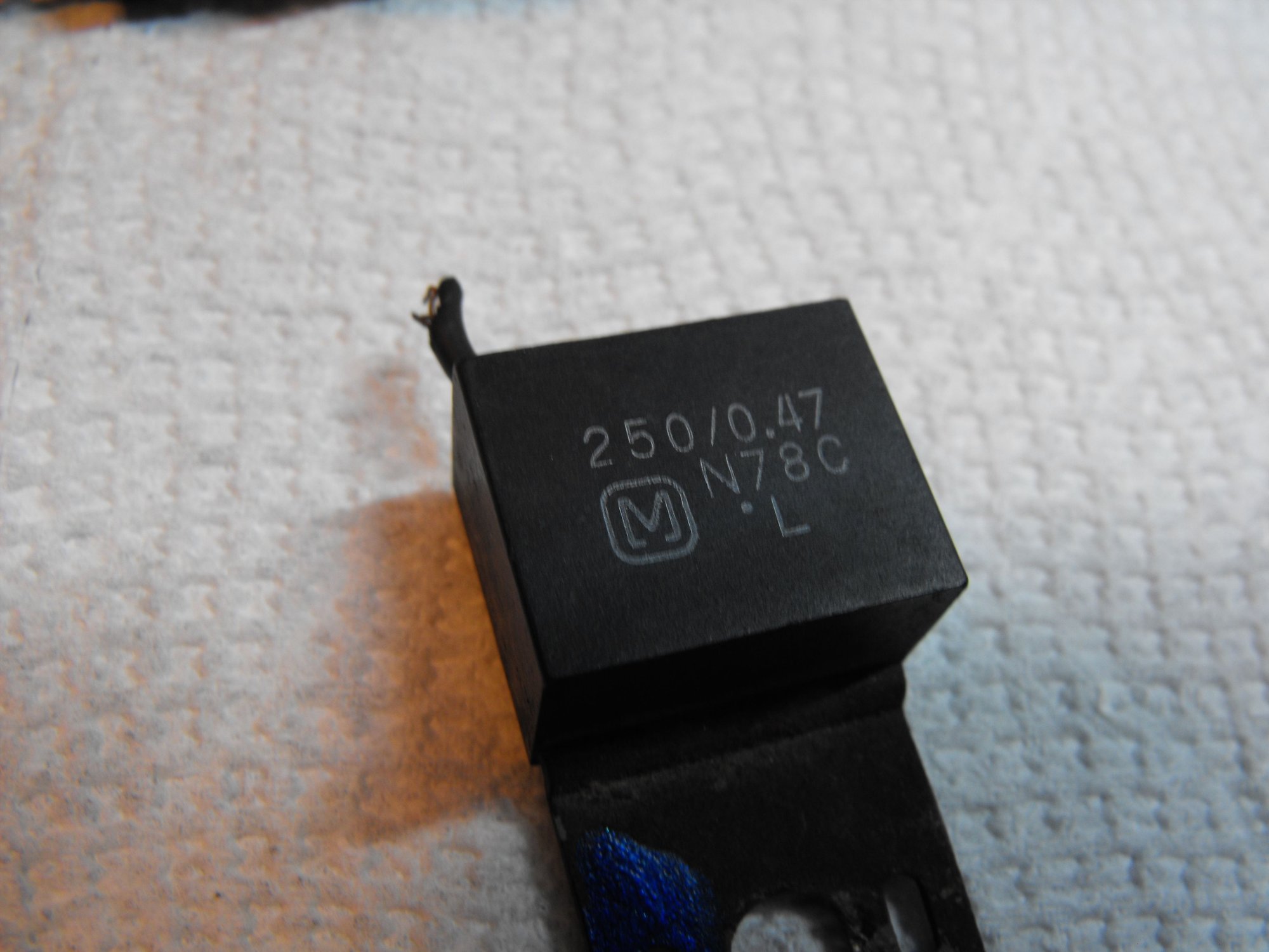

The strange thing is that we cannot find this part number (250/0.47 N78C L) anywhere. Also, the parts suppliers do not show anything like this. Anyone know if this part is supposed to be used with this engine? The original owner could have substituted this wrong part year ago.

UPDATE: Actually, the 99 Montero does have the Ignition Control Module, identical to the one on my 94 Montero. However, I found out that my 94 has the wierd "Ignition Capicitior or Ignition Transistor" right at the end of a plug that plugs into the Ignition Control Module. For some reason, Mitsubishi changed it for 99 and made it totally seperate from the ICM. After many hours researching for this little part, he finally found a Mitsu. dealer who blew off the dust on some old books, inserted a floppy drive disc, and went back to the Fortran punch cards to find that the part did exist, and there were only 5 left in the country. So, grab them while you can if you have a 99 Montero.
Old Jun 14, 2024 | 11:45 PM
Great job figuring out the answer to the mystery. The original part in your photo looks like it has wires all melted. Did it short out somewhere?

I guess the Prior Owner had it parked beside that old DeLorean outside the church bell tower when the bolt of lightning struck.......good for the flux capacitor in the DeLorean and the mad scientist, but bad for the Ignition capacitor/transistor in the Monty.
It looks like someone had put some type of black glue/compound all over the wires.....and it lasted a long time like that, but it finally "gave up tha ghost".

Well, what part number is stamped on your defective part? Is it the same 250/0.47 number?
Old May 16, 2025 | 06:51 PM
Andrew Moore's Avatar
Joined: May 2025
Sorry. Yes it is the same. But I can't find anything online used or new. Would Mitsubishi have a different part number? Like a MR something. Not skilled in finding things like this.
