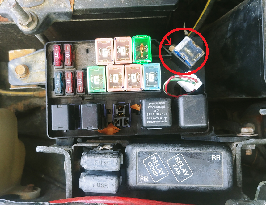

Check all your lights, especially the brake/tail lights. If one has failed and the broken filament lands the wrong way, it can cause all sorts of issues. Kind of a shot in the dark but when I had one do this, the brake lights stayed on, and when I'd press the brake pedal, the dash lights would turn on and off. I've even heard of this causing a horn to keep blaring. I would also check your ground points and the main positive connector to the fuse box, check everything for corrosion. The main grounding point for the battery is located behind the A/C compressor, you can easily access it from the driver side fender well. As a precautionary measure, remember to disconnect the battery before touching anything electrical, I don't want anyone getting hurt.
This is where the main positive connector is for the fuse box:
