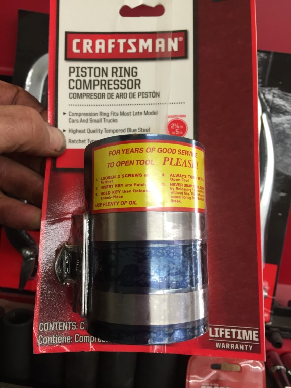

Bought some Craftsman tools at Sears to assist in the rebuild. Valve spring compressor, gasket scrapers, and ratcheting type band piston ring compressor. All Made In USA
Still need to buy engine cleaning brushes, dingle berry hone, and piston ring expander pliers.
