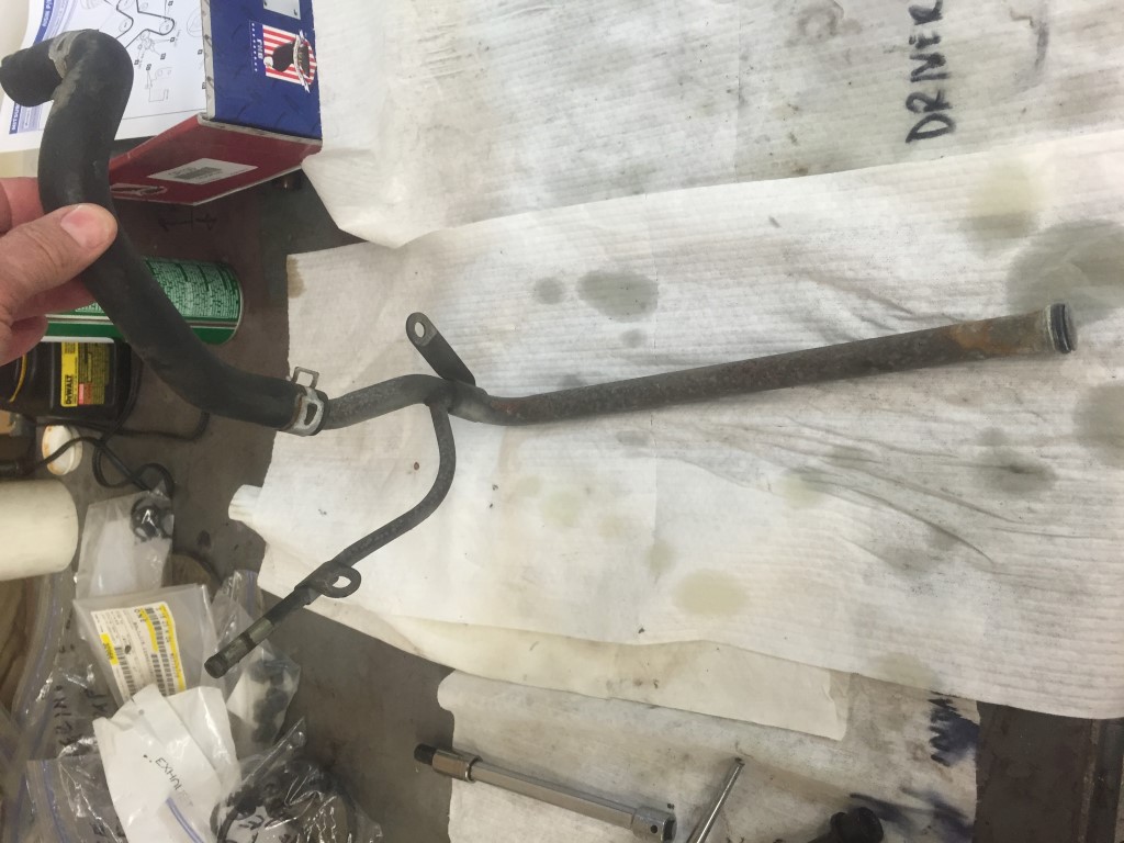

Upon pressure testing it to check for leaks i found one of and hopefully the only issue.
It is the water coolant pipe. It is leaking from the very back of itself. It is a bad leak and causes pressure to drop drastically and fast. Unfortunately it is not just an o-ring on it .
It is magnetic so my friend said just take it out and he would run a weld bead over it for me. Another friend said to just pull one from a wrecked one the only issue i could see from that would be if it also leaked.
I am not sure i want to do that but I figure it couldn't hurt to try that first to save $ on buying the 100$ coolant pipe.
That was why I heard the bubbling coming from the middle of the engine.
I really hope this is the only leak issue, but will pressure test it again once I put the pipe back on.
If the gauge did not register it as over heating would that be caused from the leak and it just wasn't getting to it? Hopefully that's the issue with it.
Going to fix the pipe issue whether I get it welded, pull one, or buy it new. I will report back after doing that and running a new pressure test.

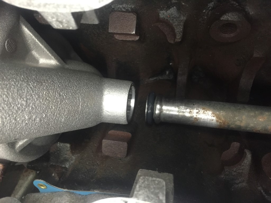

Attached are some pictures of the water pipe from my 3.5L engine.
I think (no guaranty) the part number might be MD324680. If you search that part number at the link below, it is $32.10. I have bought parts from them and have been very pleased. Eric in the parts department was very good to talk with and used the VIN to confirm parts would fit.

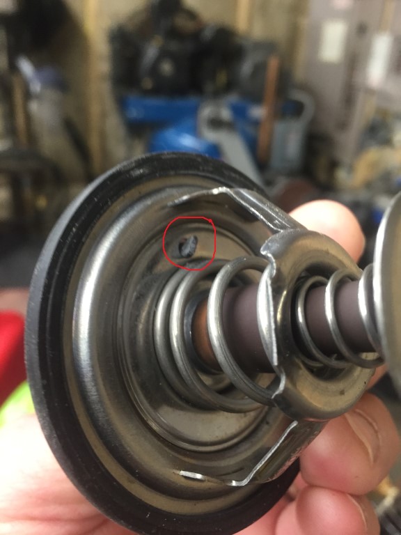

The manual shows a "jiggle valve" on the thermostat and says it needs to be straight up. I assume this has something to do with removing air pockets in the system. Pictures of my thermostat are attached (no clue if mine is OEM or not. It is stamped "MotoRad" on one side and "Germany" on the other).
