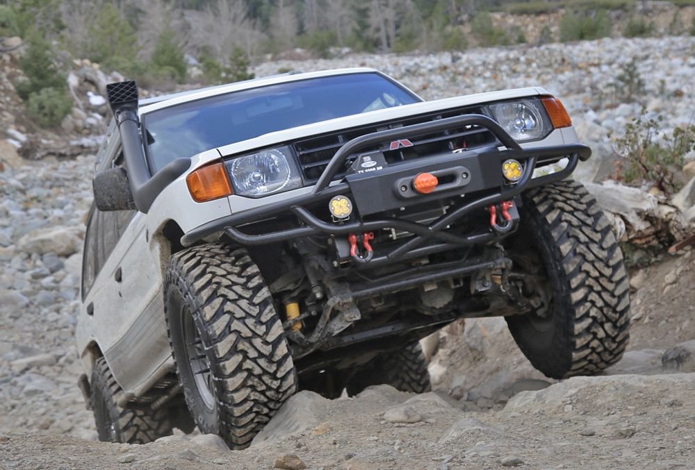

I agree with you about "building a Montero Mountain Monster"......a bad *** Triple M, maybe kinda like this one: If you ever watched "4 Wheel Drive Action" on Youtube, then you will get a ton of great build ideas, including the rear mounted sliding Waeco cooler.....thats a real good series to watch, no commercials, great action, and you can learn a ton about off-roading. I would like to turn one of my more "worn-out" rigs into a good off-roading rig also........maybe someday.

That's a beauty
