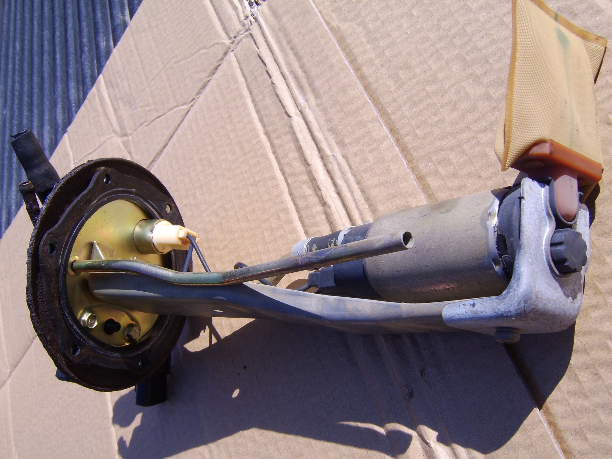

Greetings. I have run into the very common issue of the fuel pump assembly unit getting rusty on the flat top, and the two exiting fuel lines rusted and sprung leaks. Here is a pic of the fuel pump assembly from the 1999 Montero SR:
It has a fuel exit line and a fuel return line on the top. Also, there is the 2 prong connection for the fuel pump, and a 3 prong connection for the Tank Pressure Sensor.

Got no replies from anyone, but I will give a useful update:
We bought a new fuel pump assembly for $65, which was not a direct fit. It was for a Montero Sport, and had longer metal lines on top, and way too long.
We just cut the top lines, and reduced the total length by cutting the bracket down and rescrewing the pump on.......Well worth the extra work instead of paying $500+ for a "direct fit" assembly.

The 99 Montero is my brother's, and I believe he just ordered it from eBay. It was for a Montero Sport, and was only $65......so, Im sure you can go to eBay and find it. As I mentioned above, he had to cut the pump support bracket to make it shorter, and also cut the long metal lines coming out the top to make them shorter. Then, just use a rubber fuel line and clamps to connect the top to the existing metal fuel line going to the fuel filter.
