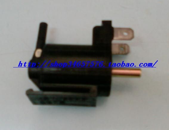

Hi Astromam, thanks for the reply. I removed the solenoid causing the code (p0403) and I have a sinking feeling that its a california special thats no longer available. The solenoid you linked me to is the EGR Purge solenoids, but my rig has EGR 2 solenoids.
The one I'm looking for has k5t49586 stamped on the side of it. This translates to mr127232, which I can't find anywhere. Apparently, my dealership ordered the "Purge solenoid which has the wrong connector and mount.
the search continues...
it looks like this..
Old Jul 11, 2017 | 09:04 PM
Astromam's Avatar
Joined: Aug 2016
Posts: 5
Default EGR solenoid problem
[QUOTE=MNalfa;320744]Hi Astromam, thanks for the reply. I removed the solenoid causing the code (p0403) and I have a sinking feeling that its a california special thats no longer available. The solenoid you linked me to is the EGR Purge solenoids, but my rig has EGR 2 solenoids.
Just covering all the bases. Have you checked if you have voltage and ground on the plug, cause if you don't you might replace a good solenoid that has an electrical issue. You can ck with a cheap test light. If this is the case, you won't need the part. Try with ignition "on" to see which is what (pos or grd)
Old Jul 12, 2017 | 12:03 AM
Posts: 2,044
Just throwing this idea out there - what if you take a different solenoid and change the harness connector to make it fit the new style? I realize it is risky, but how about making an adapter to go from the old harness to new solenoid?

Old Jul 13, 2017 | 12:38 AM
Astromam's Avatar
Joined: Aug 2016
Posts: 5
Default EGR Solenoid problem
You know , Hunter has a good point. And I can add to that. Now that I see what your solenoid looks like, you can get a generic solenoid with the blades and just plug the terminals, no need to make changes to the harness cause is very simple. Quite sure any other will work cause the ECM will send operating signals. Let us know how it turns out
