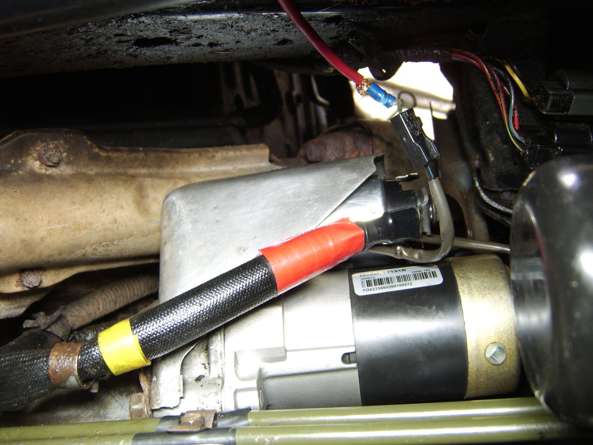

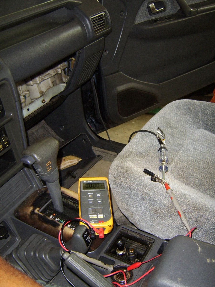

Getting the voltage reading from the "Trigger Wire" while turning the starter key:
This time there was not enough voltage to light up the test light. In a prior test at the trigger wire, I did have a bright light on the test light. .15 Volts......shoot, a worm would have a higher reading on a cold day in January when molasses does not flow. Captain Kirk would say, "Scotty, we need more power! Gotta have more power NOW!"

That being said there should be ~12V @ the [Trigger] connector you removed in the new pic. (Meter pos at connector neg to a good gnd.) Hmm... where does the red cable you inserted into the connector go?

Red cable that was inserted into the "Trigger Wire" connector extends about 4 feet and then connects to the test light wire which you see in the picture.

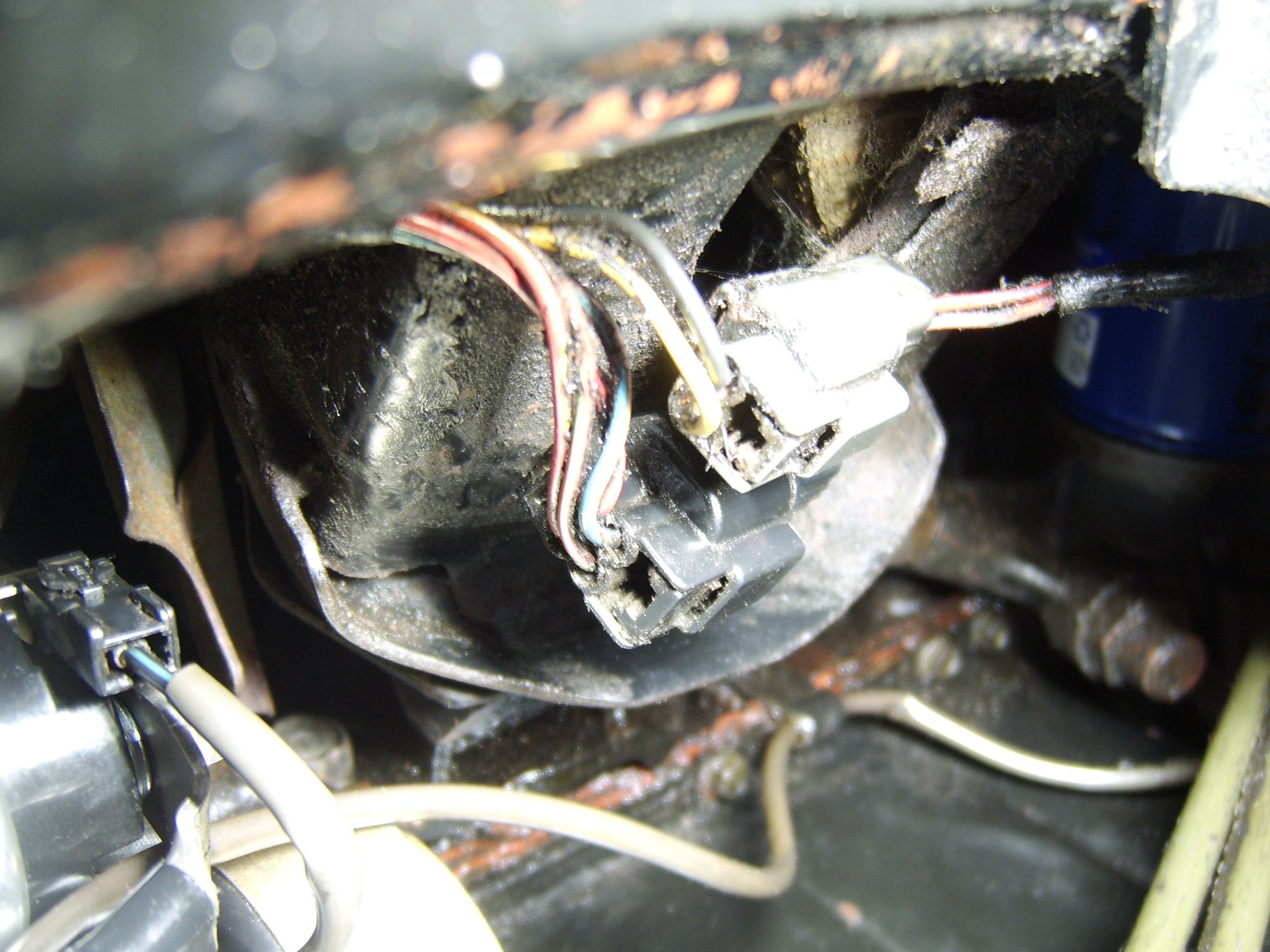

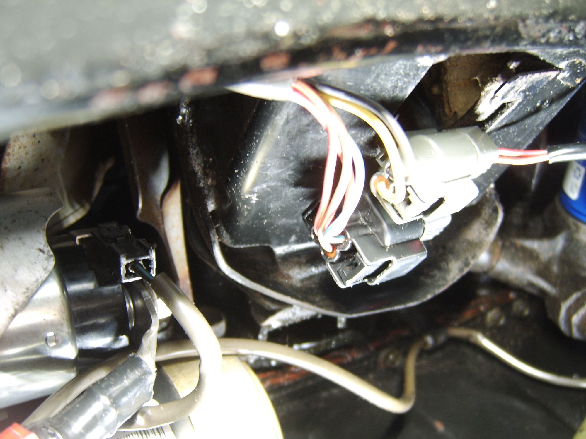

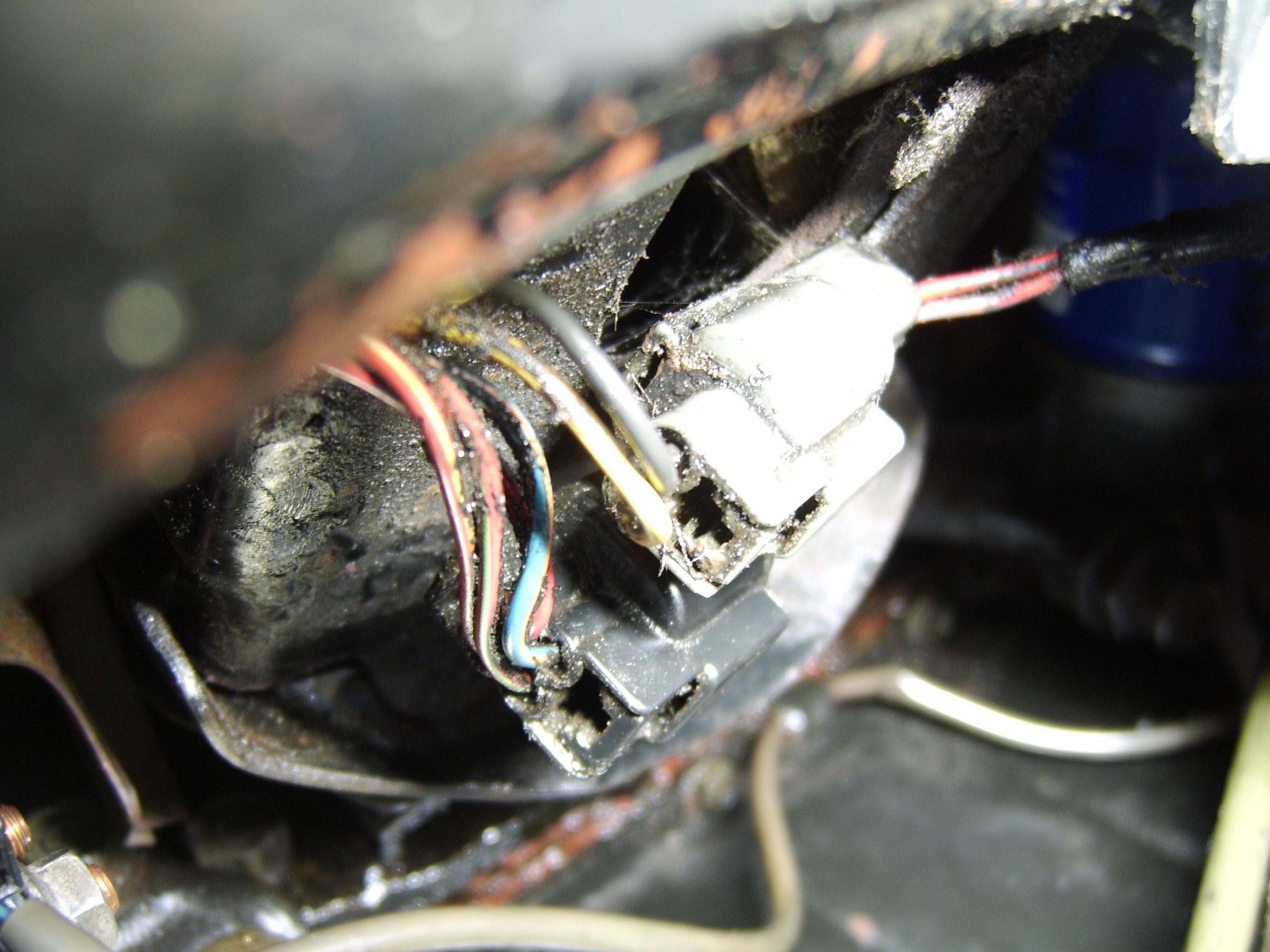

There are also a couple connectors hanging near the starter that are oil soaked, and easy to get to to clean......I will give that a try, but not sure if those wires are even related to the starting circuit. I had wiped them off a bit already, but it would not hurt to disconnect them and give them a good degreasing: You can see the starter and its black/blue "Trigger" wire to the left.

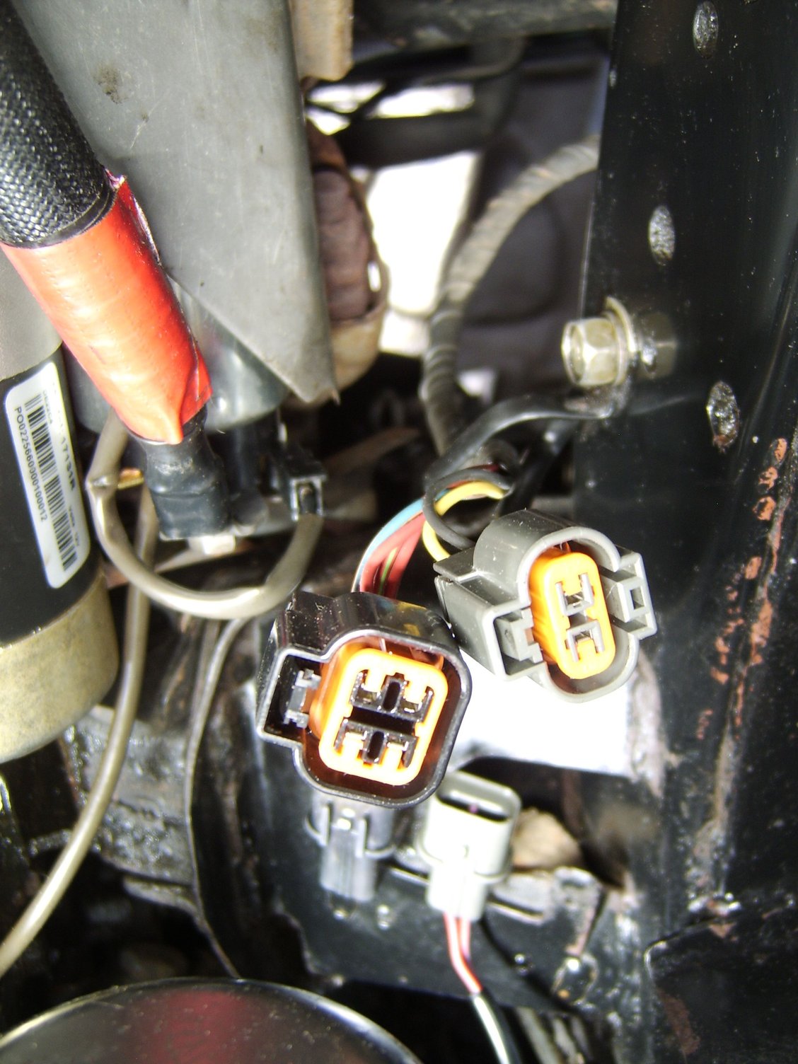

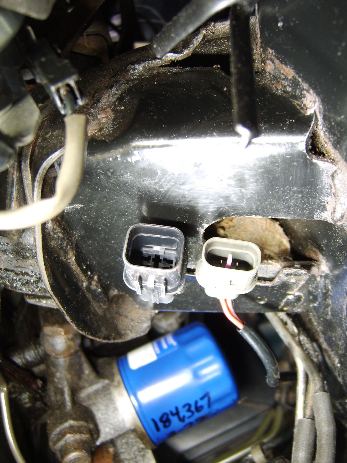

Well, I got those oil-soaked connections degreased......but turns out the larger 4 wire one was a "dead-end"......I guess it was for antilock brakes which this rig does not have. However, has anyone ever done an analysis as to the actual affect that oil has on electrical connections? Im curious as to how much voltage drain or "prong to prong" volts can be transferred under conditions of severe oil penetration into these connectors......do electrons flow as good through oil as they do through water, for example?
