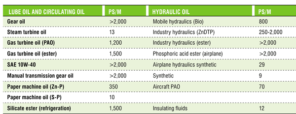

Hunter......I had always thought that oil would conduct those little electrons, and that oil-soaked electrical connectors were not a healthy thing to have on a vehicle. Good to learn otherwise.
I found this on the internet, showing conductivity of various oils......the higher the PS/M number, the lower the conductivity. So the 10W40 and similar is not very conductive. However, the article claimed that synthetic oils are much more conductive, and thus the low PS/M number of 9 in the chart.
The article also said that additives in the oil can make a huge difference.....like oils with Zinc are much more conductive. Also, if the engine has a lot of engine wear and metal particles getting into the oil, the conductivity goes much higher.
But back to my "No Crank/No Start" issue and even with motor oil soaked all over the ignition circuit connectors, it probably should not have much impact (unless the prior owner of this Monty was using synthetic oils, steam turbine oil, paper machine oil, or pouring iron fillings down the oil-fill hole).

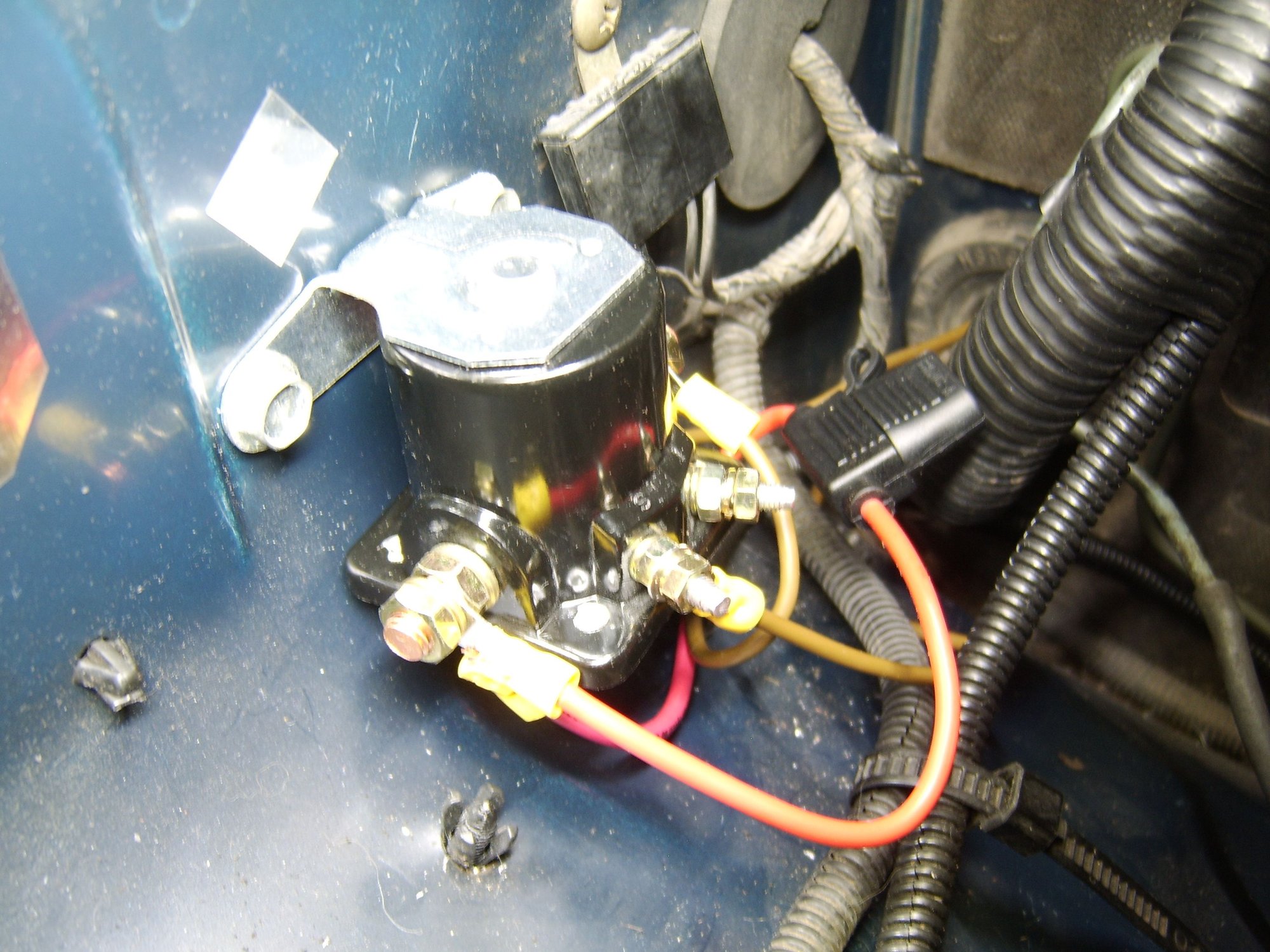

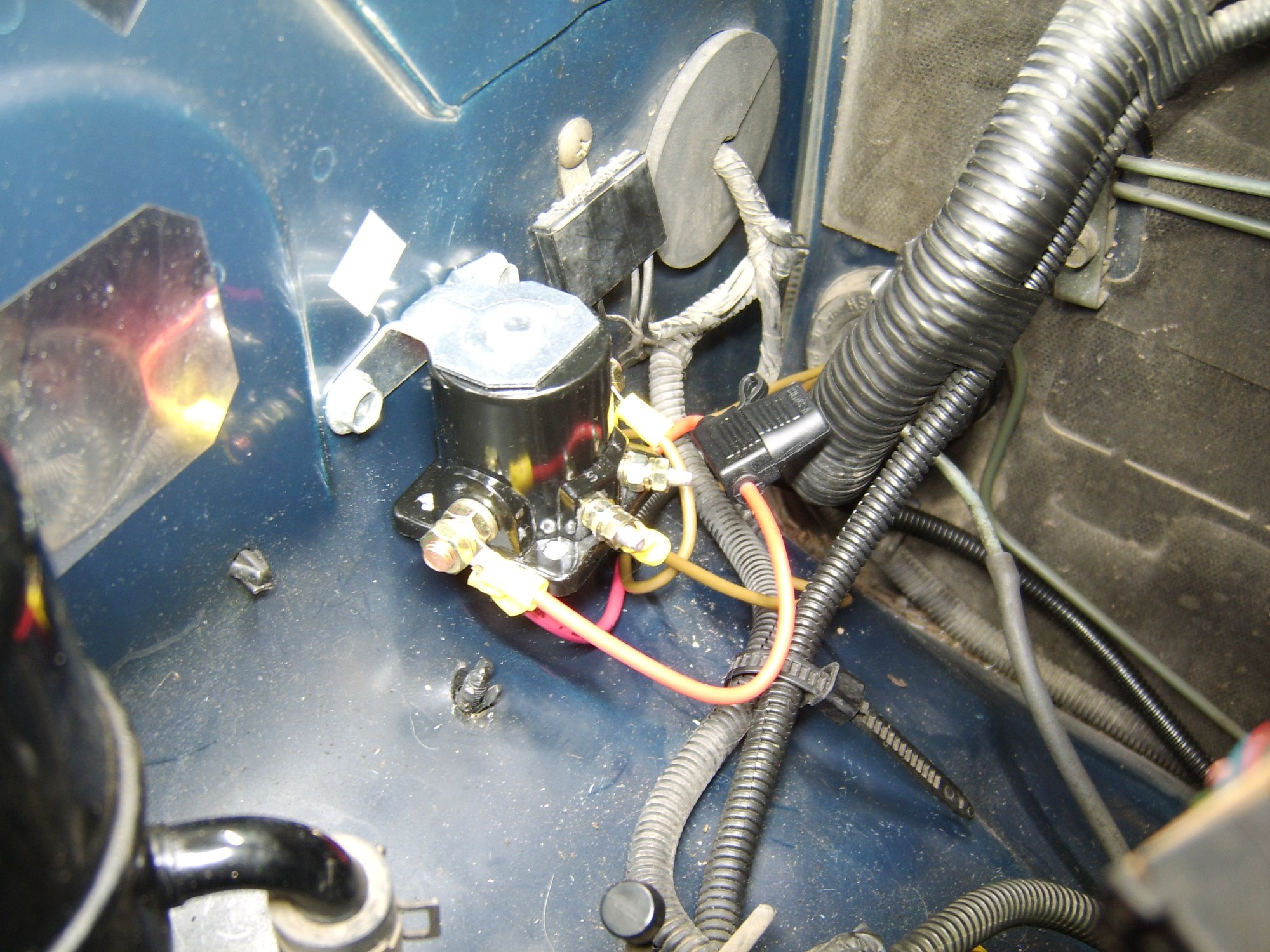

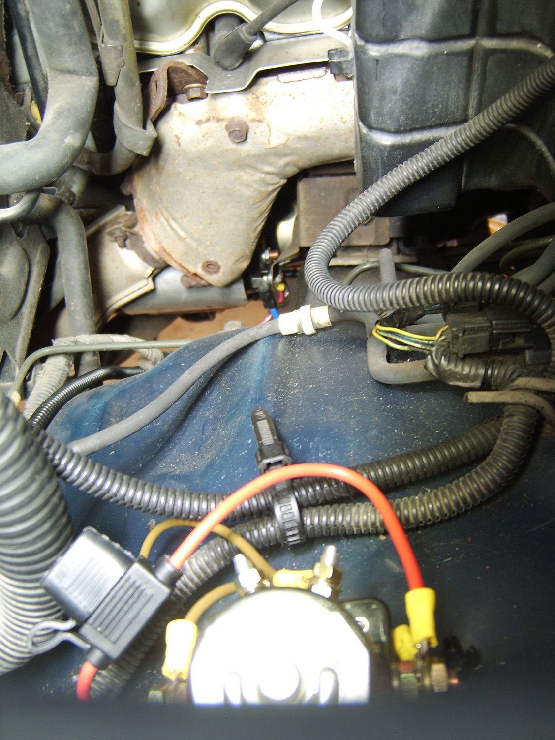

Hey.....I got the Starter Push Button Switch installed, and it works perfect. Just what the doctor ordered:
I had the Ford solenoid type, and went ahead and used it......on the passenger side fender, just like on my old 1969 Mustang that I drove 45 years ago:
I put an inline fuse from the hot wire running through the firewall to the starter button:
I am drawing power from the positive battery terminal end at the starter solenoid, and another "Trigger" wire runs from this Ford solenoid straight down into the existing "Trigger" wire that plugs into the starter solenoid:
This new set-up is also EMP-proof, but not sure if the ECM and other computerics will survive an EMP blast.
Will cross that bridge when we get to it.
