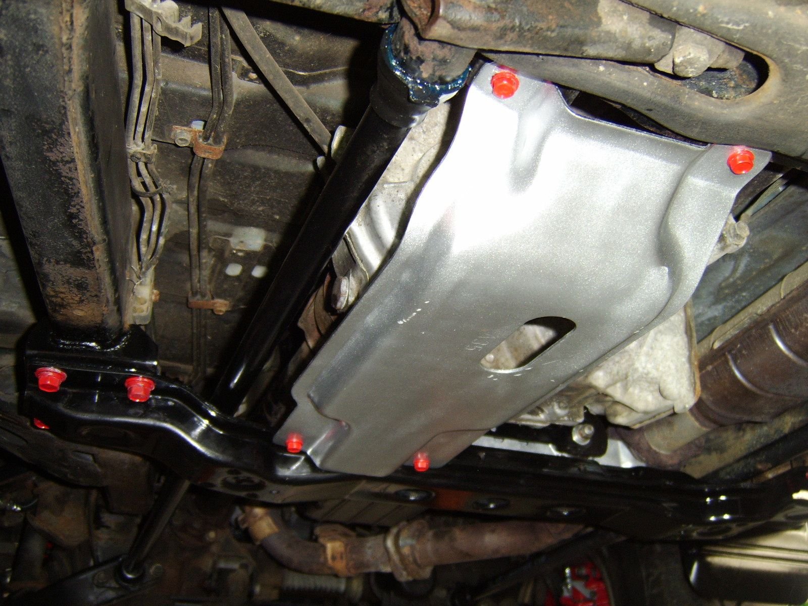

If you have access to a sheet metal bending machine, you can make your own skid plate. I had to make one for my engine after the wimpy plastic thing fell off. Just used a sheet of 3/16 steel (I think that's the thickness, perhaps less) that i had around. Its heavy as heck, but its not going anywhere and it really protects the bottom of the engine.
Old Feb 26, 2019 | 06:30 PM
1960StudebakerHawk's Avatar
Joined: Jan 2019
Posts: 483
Hunter......Thanks for the thumbs-up. Sure, bring your rig on over and we can knock it out.......I will let you do all the removal, degreasing, sanding/prepping, and then I will shoot the paint on. Its a dirty job, but someone's gotta do it.....ha ha.
Im thinking the mechanic who works on this rig years down the road will appreciate the clean working environment down under.
Good idea about making a skid plate......I thought about it, but if I can find a used one from a salvage yard, it will bolt right up and be original equipment. I probably should just drive by a tranny shop, and there will probably a bunch stacked up like pancakes out back.......they get taken off and not put back on and tossed in a big pile.........dern knuckleheads.

Got the cross member mounted and tranny is now resting back on the proper rubber mounts:
I plan to sand/paint the entire frame this summer, so properly painting the cross member now was well worth the time (since I had to remove it anyway).

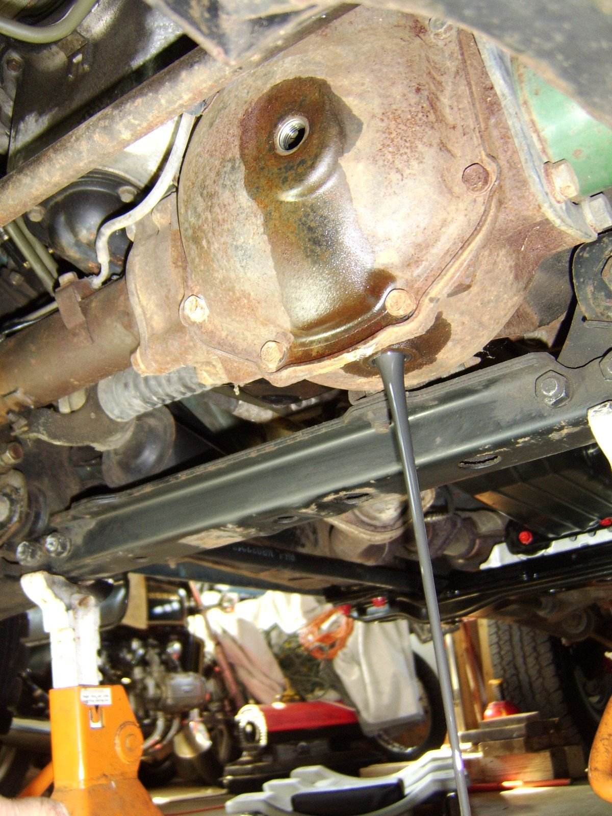

Changing the front diff:

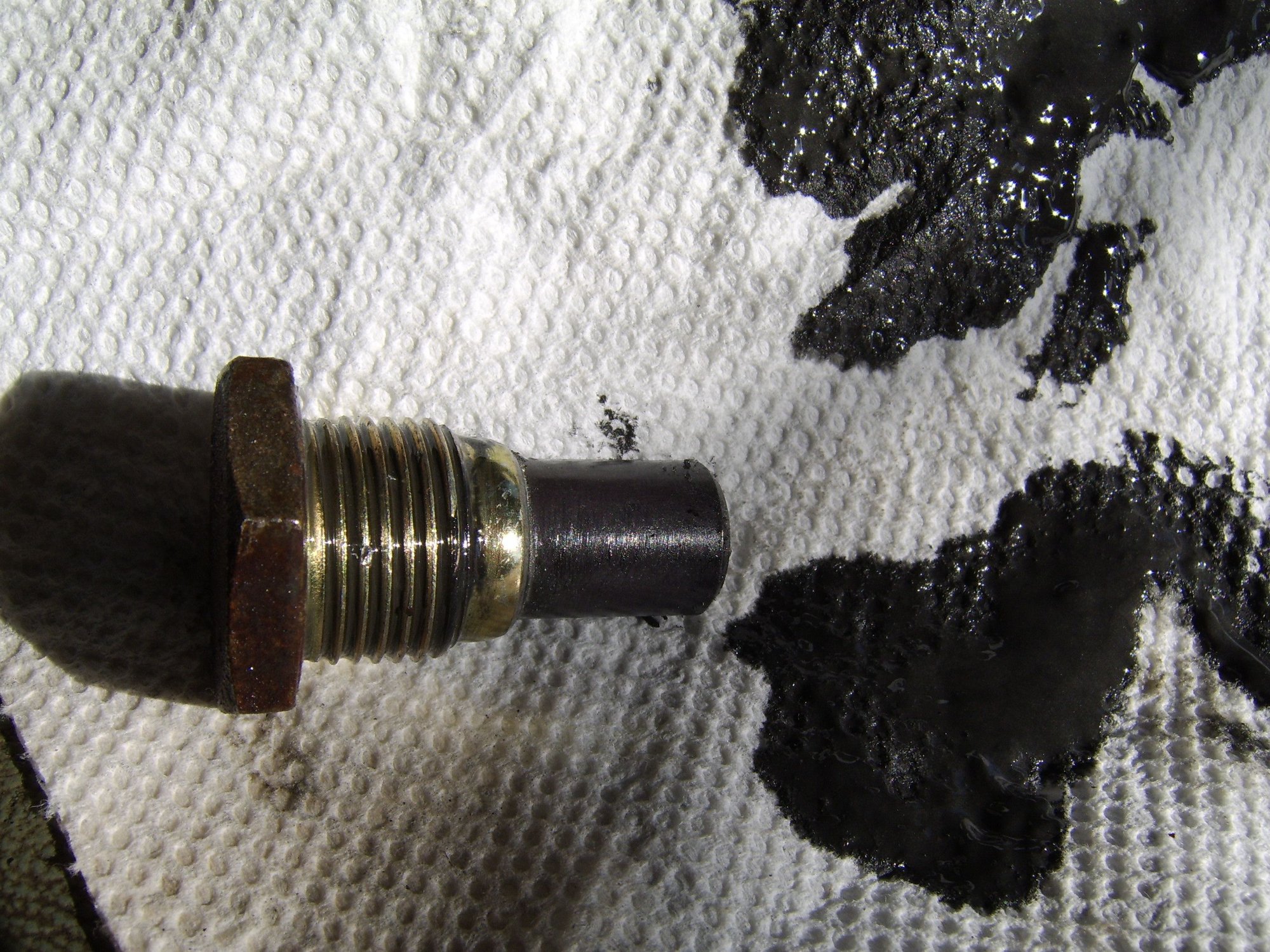

All three differential boxes had a plug with a magnetic shaft, and they were doing their job as you can see in the pic a super thick layer of metalic sludge about 1/4" thick:
After wiping off magnetic plug:

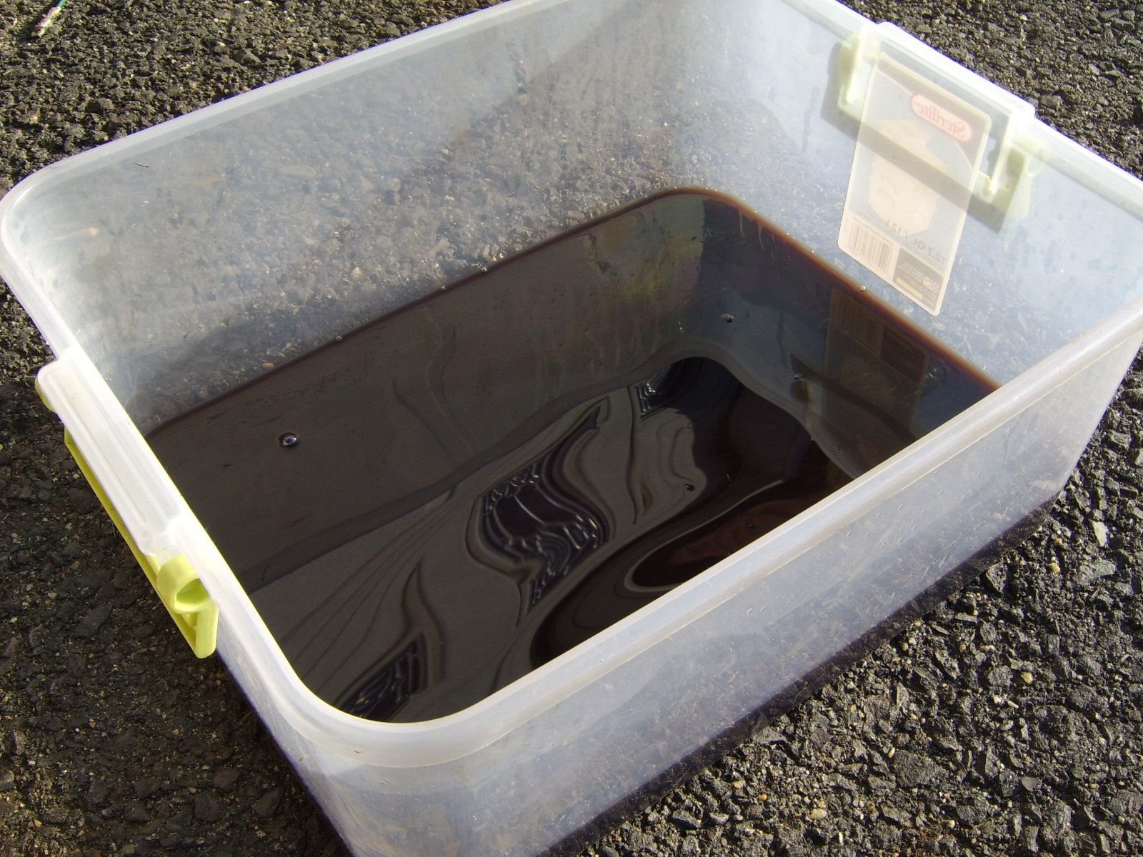

After draining the thick oil out, I then injected about a pint of diesel fuel into the 3 transfer cases, put the plugs back in place, cranked up the engine, and let the car run in 4 wheel drive to slosh the diesel fuel around iniside the cases. This helped get all the grime out of the cases:
Front diff:

Diesel fuel came out pretty dirty, so it did its job:

Another krud-incrusted magnetic plug:
Some pretty knaley kruddy sludge came out, but no Pumpkin Seeds:
Question for the experts: Do these magnetic plugs typically look like this when changing these fluids every 50,000 miles? I dont have the maintenance history on this rig, and am guessing they were never changed and the clock now sets right at 100,000 miles (low for a 25 year old MitsieBitsie).
Old Feb 27, 2019 | 08:55 PM
Not an expert, but this is exactly what you want to see - light fuzz and no large chunks of any kind. The crud you see on magnetic plugs is just the metal wearing off the contact patches on the gears. The crud itself is not an indicator of any issues.

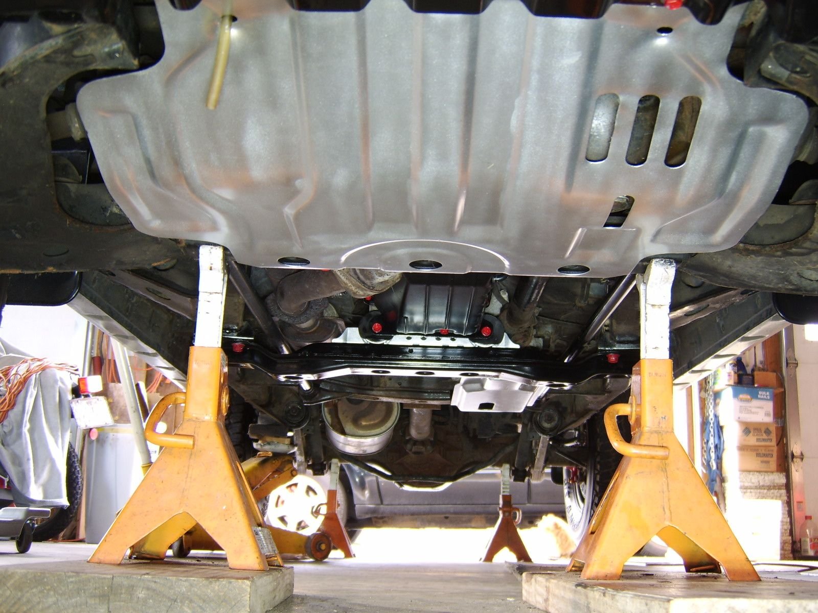

Wrapped her up today......Got all the skid pans put back on:
I am missing the skid pan that protects the tranny oil pan......does anyone know if this was standard equipment, or a special order option? (There are threaded holes on the frames for one).
