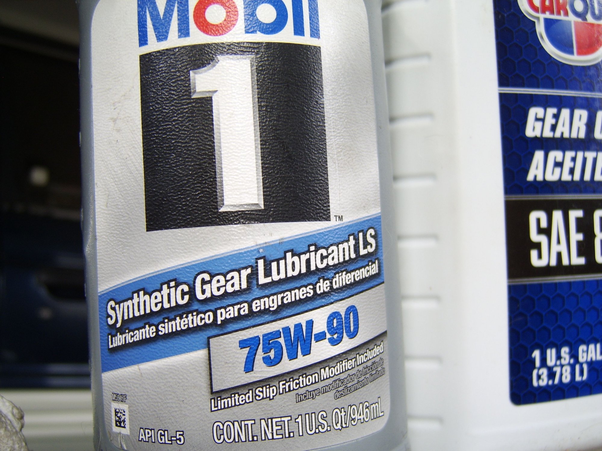

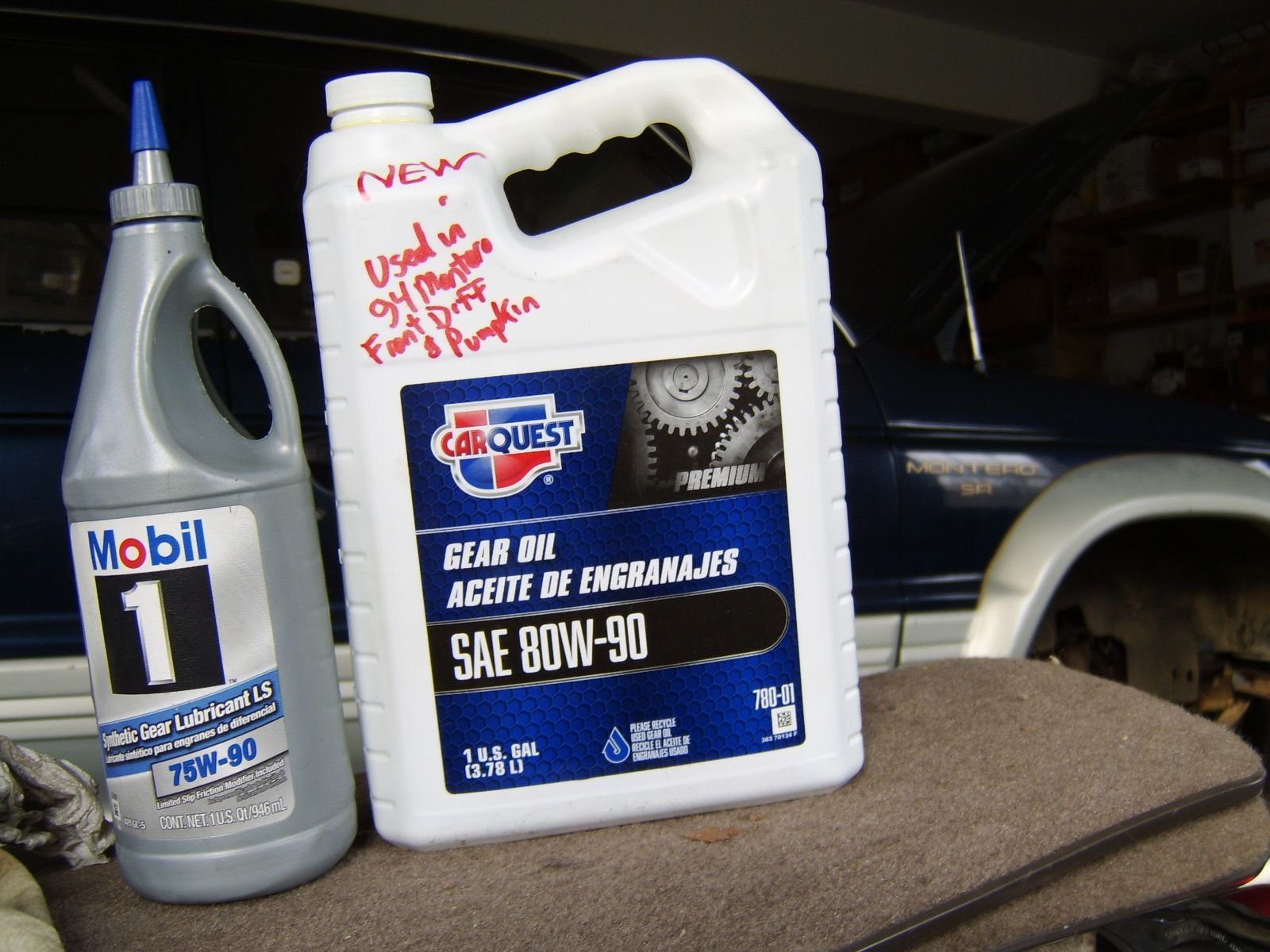

Hey MarkRobert61.......Here is a pic of the gallon jug I used for the front diff and the rear pumpkin, and the smaller quart container of Mobil 1 Synthetic 75W90 I used in the Transfer Case.
Up close.......this is API GL5, which is what is specified in the Shop Manual/Owners Manuals. Is there anything wrong with using this? Why should I use GL 4 when the manuals say GL 5? Help me here, as I wont be able to sleep until I know that Im not destroying the Transfer Case.

Ok, this gets a little technical: GL5 is a superior high pressure lube, but therein lies the problem. Under the pressure of the gear engagement a sacrificial layer is formed on the face of the gear teeth by the lube. As the teeth slide apart, this layer will shear off instead of the steel wearing. The problem is that Montys have synchromesh transfer cases. The synchronizer gears are made of brass, bronze maybe, and the sacrificial layer that forms has a stronger bond to the surface than the actual strength of the brass itself. Every time the shearing occurs, it takes a little brass with it. One of the guys on the 4x4 Wire had his synchros wear completely out in just a few months, the oil was iridescent gold when he drained it.
By the way, if you get a fluid spec printout from O'Reilly, it shows GL5 for the pumpkins and GL4 for the transfer case.

Markrobert61.......OK, I just checked the Owners Manual again.......and after reading that small fine print, you are right. It states that the Transfer Case takes GL4 75W90. I used GL5 75W90......dern it!
