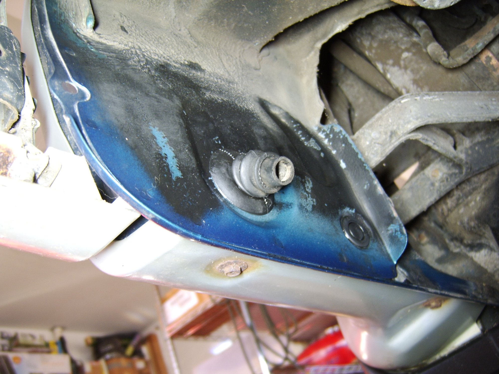

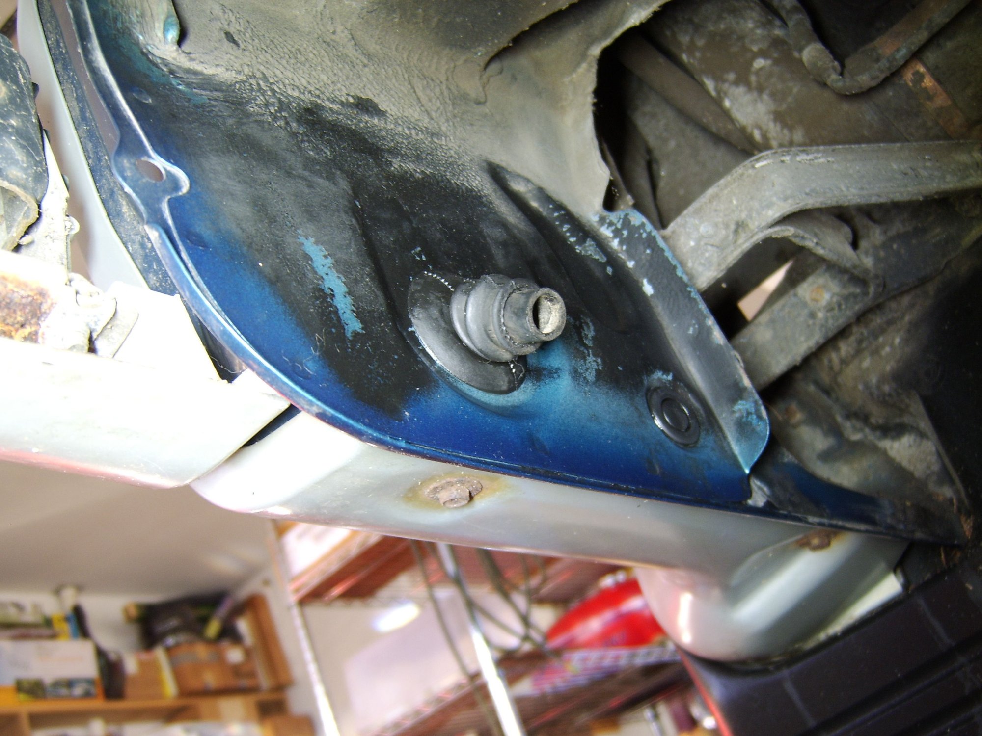

There is a drain hole in each corner, and there are rubber hoses connected that takes any water down to the bottom of the vehicle where it drips out. I found the two rear drain tubes, which come out behind each of the rear tire quarter panel areas:
Right (Pssgr) side:
Left (driver) side:

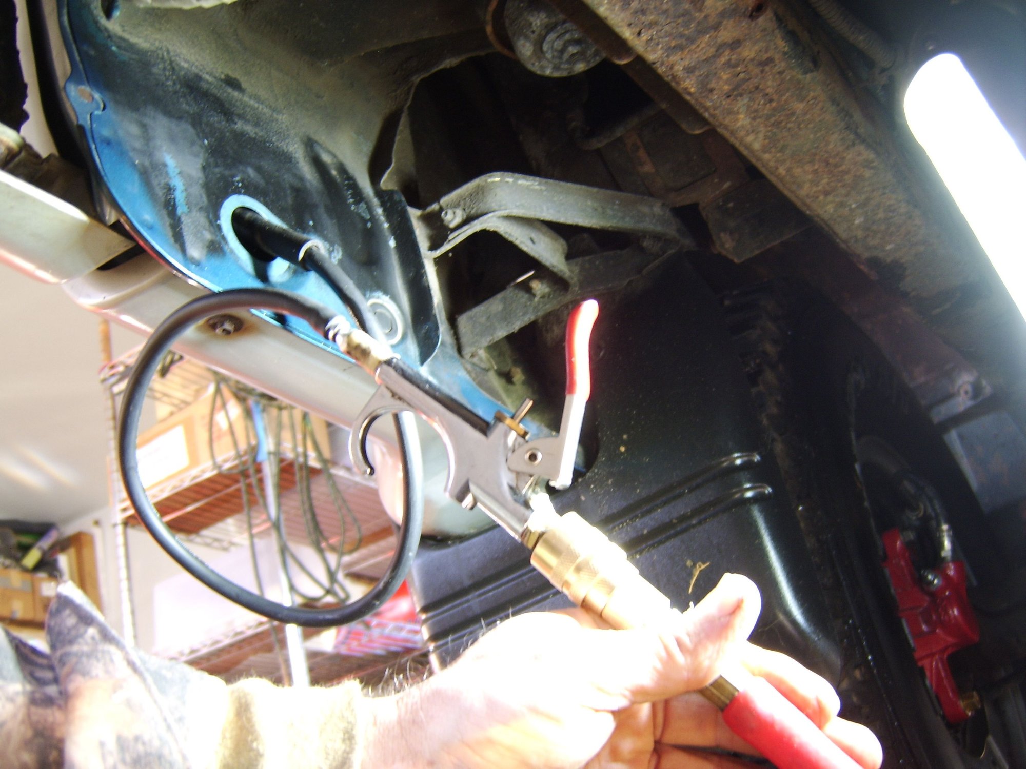

I first ran weed-eater line up the tubes and then tried to use compressed air to hopefully blow out any potential debris that could be blocking the tube:
(Pretty Ugly job, if you ask me.....ha haaaaa):
These two hoses go up to the rear section of the sun roof, and you cannot see those corners since the metal roof is above them. (I guess you would have to remove the entire sunroof in order to perhaps see those corner drains). I have the Factory Shop Manuals, and their description of these drain hoses is very poor, and do not show where these hoses are routed to. The rear ones are easy to find, but so far I have been unable to locate where the two front drain hoses actually exit.......I have searched all under the vehicle, and in the door jambs, but dont see the front two hoses. I also tried pushing the weed-wacker Ugly line down from the top of these front drains, but it only goes to the first sharp bend, and then will not go further.

Pictures did not upload properly. Will try again:
Right Passenger Side rear drain:
Left (Driver's) side:
Using weed wacker ugly line to fish up to the sunroof:

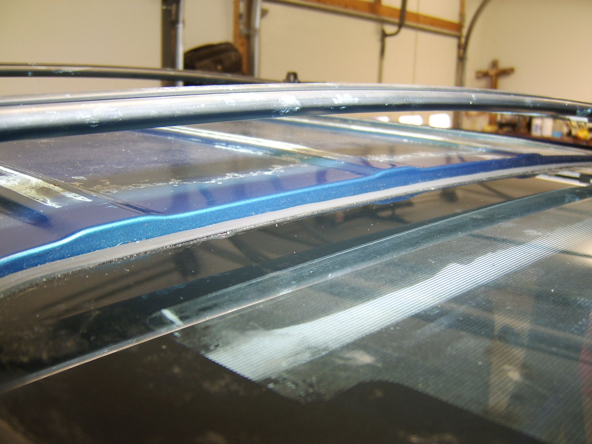

Here are better pictures showing the rear portion of the sunroof not popping up fully to seal. One thought I had is to use the little hand crank (in rear door tool box), and try cranking just a bit more after the electric motor has closed as much as possible. Maybe its just the motor getting a bit weak with age, and the hand crank will give it just enough "push" to allow the rear to pop up higher. ??????
Here is a view of the rear portion of the sunroof, needing to pop up about another half inch:
The front is up all the way:
Any suggestions from the experts here?

jburney......Yes, there is a manual hand crank took in the rear door tool box. I may try cranking it a hair further to see if the rear then pops all the way up.....but the front is already flush, and I dont want to stress the cable and break it. I still think there must be some type of spring that pushes up on the rear sunroof section......but the OEM Shop Manuals are very vague. I was hoping that someone at this site may have already gone through the process of removing one of these sunroofs, and could give more details.
Old Mar 11, 2019 | 01:38 PM
It's more likely that there is a small wedge on the cable that lifts the roof in place.

Hunter.......Interesting idea....a small wedge on the pull cable. Could be that this "wedge" has worn down or fallen off with time. Once I know for sure, I will repost what I discover.
