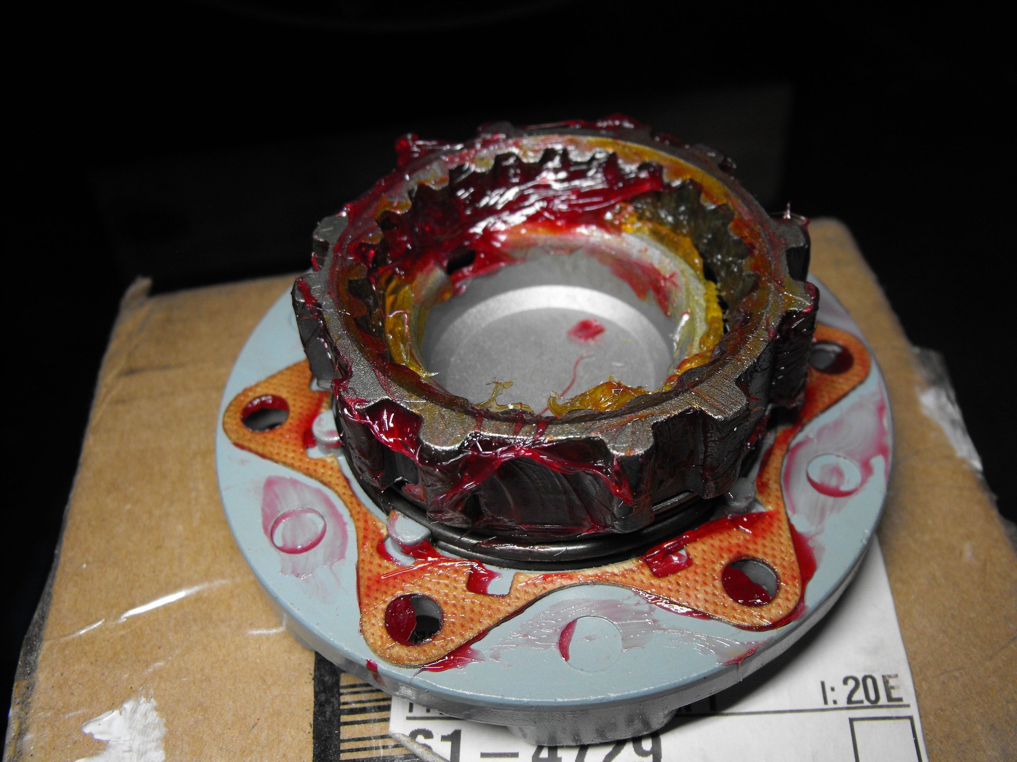

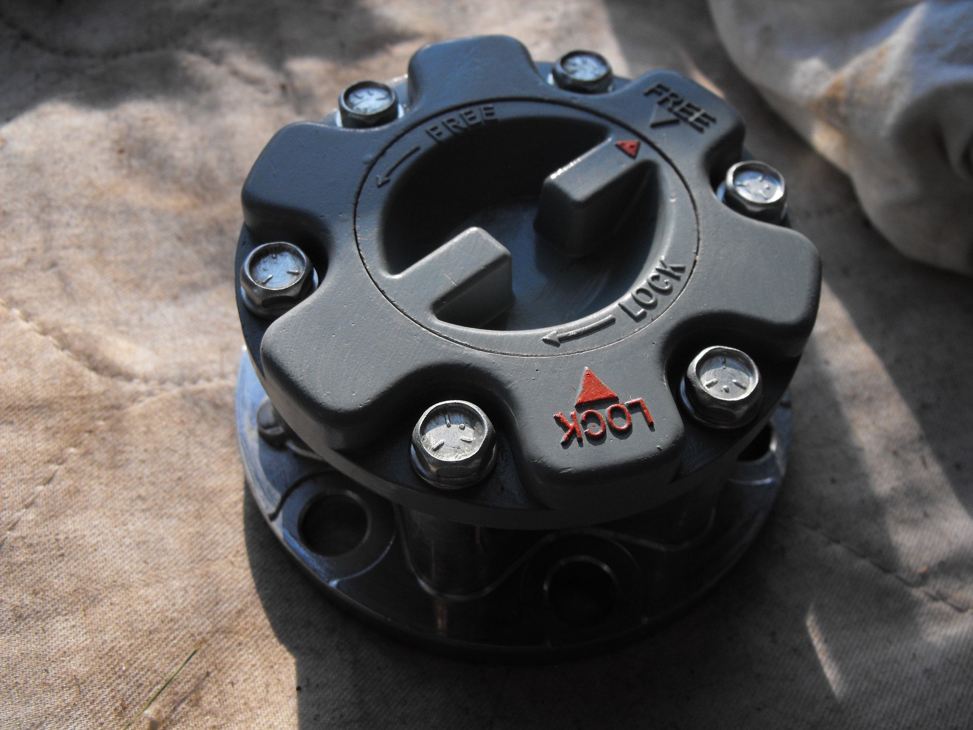

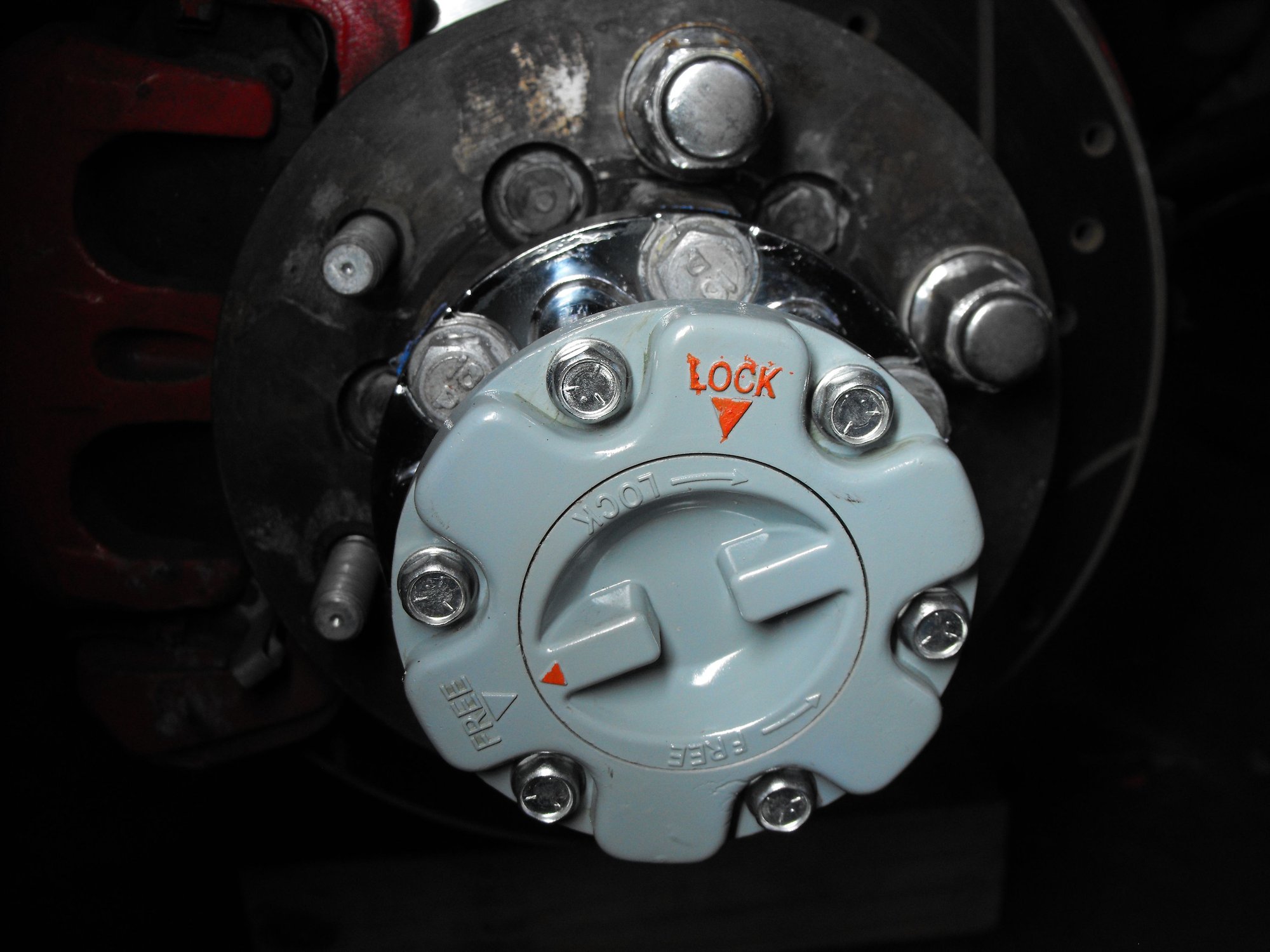

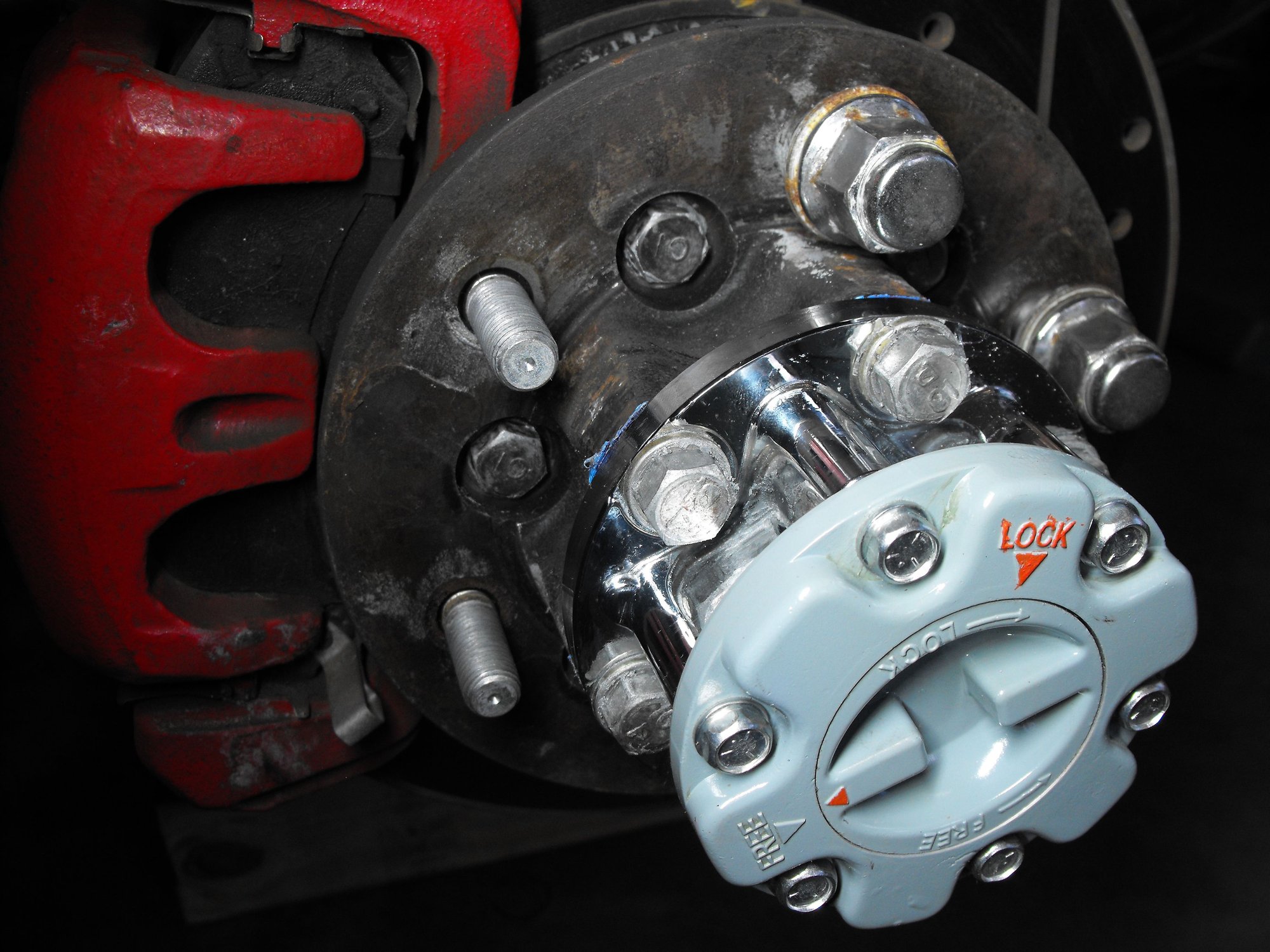

Here is a pic of the new front hubs installed. These Aisin hubs seem to be pretty good quality.....the chrome plating on the outside is great, the grey paint on the outside surface appears durable, and the 6 outer hub bolts are good quality (appear to be a type of stainless steel). The price is insanely low......a set of hubs is only about $65. (The messy red paint on the lettering is my sloppy work):

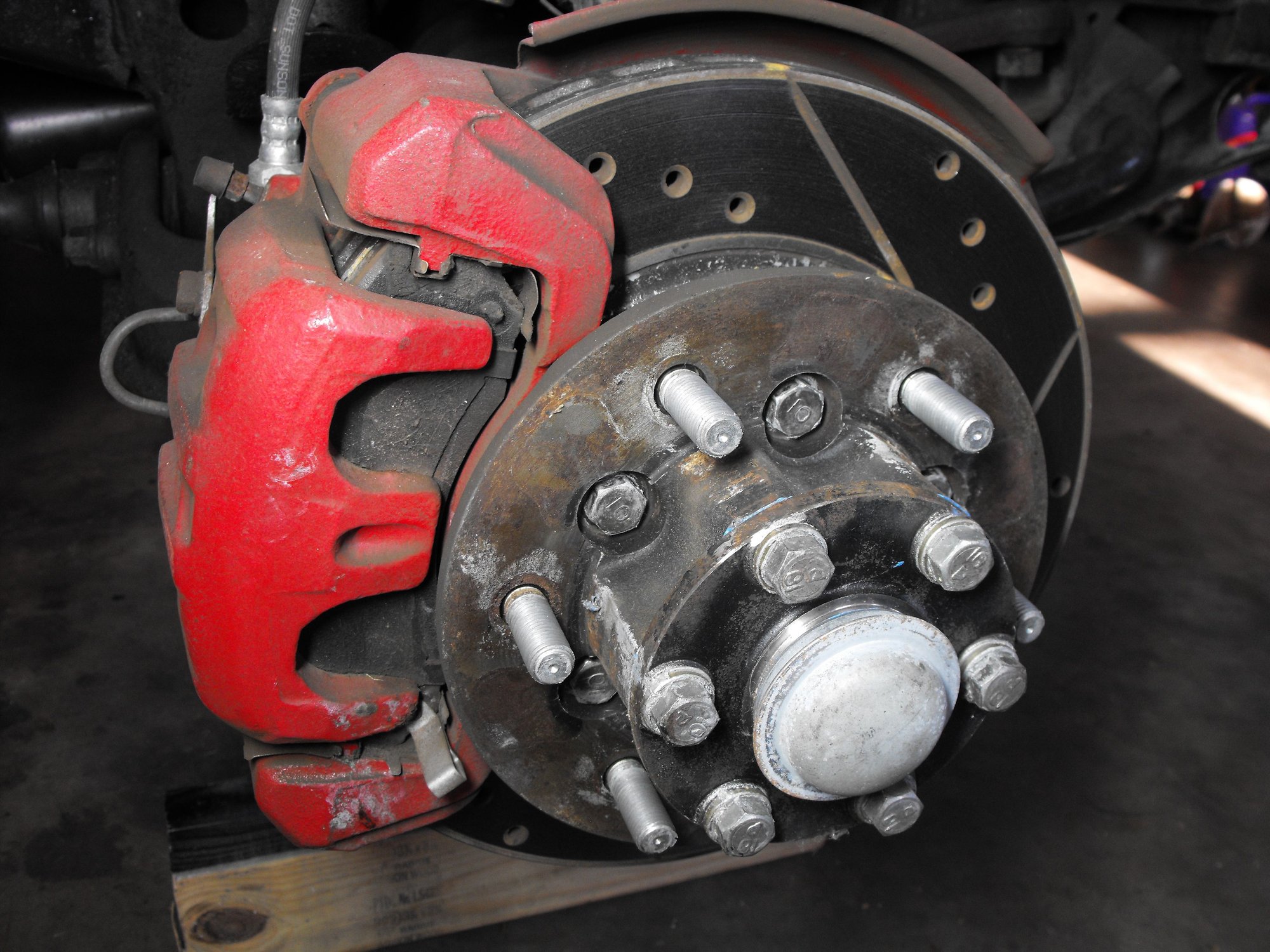

Pry off the little "hub cap".....can easily use a screwdriver to pry off one of the 6 14mm bolts, and work around the cap until it comes off.

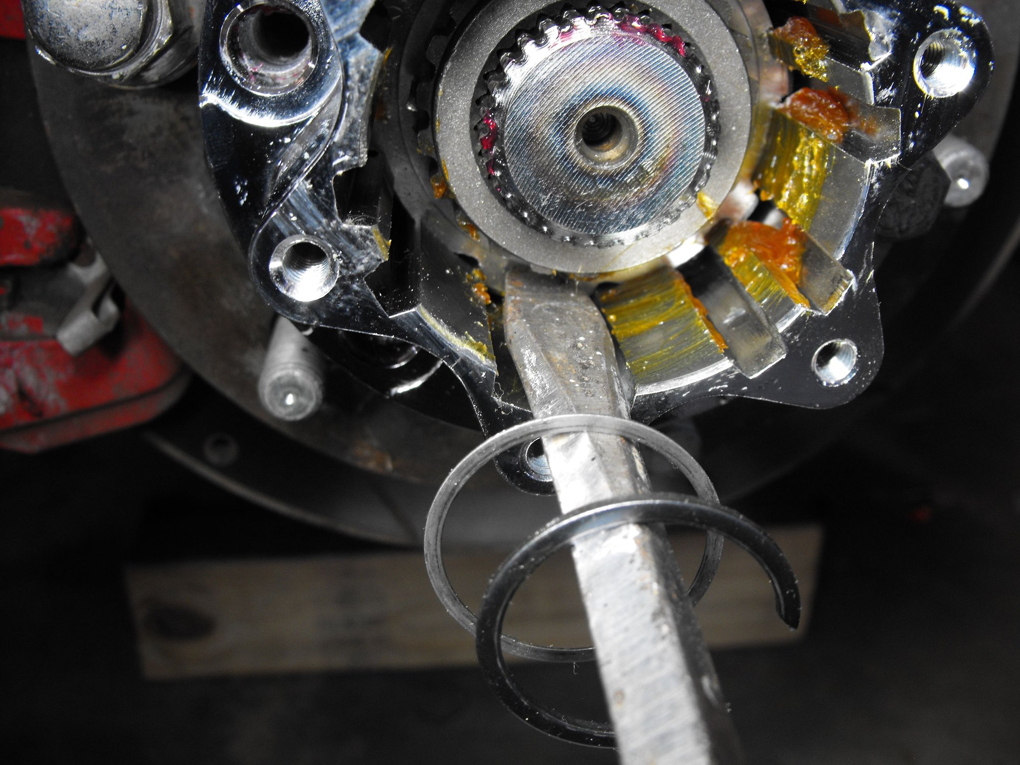

You will see the "C" clip and a thin flat washer which needs to be removed. I found that C-clip pliers to work, even though there are no holes in the C-clip, but kinda hold the C-clip so as to catch it if it should "pop" out from the pliers. Could probably also remove it with just a small screwdriver.

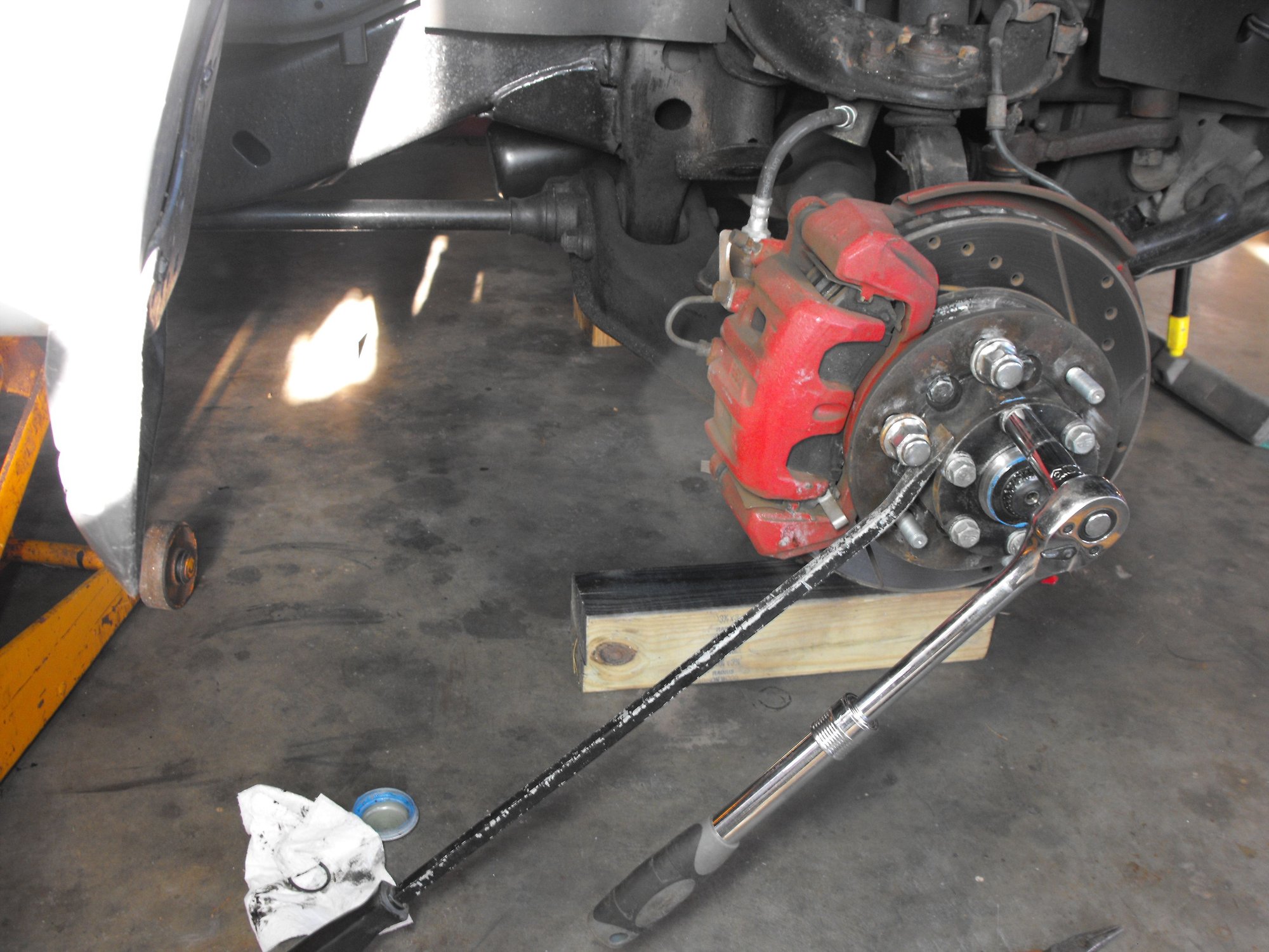

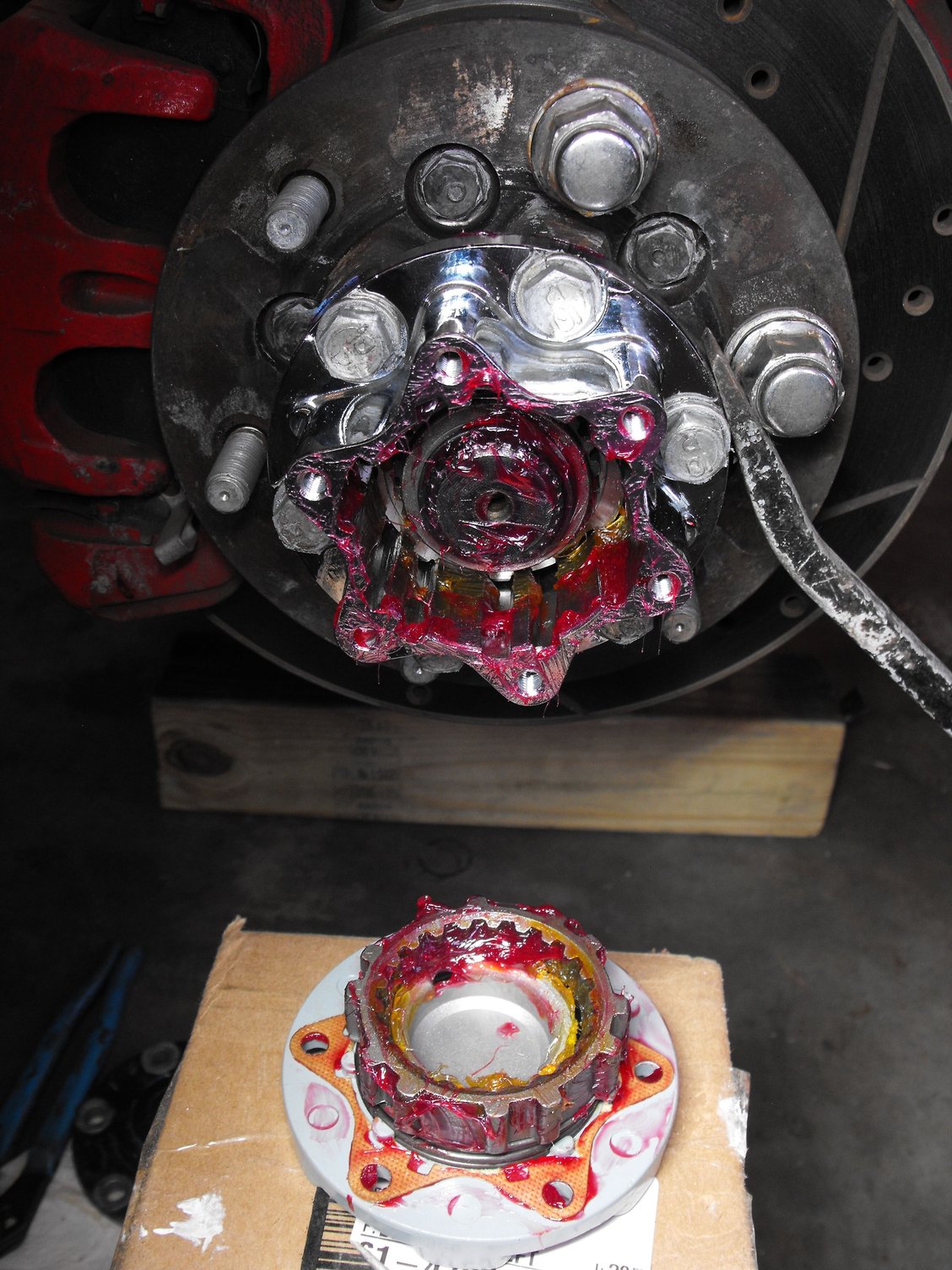

Then I screwed on 2 wheel nuts and used used a prybar to hold the hub as I loosened the six 14mm bolts:

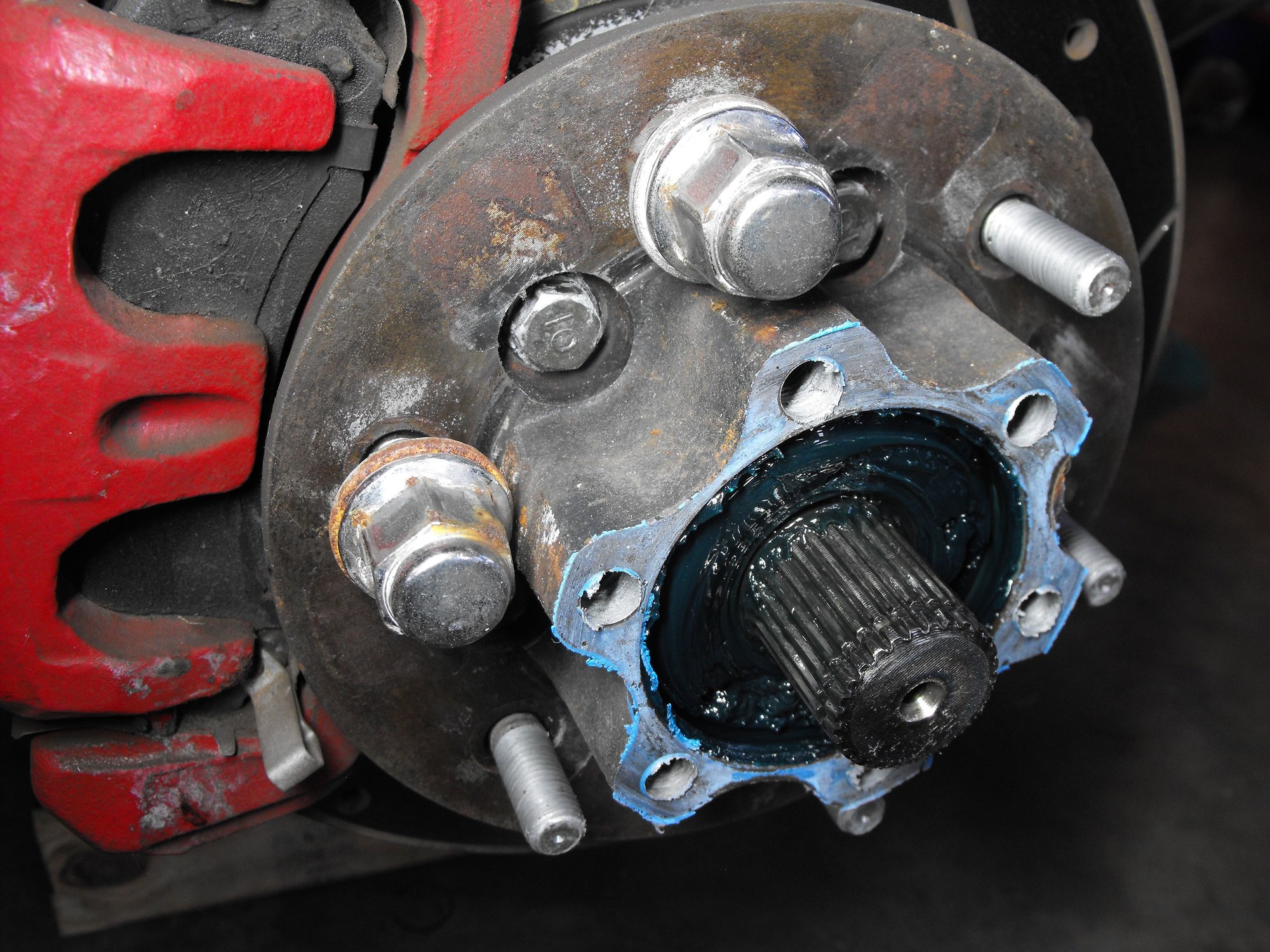

Due to the blue RTV that I had used in the past, I had to tap a bit in order to get this old hub top off.

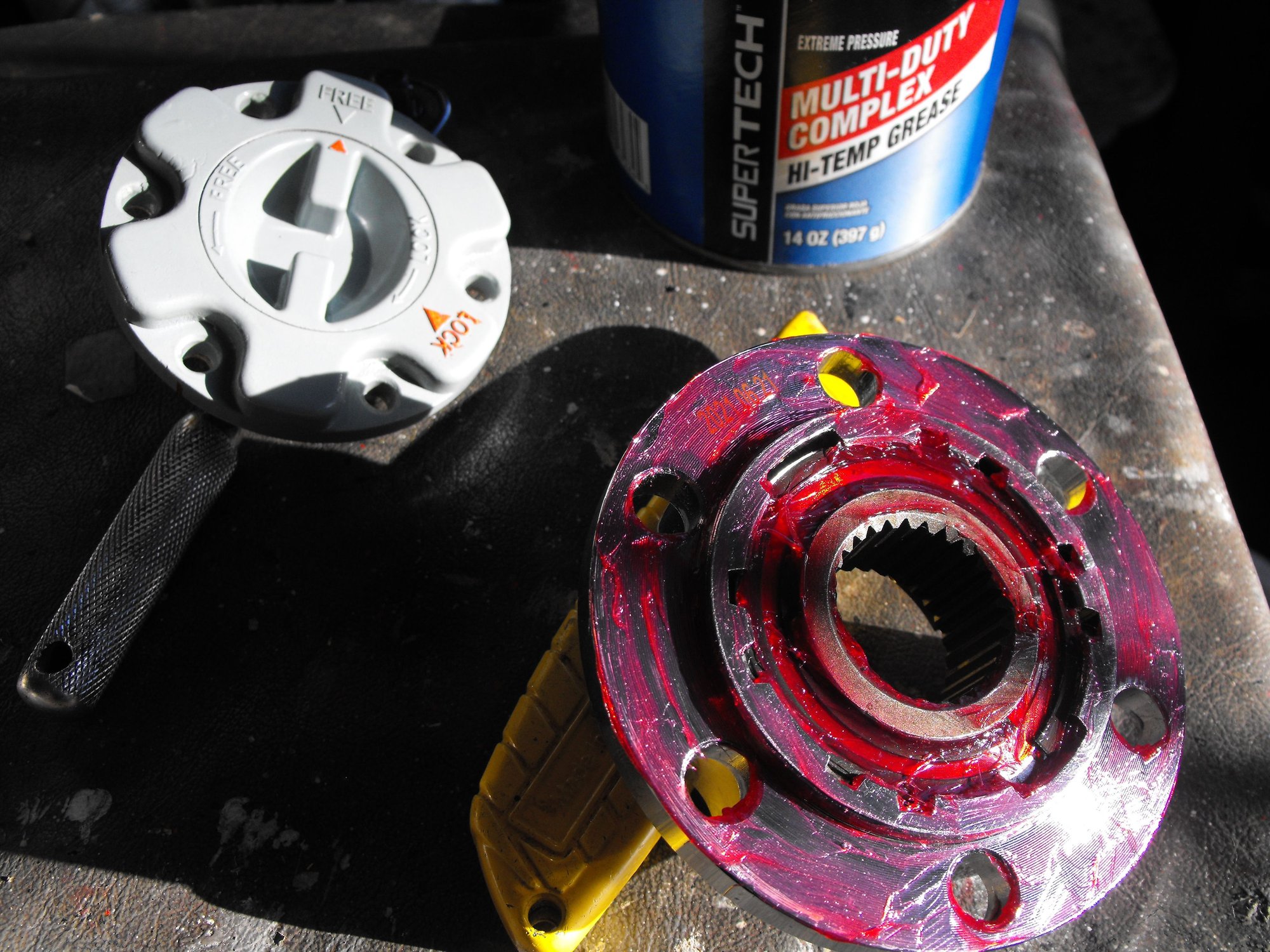

Remove the six 10mm bolts on the new Aisin hub: All of the bolts on mine were only finger tight, so they came off easy. (I used a red marker and made a small line where the two halves come apart, so I ensured putting them back the same way. Not sure if this is necessary, but it went back together with ease by alligning the red marks).
The Mfg. did have some grease included on the inner hub workings, so you can spread that around, and its a good idea to add a bit more and cover all the surfaces on both sides of the new hub. Instead of using RTV to seal this new hub to the existing hub on the vehicle, I just used a thick grease. The next time I have them off I will probably put a skim of RTV on to keep it water tight. Also, go ahead and torque the six 14mm bolts now, as you cannot get a socket on them after the new outer hub half is installed.
Installing the flat washer and C-Clip: (Screwdriver just used to hold parts for picture. I again used the c-clip pliers as I pushed on the c-clip).
C-clip and washer installed:

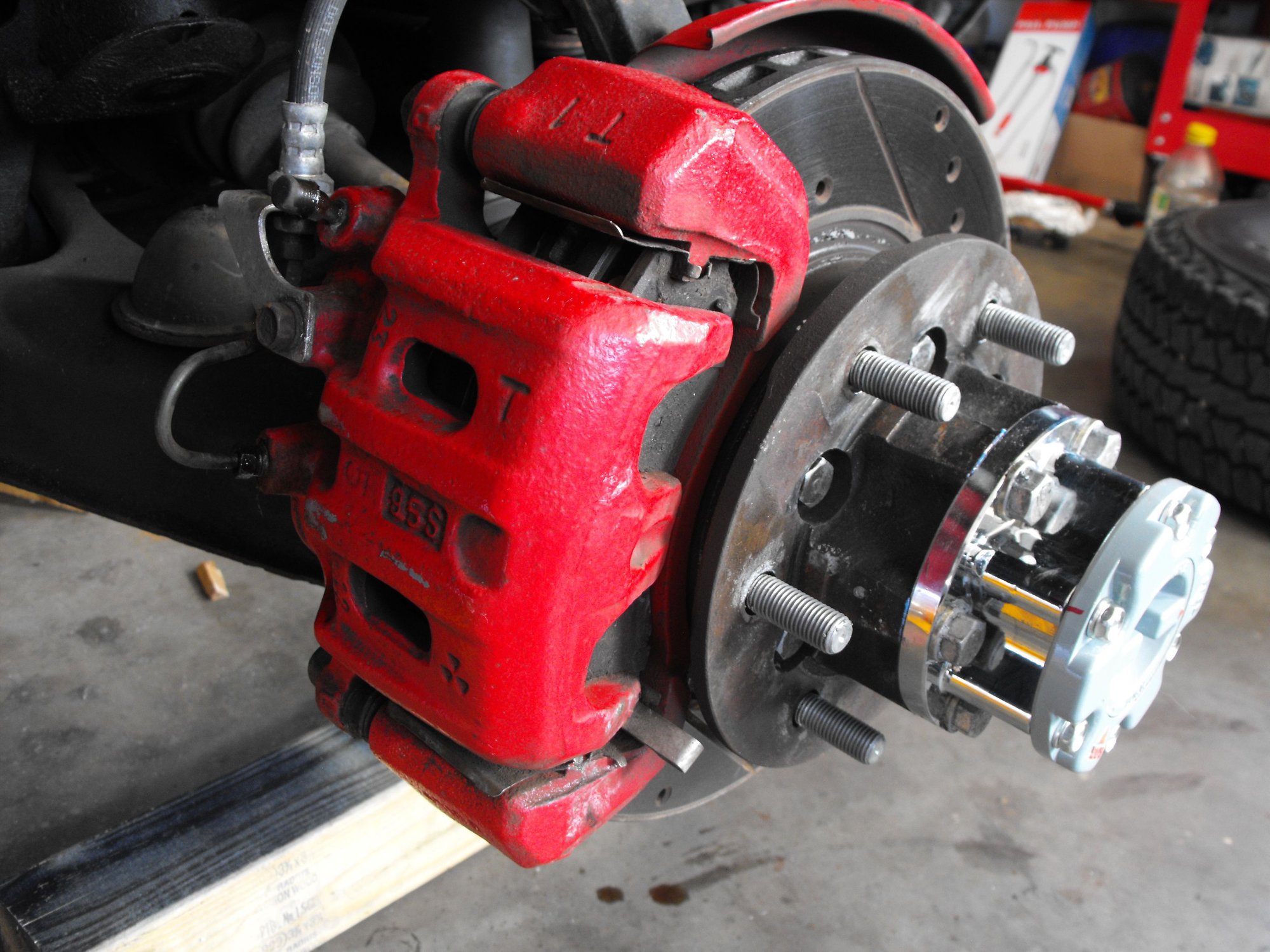

Grease on the small gasket and all over the top half of the new hub:
Ready to put it back together: (I made sure my red marker lines were lined up when putting the outer portion on with the inner portion). The six 14mm bolts are torqued now, as you cannot get a socket on them after the other hub half is installed.
Outer hub installed. Be sure not to over-tighten the small 10mm bolts as the threads could strip if you do so. I just applied enough torque to flatten out the lock washers and a wee bit more.
Now rotate the wheel and you should see that the CV axle does not spin. Then rotate the dial to "Lock" and spin the wheel......now the CV axle will spin.

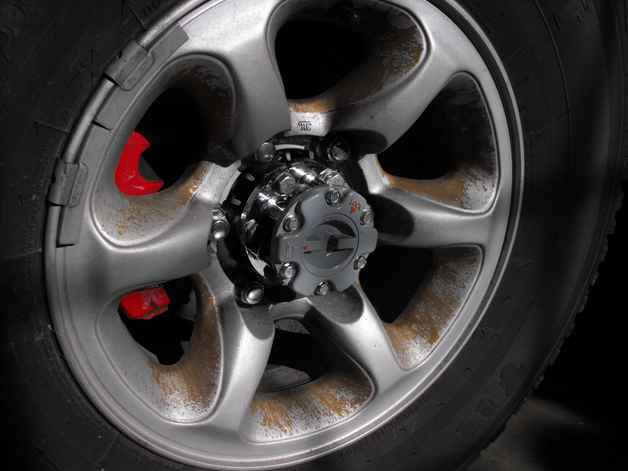

In case I forgot to mention it, be sure to make a "mark" on the new hub so you know exactly how to re-allign it when installing it. Apparently it must go back on just as it came off, or the hub may not work right: (small red line on new hub below):
With wheel back on:

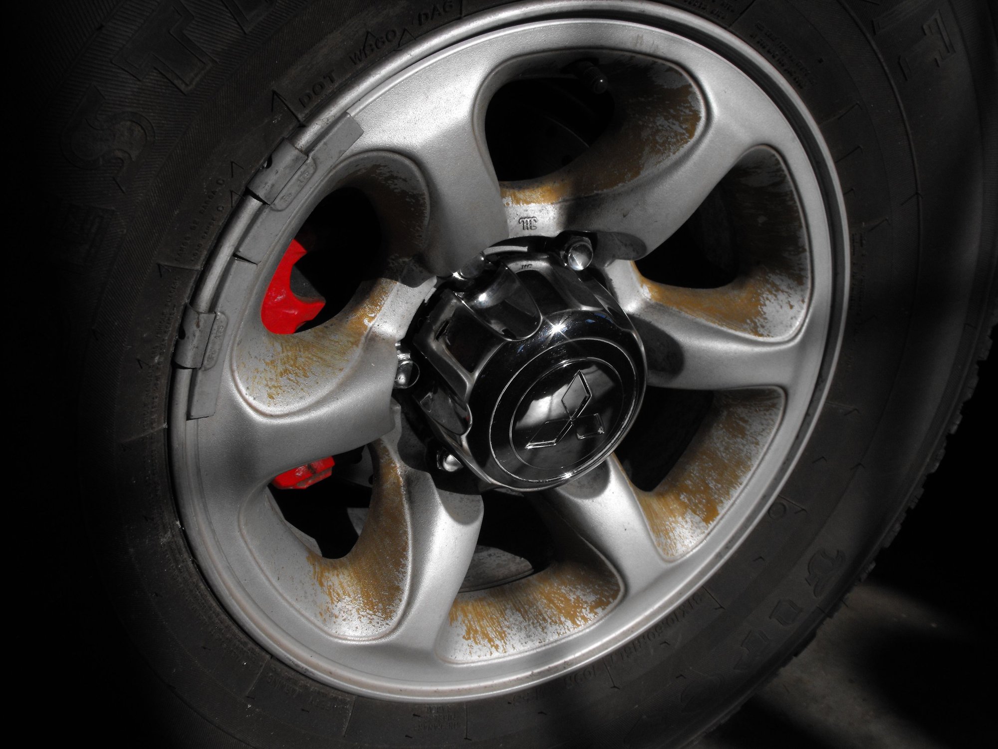

I left the chrome hub-cap locking ring on the wheel thinking that the chrome hub cap may fit over this new hub. However, the original center hub caps will not fit, so you can remove those wire locking rings and stash them away for future use (along with the original hub covers/center caps) in case you need to use them again.
The chrome hub caps are about 1 inch too short now to snap back on:

Hunter.....Thanks.....at least it went together good, and it works. As you can see, someday I need to try painting those rims. If they are aluminum rims, why do they have that gold base coat underneath the silver?
