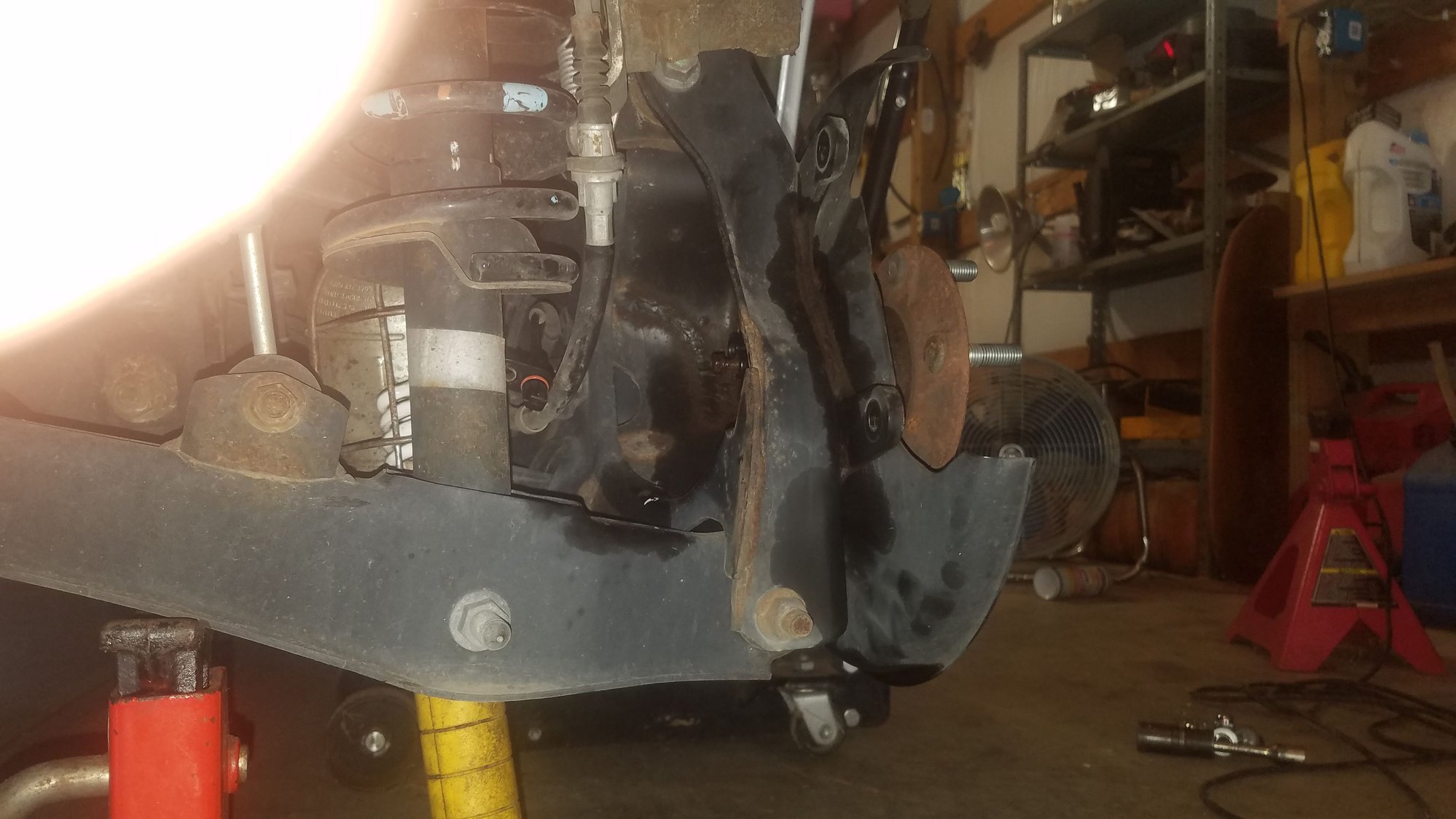

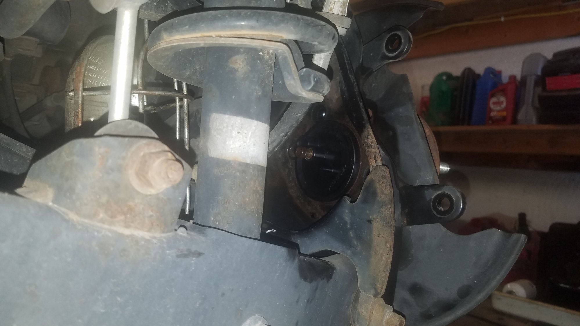

The passenger side rear bearing is bad. I have rotor off and 4 bolts out on backside of bearing hub but it still doesn't seem to want to come off. Is there something else I need to do?

Got it. Used a punch and hammer to break it free. Basically hit it so it turned.
