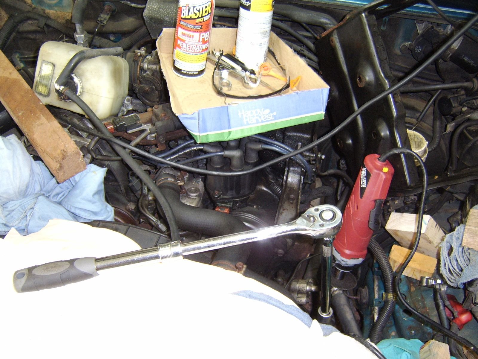

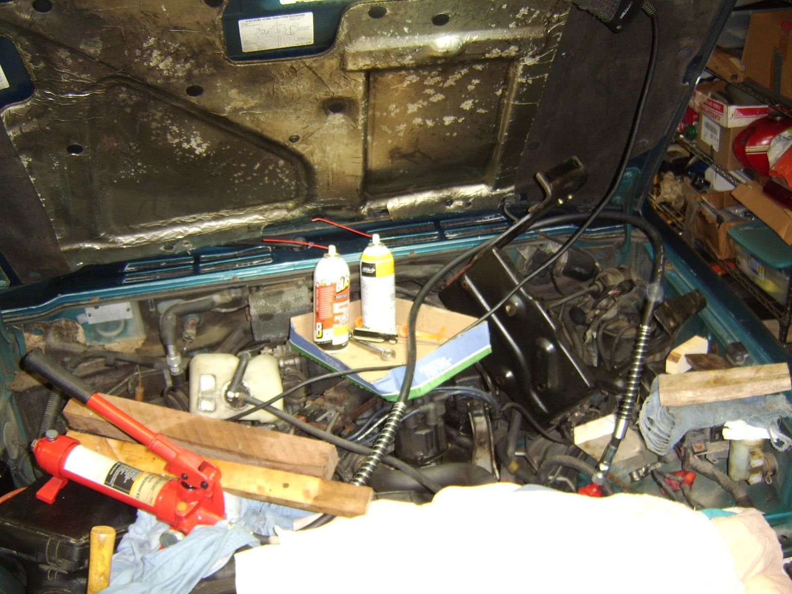

Hunter..........Well, I got out the hydraulic wedge, but did not think it would really work in this tight situation. Set it up, and managed to squeeze it between the wrench and the side metal fender, and the sucker actually worked great.......but can only push a bit at a time, and then I need to release it, and put various sizes of wood blocks between it and the wrench or the metal fender. Slow process, but at least I have managed to unscrew it about 3 to 4 turns.....but it is not getting any easier to turn. I also tried some torch heat on it, and more penetrating fluid, and its not turning any easier. Pics:
Wedge pushing wrench counter-clockwise:
Using blocks of wood:
Cant get much action from the wheel well......I can flip the wrench up-side-down and it will stick out right beside the top of the shock, and I can barely push it in a couple inches, and then have to work from under the hood. Repeat the process over and over again, and have only backed it out maybe 3 - 4 turns.
Has anyone else ever tried to remove these power steering lines? I wonder how many hours were allocated in the factory service manuals? (Multiply by 10 for a rusty, 25 yr-old Monty).
Will tackle it some more tomorrow, and hopefully the PB Blaster will continue to work.

You're on the right track. Almost sounds like the nuts and the pump had "grown" close together over time. Try to spin it another way now (half a turn) to see if the crud will loosen up. Does the nut rotate free on the pipe, or is the pipe moving with the nut? Any chance you can take the pump and pipes all out together of the vehicle to work on them on the bench?

Yep........the steering box and nuts have "melded" a bit. The pump is on the other side of the motor, and it sends these lines over/under, and up to the steering box......I had looked keenly at the steering box and was thinking about removing it, but thats just way too much work.
I guess I could try pushing the wrench back clockwise a bit and see if that helps, per your comments.
Yep, that skinny nut is rotating free on the pipe, and not shearing off the pipe.....its just super tight and onwry.
Upon more reflection of the situation, it would be very tempting to just cut out a large section of the inner fender to make access to these nuts alot better......and then just make some mounts to screw it back into place.
