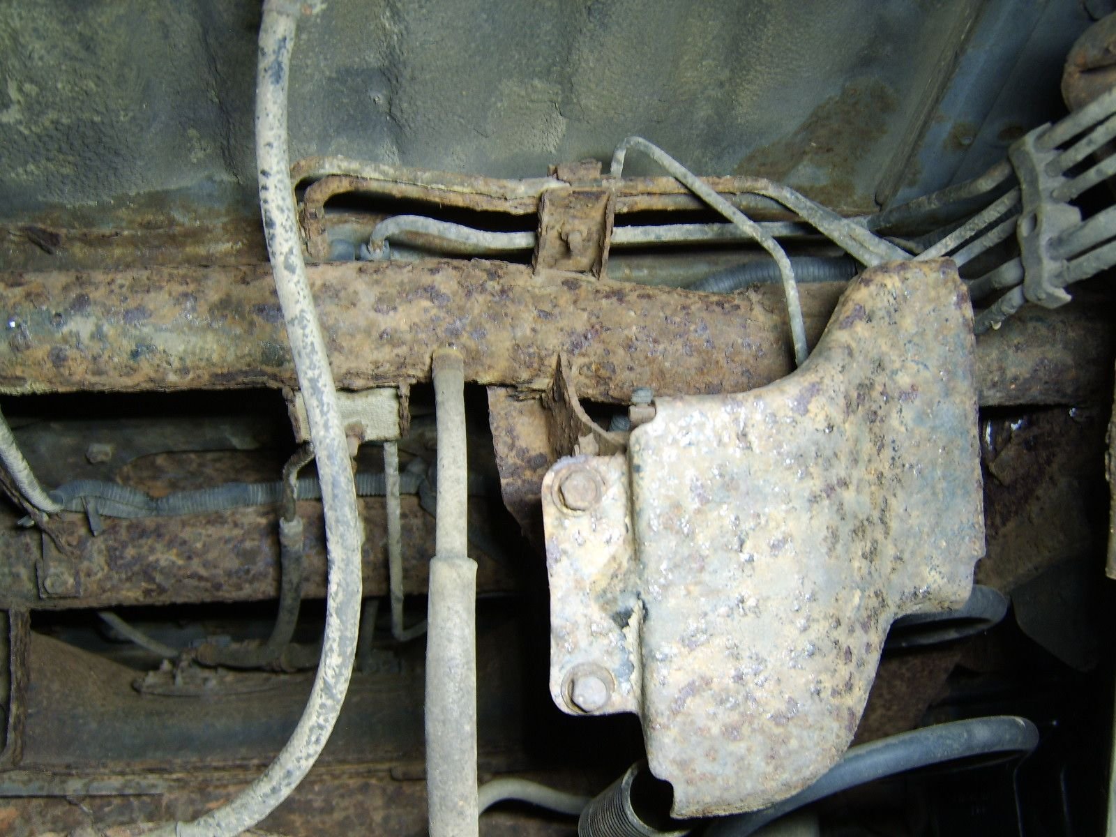

Speak of air locker.......one of my 94s (SR model) with the rear lock has the following issue: I put the tranny into the 4x4LLC, tranny in neutral, and push the air locker button.....compressor runs and keeps running, but the locker is not engaging. I think it must be a rotten hose/line going to the pumpkin......you agree, or you think it could be something else? When I crawled under, the line is pretty bad, and also alot of rust where it bolts into the pumpkin. Guess I just need to be under the car and spray some suds on the line while some knucklhead turns on the button for me, and look for bubbles. I think the compressor only puts out about 8lbs, but might be able to see a leak.
Locker air line where it is held by the floor brace: A few bends and it will snap right off:
Where the line plugs into the Pumpkin: Pumpkin has seen one too many Halloweens and taken the abuse of the brooms of one too many crazy witches...ha ha:
You think I can still order this entire air locker air line?

About that rust, I would get under that rig and chip or wire brush (needle gun?!?) all of that crust out of there to see what is going on. Slather on some rust converter and give it a coat of paint or bedliner and stop the madness!!!
That air line is low pressure and can either be made or bought, but i would be stunned if it held air the way that it looks. If its holding air, try letting the rig roll backwards about ten feet while engaging.

Mark.....Yep, I have plans to clean up the rust and paint. Also need to drop the gas tank so I can weld a piece of metal to the rear section of the frame since it has a large rust hole in it. On my "to do list" for sure.
Is it hard to get to the air compressor......I assume it is under the rear seat, maybe accessible thru that secret door panel on the right side (opposite the door panel for the jack). Since the compressor keeps running, there must be a leak in the line. Whats the simple test to see if the rear lockers are working?

Hard? No. Just peel back the carpet after taking out the rear seats, and the cover with the two access doors (left and right, jack and open storage) is just a few bolts from being removed. You will then see the rear locker air pump in all of its glory, sitting in the right side of the cubbyhole, awaiting your attention.
You could easily run a new, all rubber, or silicone (preferred), line, all of the way to the rear pumpkin. While you are in there, run an extended breather tube up the D pillar behind the rear side window.
