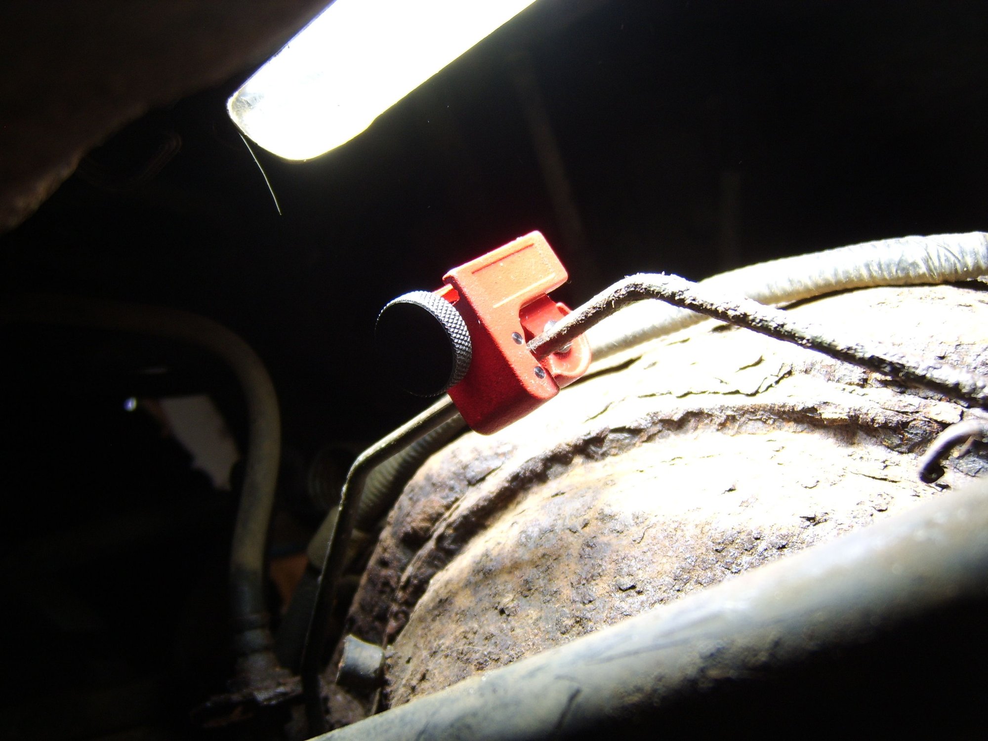

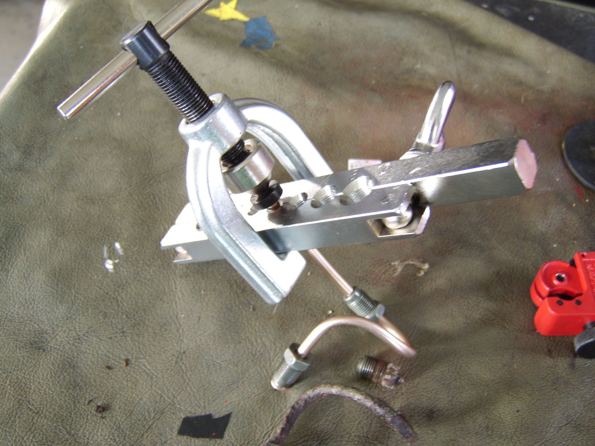

Finally got the copper/nickle rolls of 3/16" tubing, and a ton of fittings. I went ahead and tried the compression fittings on this short repair. Here is the wee-little tube cutter that came in a $12 flare tool kit on ebay. I first sanded the rough rusty surface of the line where I was gonna make the cut. Wiped clean and then this little cutting tool worked great:
Line bends easy, just using a socket or sometype of round surface to hold it against. In my case, I used the chrome rear turn signal shaft on my old 78 Goldwing.

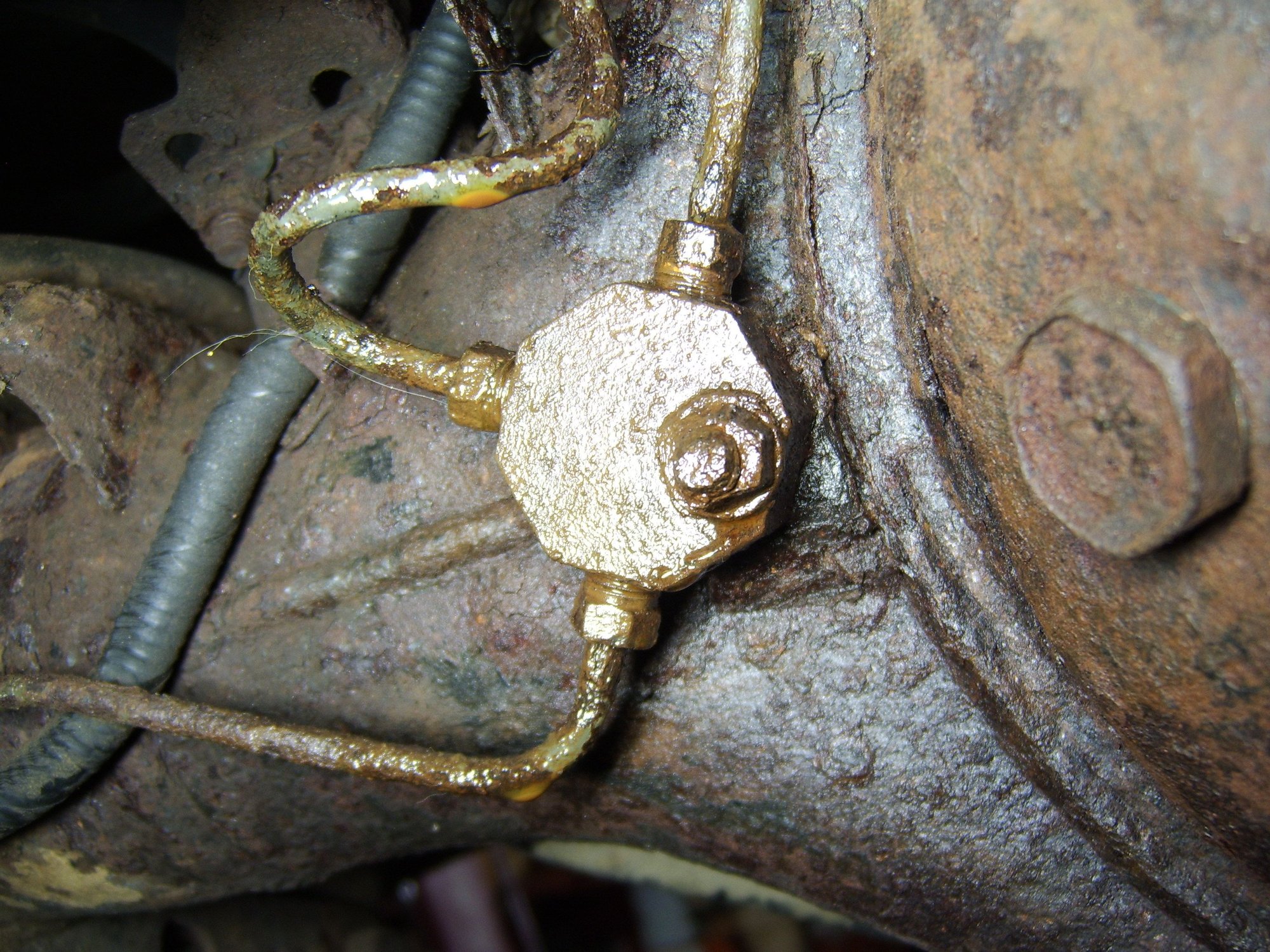

Here is that T connection on the left side of the diff: I had been wirebrushing, picking, and soaking with PB Blaster for weeks, and still cannot get the fittings to budge. So that was one reason for using the compression fittings as a quick fix. Does anyone reccomend heating the brake line connectors to help break them loose?

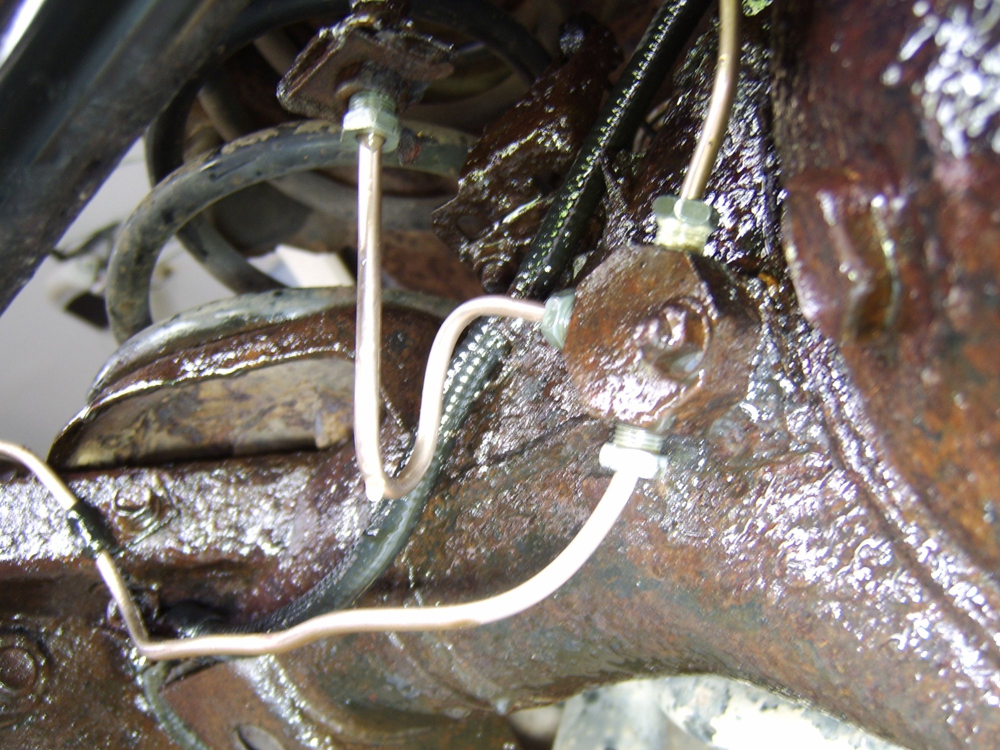

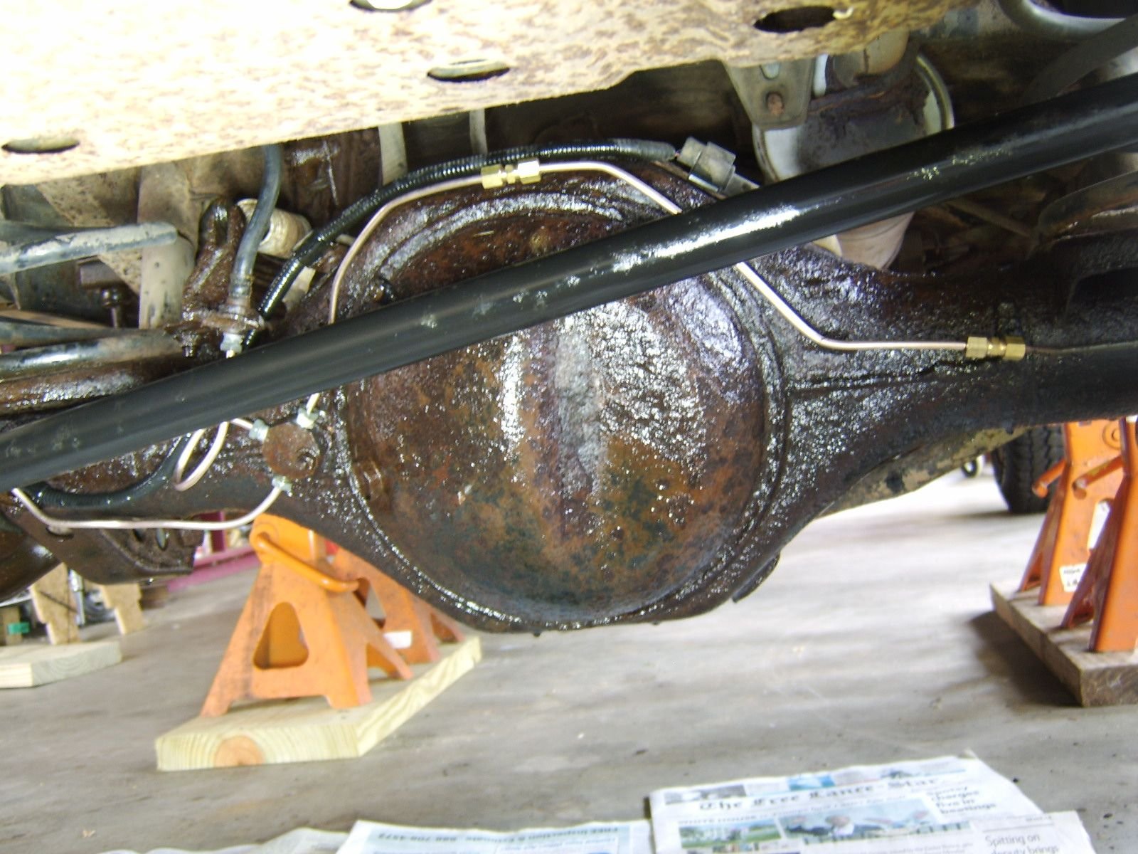

More brake line repairs:
After making the one repair to the brake line along the rear differential, 2 more lines sprung leaks, so I had to bend more tubing.
One trick I came up with was to pack some pipe thread goo into one of the 10mm fittings, and then screw it into the connection to stop the brake fluid from leaking as I measure, cut, and bend the new lines and use the tool to make the flare bubble ends:
The good, the bad, and the ugly:
I also learned that you cannot "over-tighten" these brake line fittings.....doing so will smash out the soft bubble ends, and then cause leaks. The line in front of the coil spring (sink-trap appearance) sprung a leak at the top due to me over-tightening it: I had to fabricate another one to replace it.
New one installed, and so far "no runs, no drips, no errors":
Much better than before, plus the brakes work:

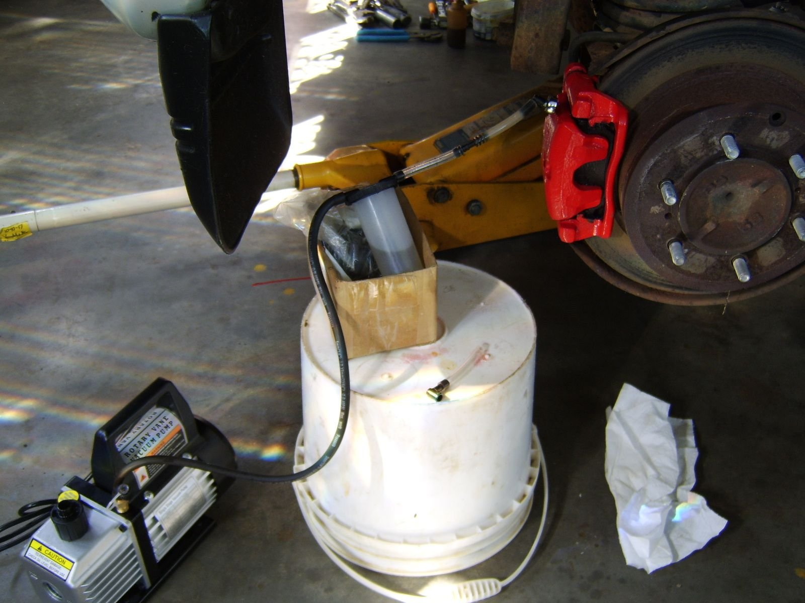

Another trick that worked pretty good was to use a vacuum pump to draw all the air out of the lines:
I used this on both sides, and the lines primed great (and no hopping on the brake pedal hundreds of times):
