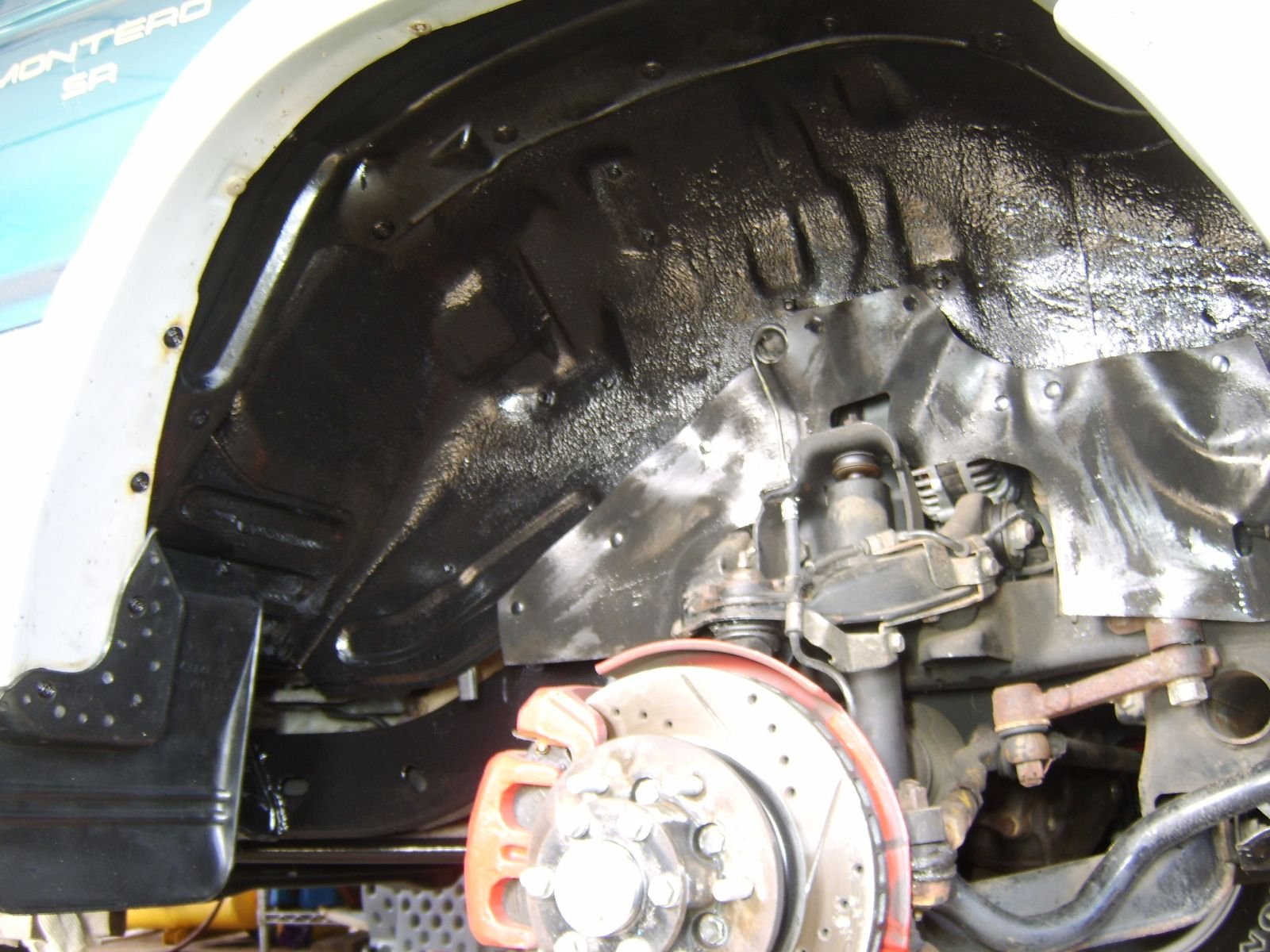

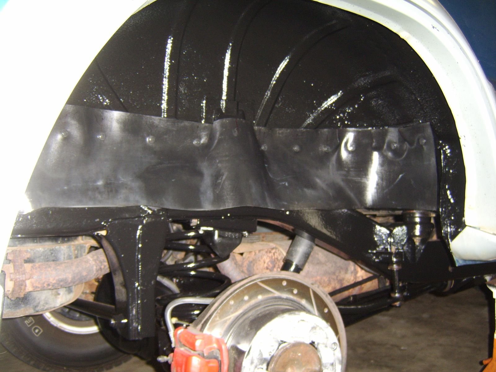

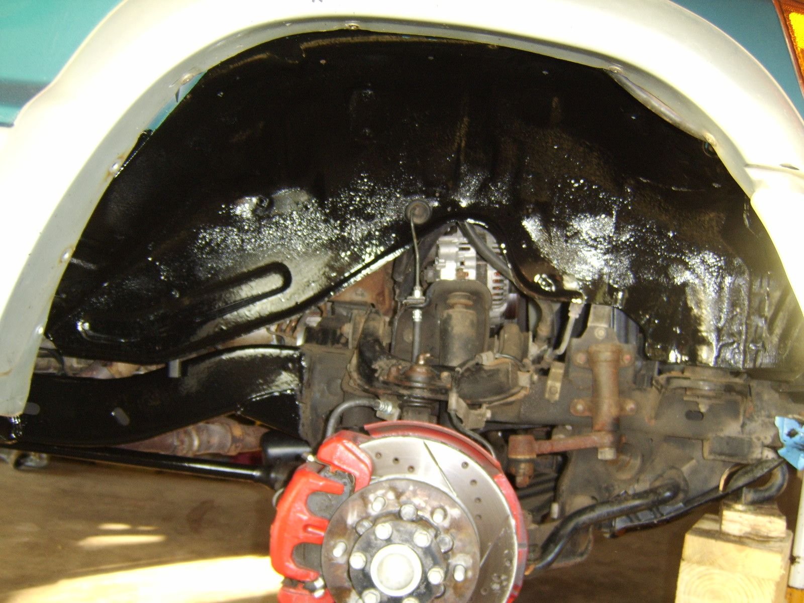

Perty enuff to frame on my wall: Im a real AreTiest....ha ha.
Getting the black done in the inner fenders:
The sad thing is that soon I have to let her down, jack up the other side, and repeat the process all over again........DOH!
Hunter......I checked the Monties again, and only the "SR" models have those rear inner fender hanging brackets.....not the "LS" or the base model. So, looks like it was made just for the SR models, and the only thing I can guess are inner splash shields. Would love to hear from someone who knows for sure.

Dude you are a pure Michelangelo. That paint looks good and I'm sure it will help to at least slow down the rust to a crawl.
BTW, I see you have slotted drilled rotors. How are they holding up? I tried an aftermarket slotted drilled rotors once, but they have warped much sooner than expected. So I went back to OEM solid rotors.

Slotted/drilled rotors.....well, I am pretty light on the pedal, so most of my brakes/rotors tend to last almost forever. But I suppose these will not heat up as fast.

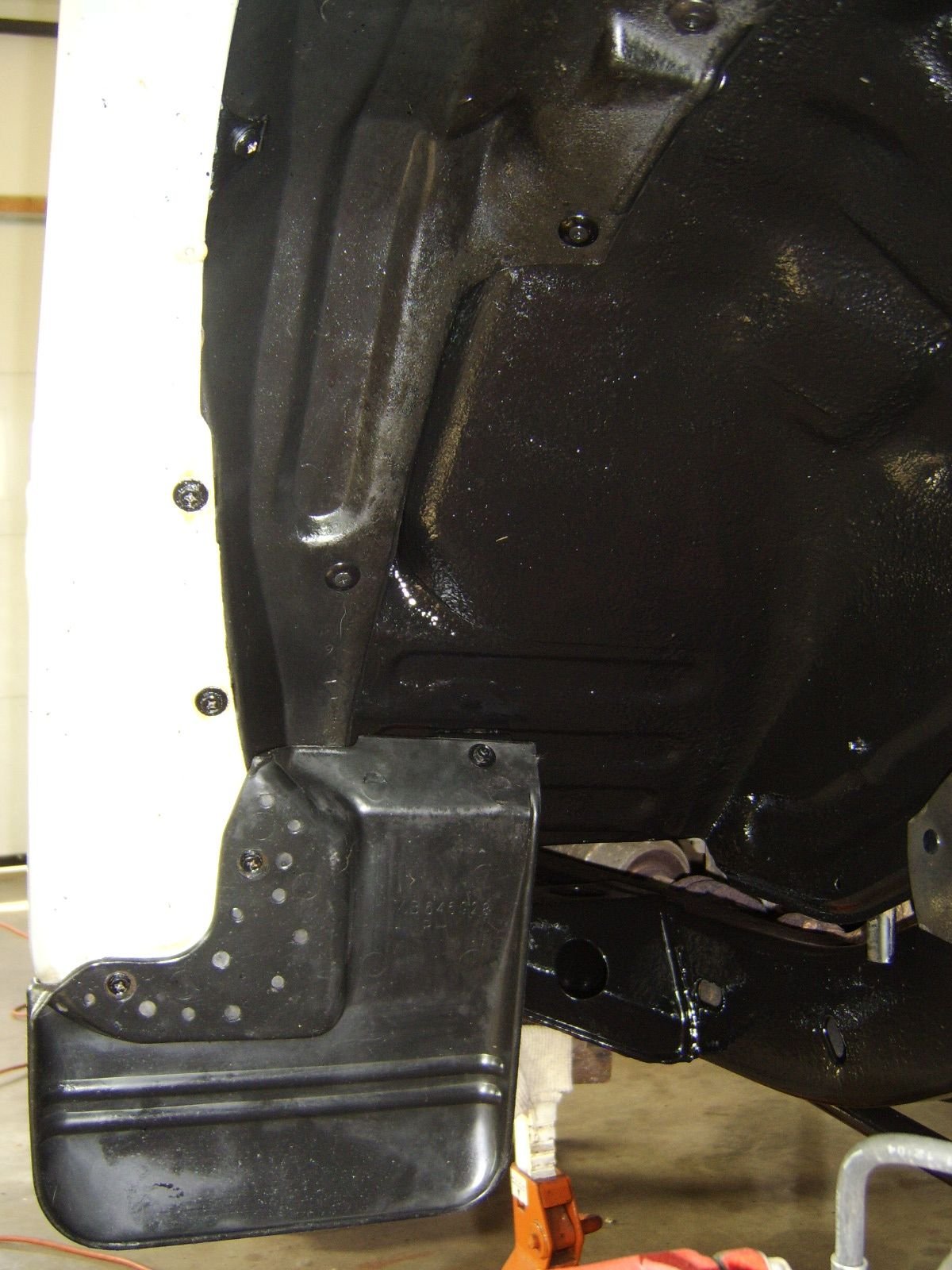

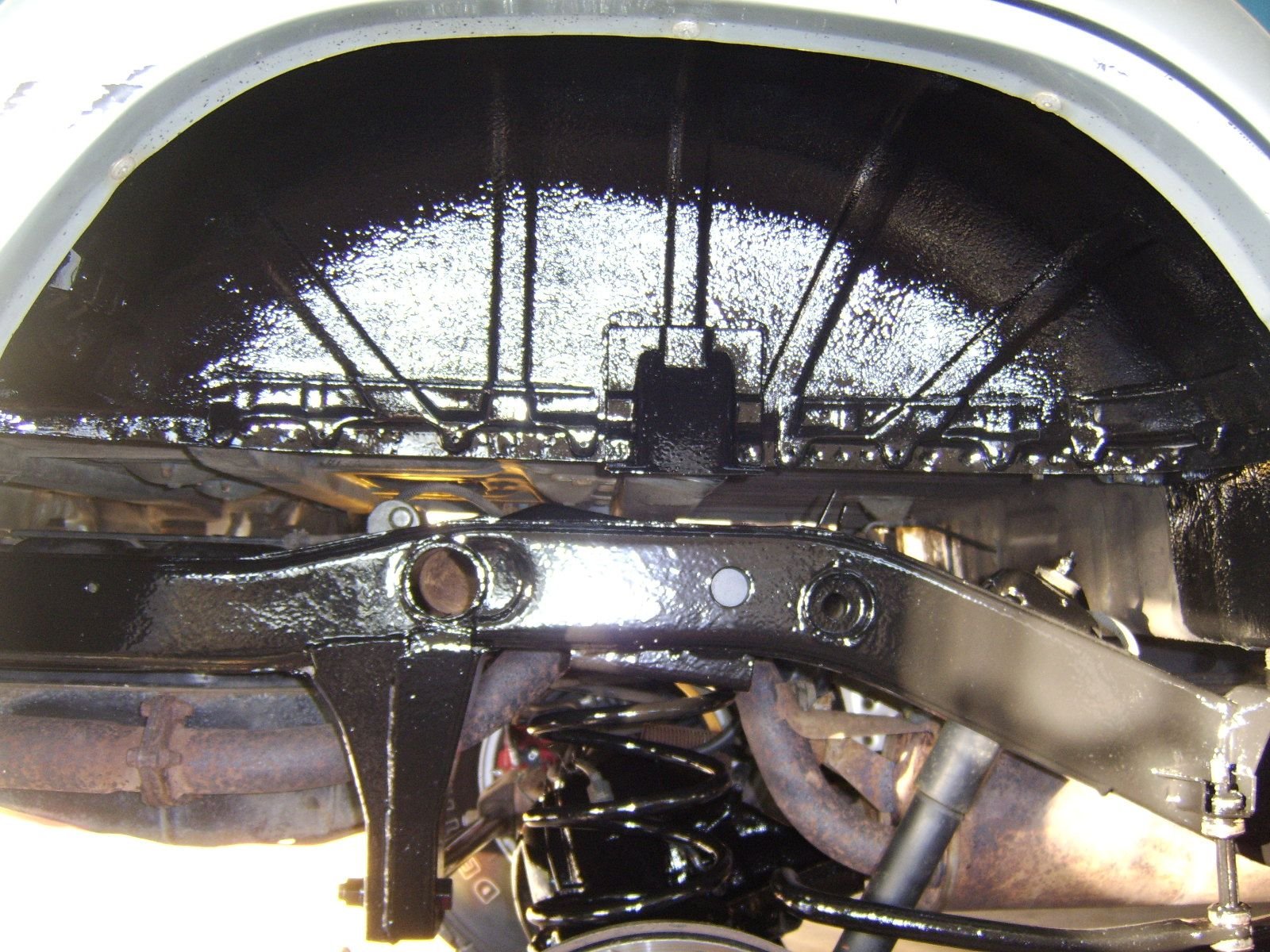

A few more picture updates:

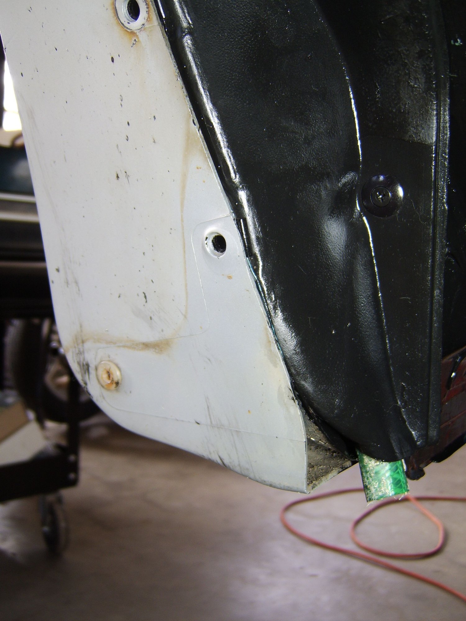

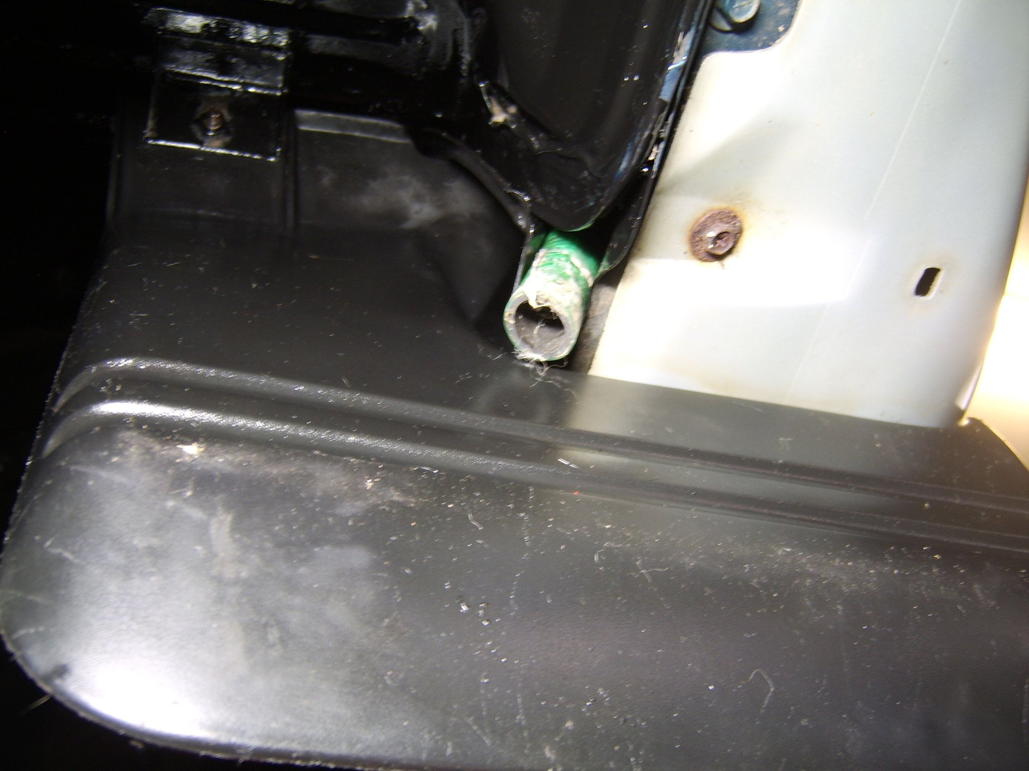

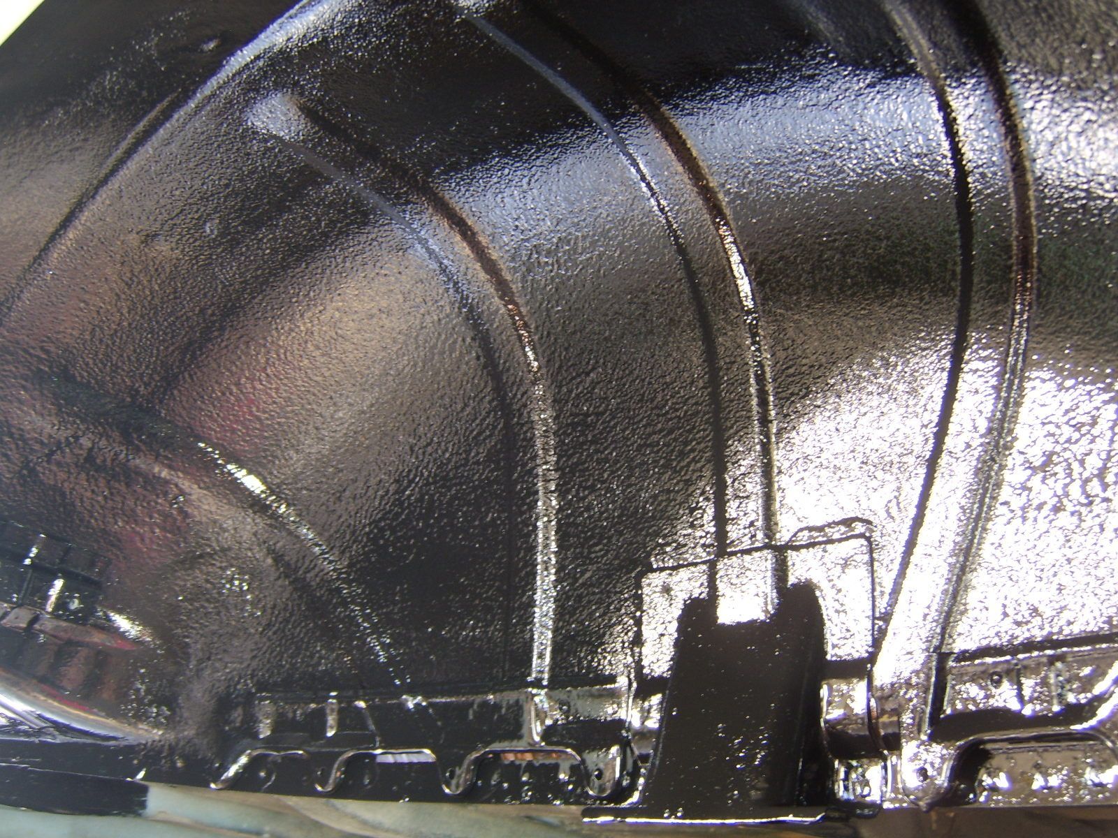

I managed to put an extension hose on the front sunroof drain hose. I had an old piece of garden hose that fit perfectly over the existing hose and a simple hose clamp holds it in place. No more rust potential in that fender area now:
The inner plastic fender liner fit right over the garden hose:
Splash guard totally hides it:
This is all you see from the bottom (last thing a roadkill would see before his misfortune):
Front inner fender now done:

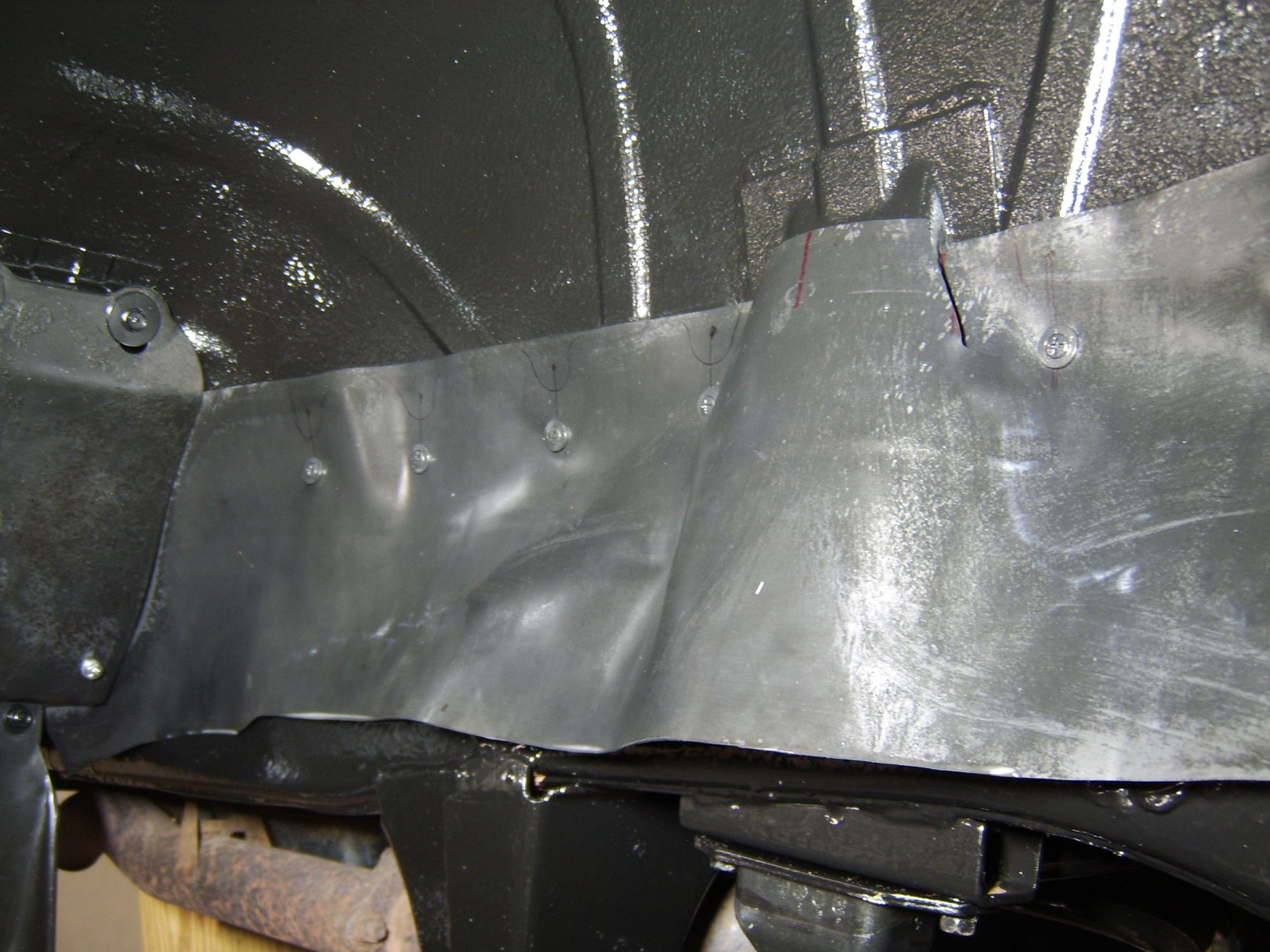

Managed to fabricate an "Inner Mud Flap" for the rear: (Maybe its "fac-tree"):

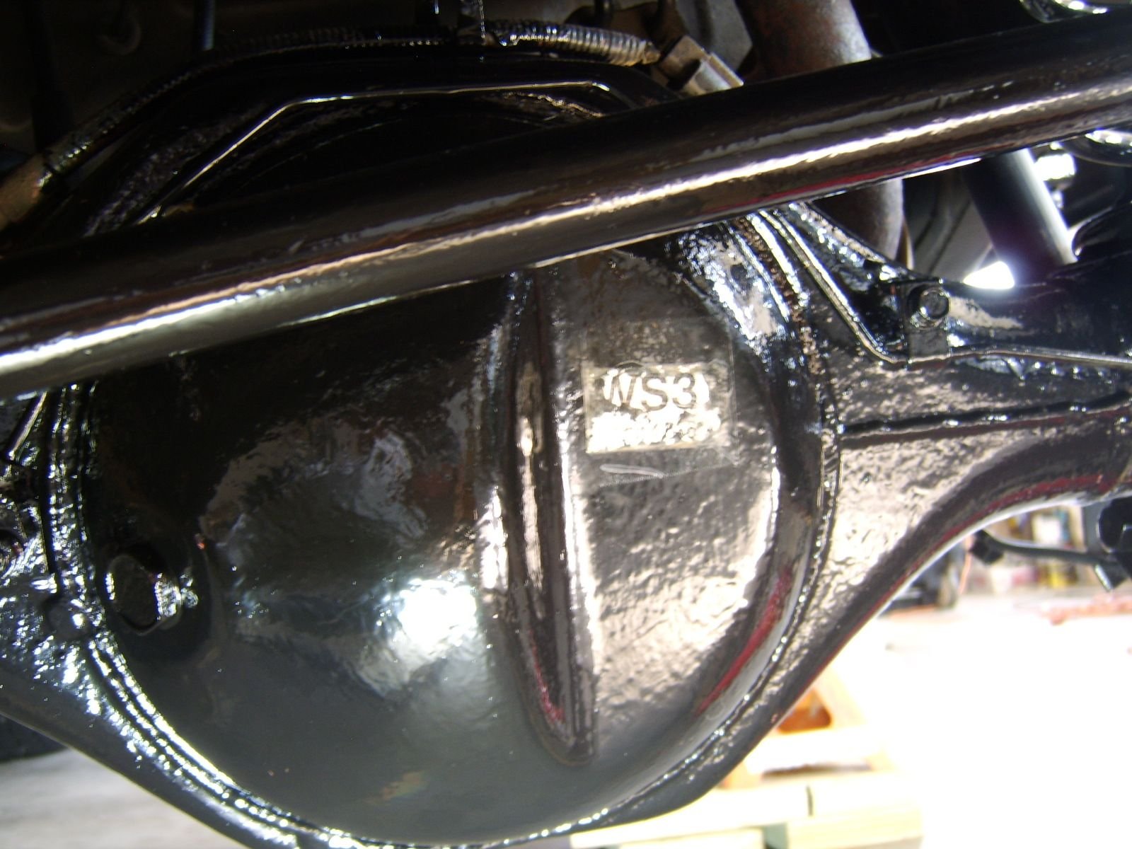

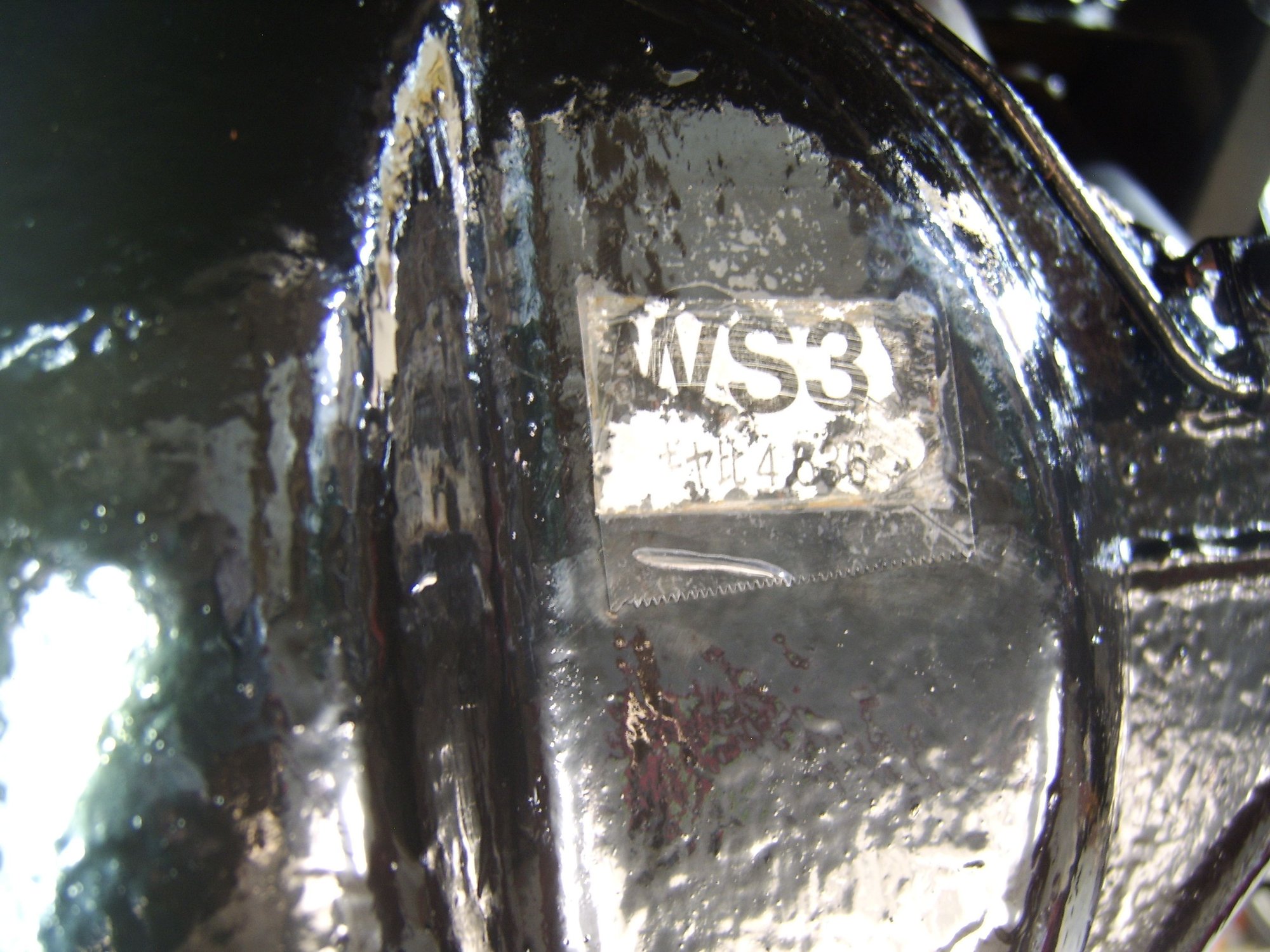

Hunter........I saved the Rear Pumpkin sticker and stuck er back on after painting:
Any idea what the "WS3" stands for? Code for the Air Locker option?

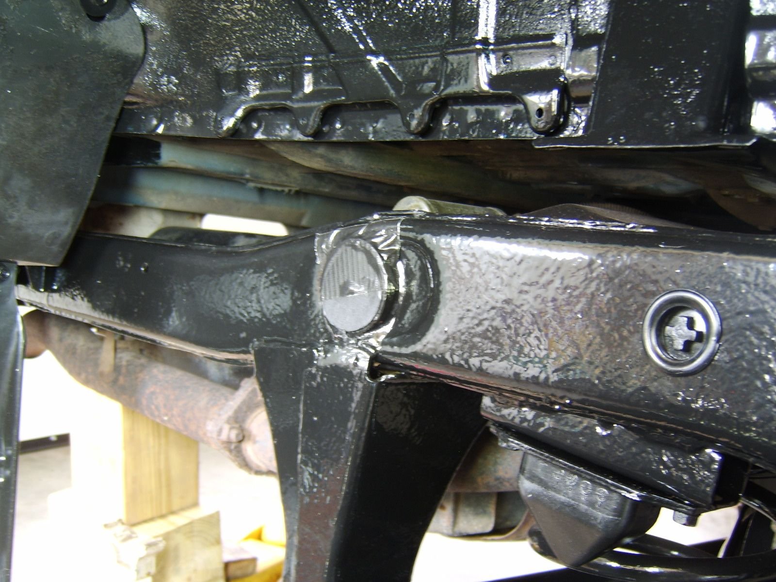

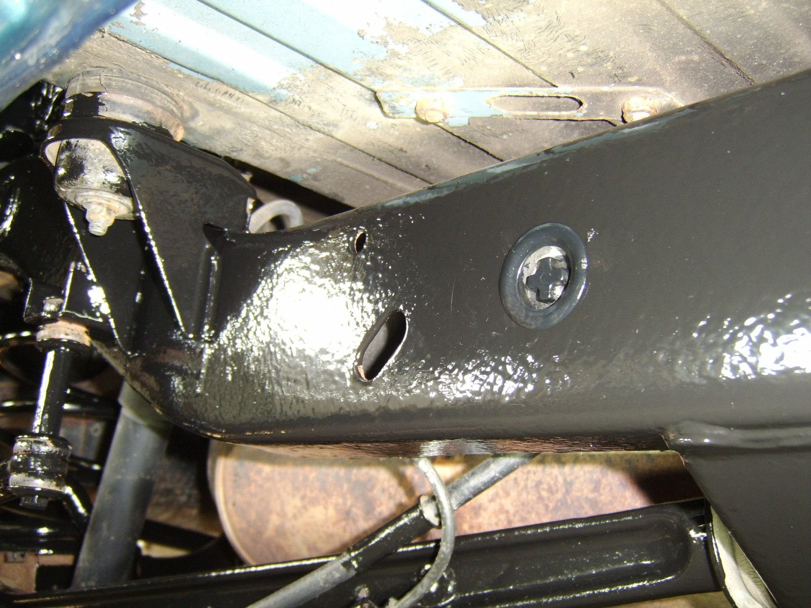

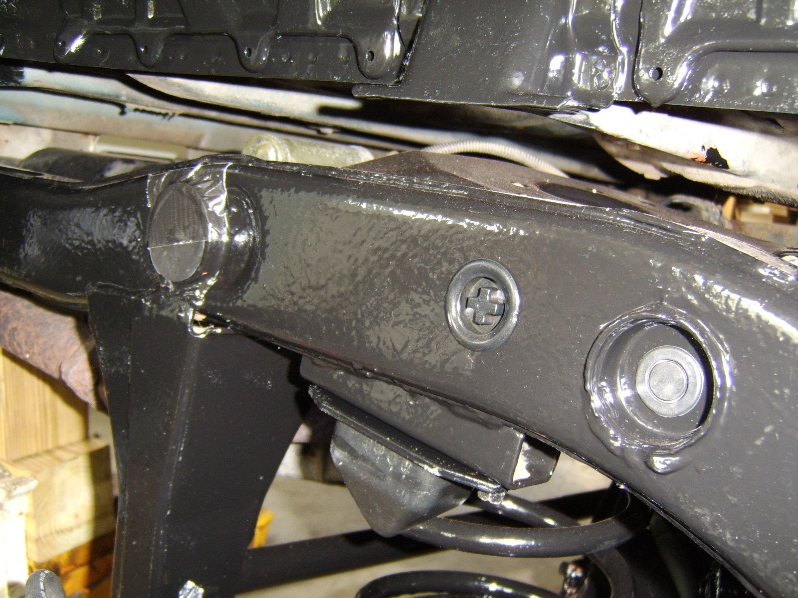

Another question for you: I popped all the frame plugs back in after painting the frame. Why did they go through the plug process, and leave other openings unplugged? Pic:
Two unplugged holes:
I found a scrap plastic cut-out that fit great as a plug for that 2" horizontal frame tube.....taped on top, and moisture can still drain from the bottom:
Old Sep 28, 2019 | 07:06 PM
  #30
Looks really nice. I don't know what "WS3" stands for. My guess would be same as yours - air locker option.
