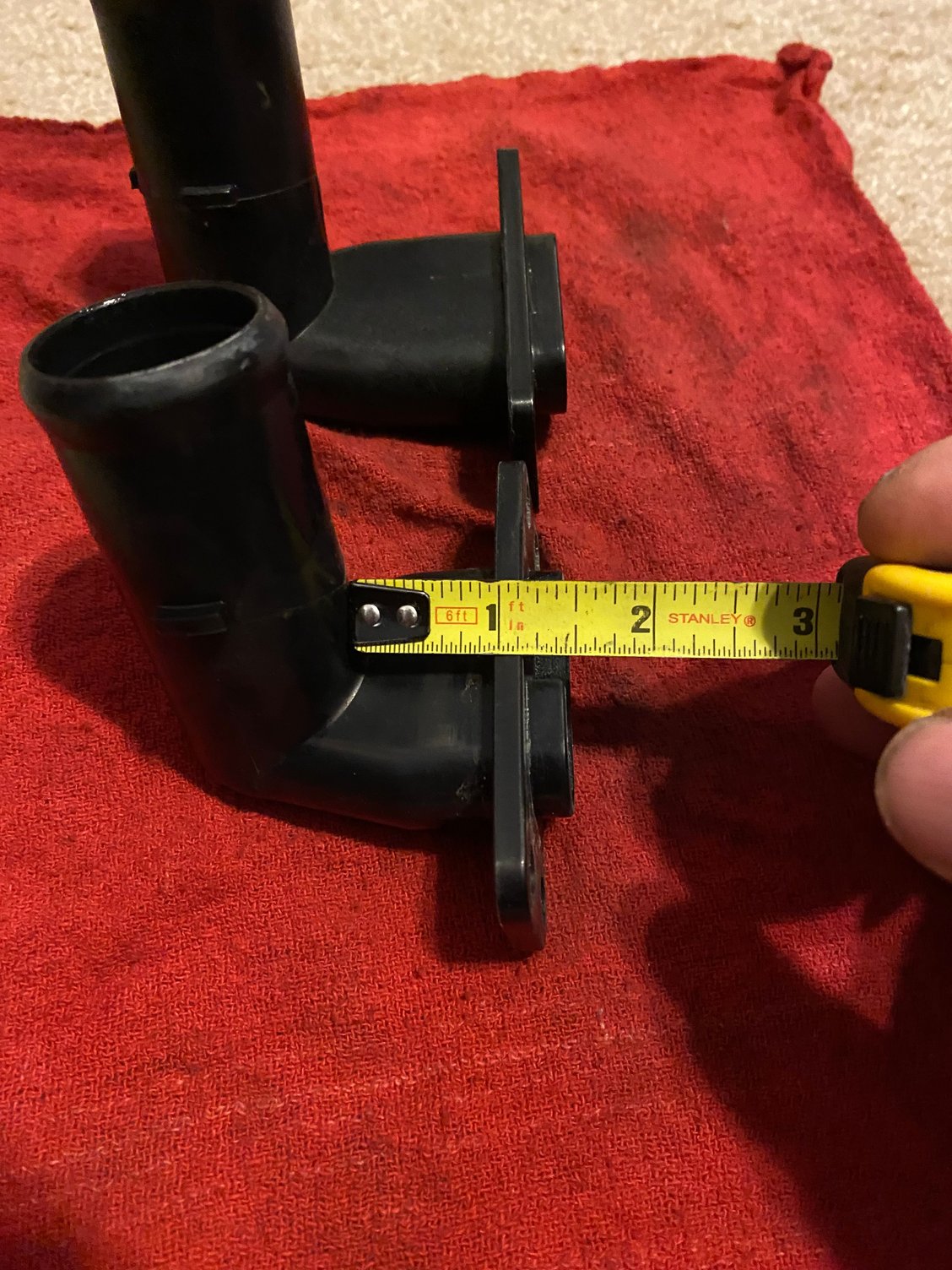

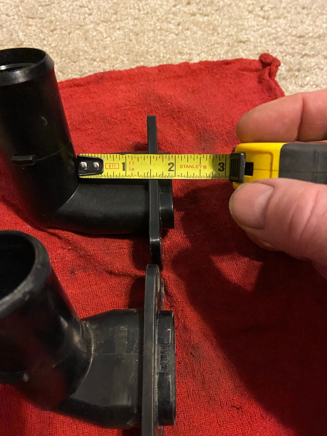

I've put eyes on three different AFTER market radiators and they all have a larger LOWER hose adapter. (plastic)
The adapter is so close to the a/c compressor pulley the hose would touch when installed.
I've included a couple pics to help illustrate. The 1" adapter is the one I removed from the original radiator and the 1 1/2" adapter is what I get from several after markets.
Note: I tried placing the old one on the new core and it won't seal. Drip leak about 1 per second. Who would have thought.
Anybody know where/how to resolve? What am I missing?
Thanks,
JC

Thanks for the heads up. A have to apologize for not following up myself.
After a bit more research, I discovered the vehicle had been in a minor "deer" accident and I had not noticed the mounting point was not in it's proper location.
The aftermarket would likely have worked even with the additional 1/2".
Thanks for all the info! I've book marked and likely will be ordering an OEM one soon!
