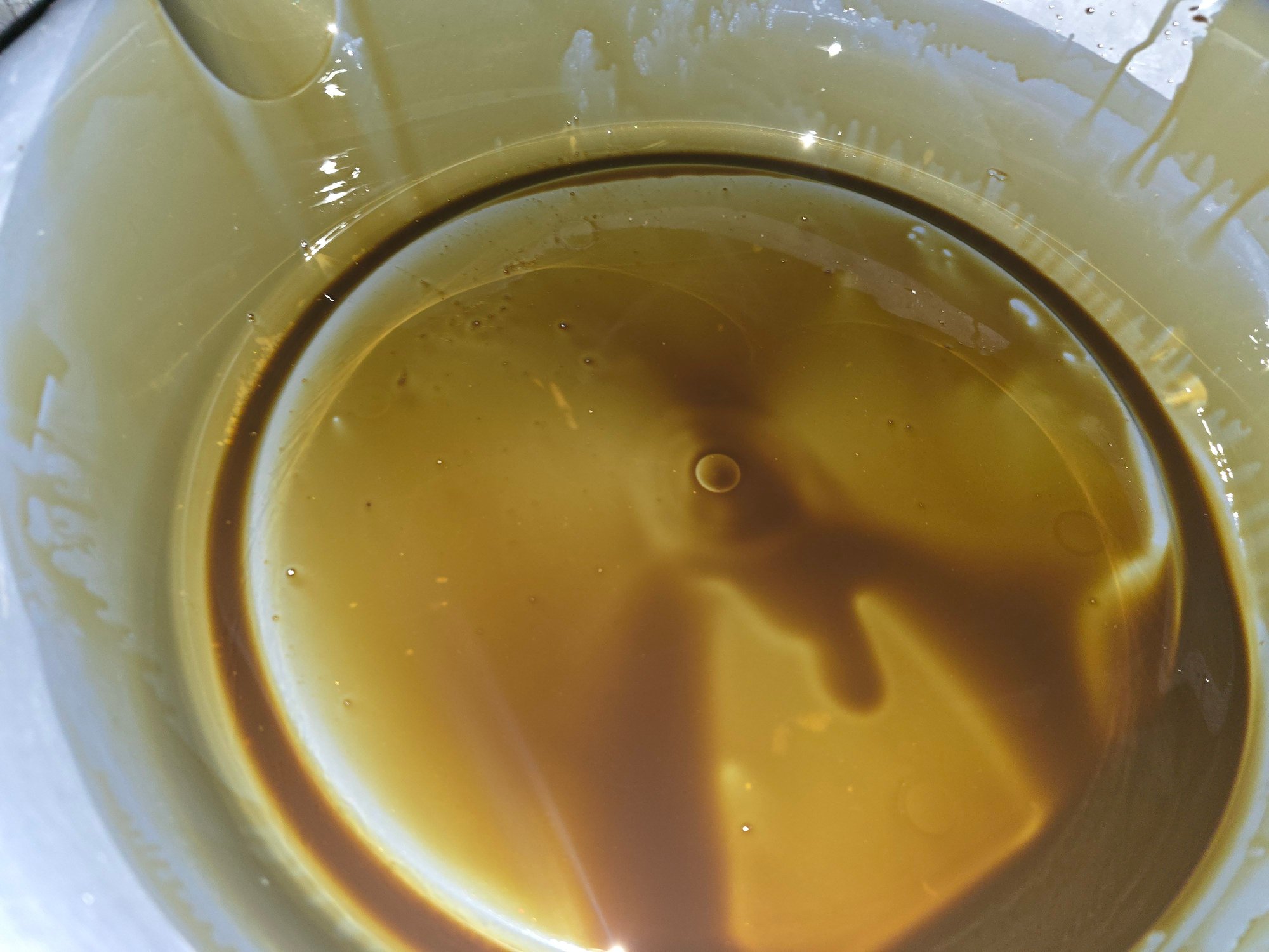

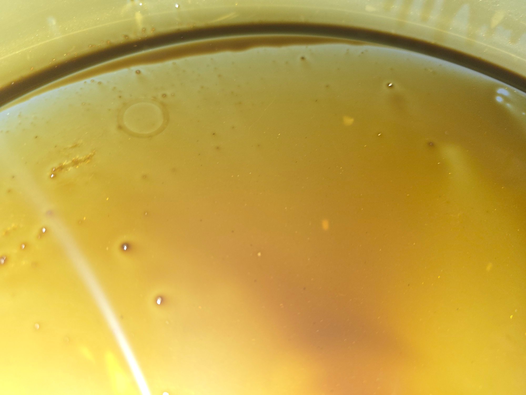

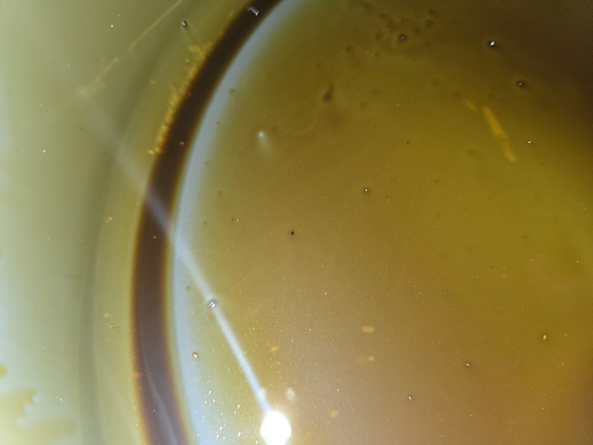

I need some advice/opinions here. I parked my montero over a year ago due to feeling a new vibration when accelerating, hearing a new but very faint knocking sound, and the engine sounding...hmm...louder in the cab(not an exhaust leak). I was convinced the engine was on it's way out but I've been known to overexaggerate when I suspect there's a new symptom. I changed the oil about six months ago or so and found some shiny bits in the pan. Well, good times never last and now I need to daily this montero sport again. Give it to me straight up. Is this engine toast? If it is, I may be able to replace the rod and main bearings with the engine still in the vehicle but it will not be an easy task and finding a place to do it will be tricky. (I live in an apartment) I've gotten quotes from mechanics anywhere from 3K to 6K for an engine replacement. Nobody wants to repair anymore, just replace.
I've spoilered the images due to their size. Also, the oil seems milky because it was sitting for about a year before I did this oil change and collected some condensation.
Spoiler
Spoiler
Spoiler

You're correct, those are likely bits from the rod bearings. The good thing - there are very few of them, which means it is in a very early stages of failure. That means it is very likely that you can get away with just replacing the bearings to get back on the road.

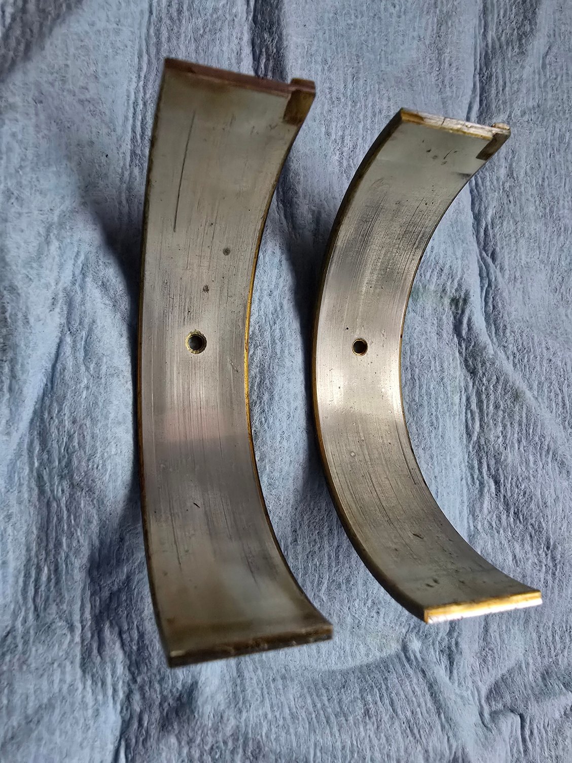

The work is done, replaced the rod bearings yesterday. Only took me 12 hours to do, mostly because I kept forgetting stuff and had to run out and get them. Probably would have taken me 8-9 hours otherwise. Didn't even need to jack up the front end either, I was surprised. Anyways, it seems to have been a success! Startup was smooth as butter, no rod knock, engine runs like a top, and my lifter tick is gone as well. I couldn't give it a proper break in yet as it's not registered so I can't drive it. I'll upload some pictures of the bearings as soon as I can, I'm pretty well pooped after all that work. I will say that I was shocked new bearing were even needed. The wear seemed pretty minimal for 200K miles.

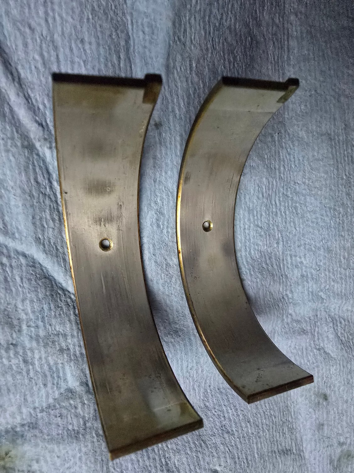

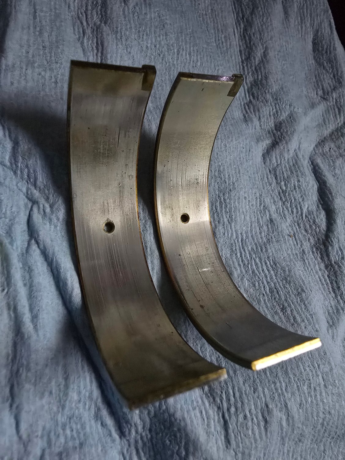

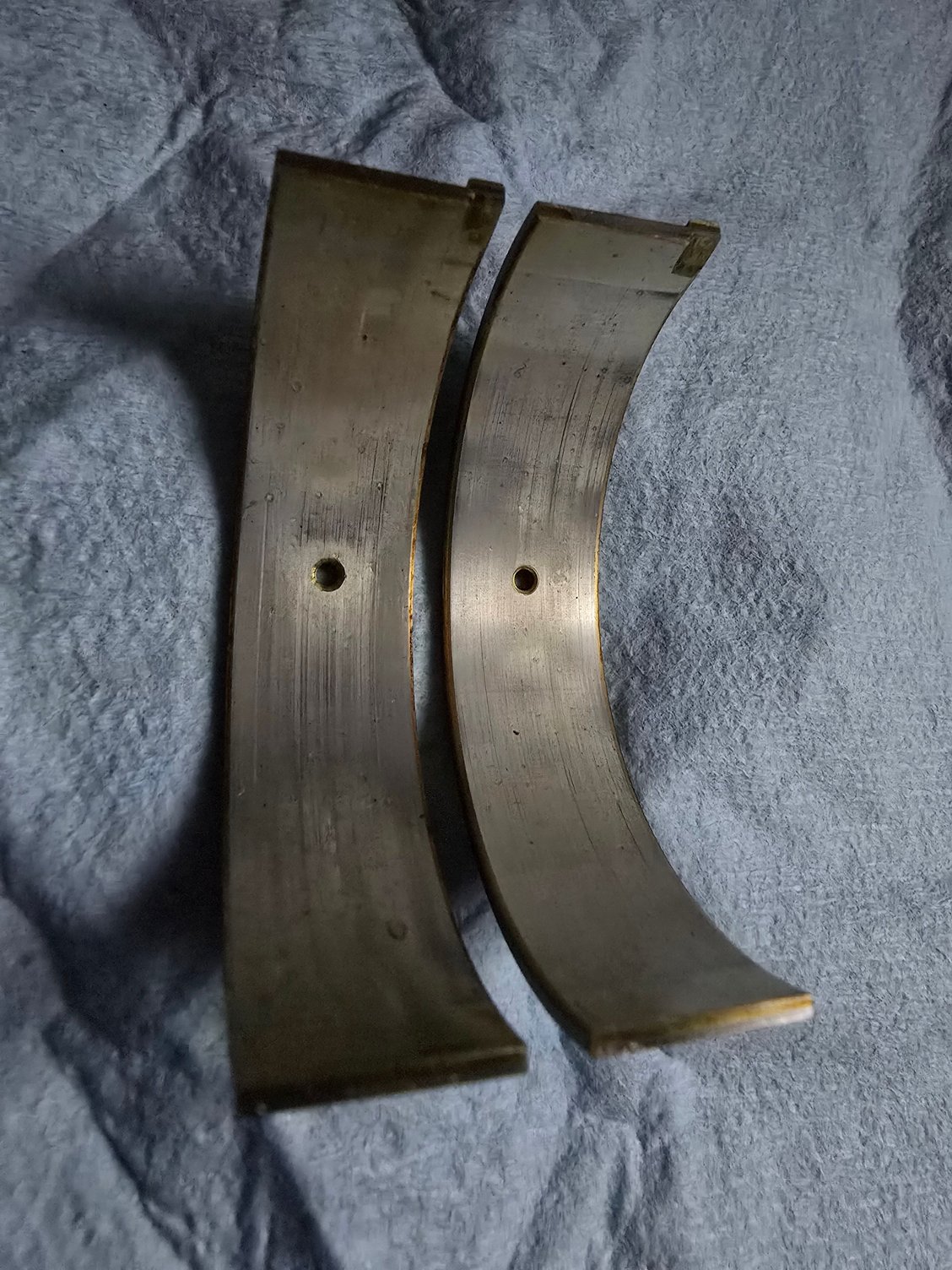

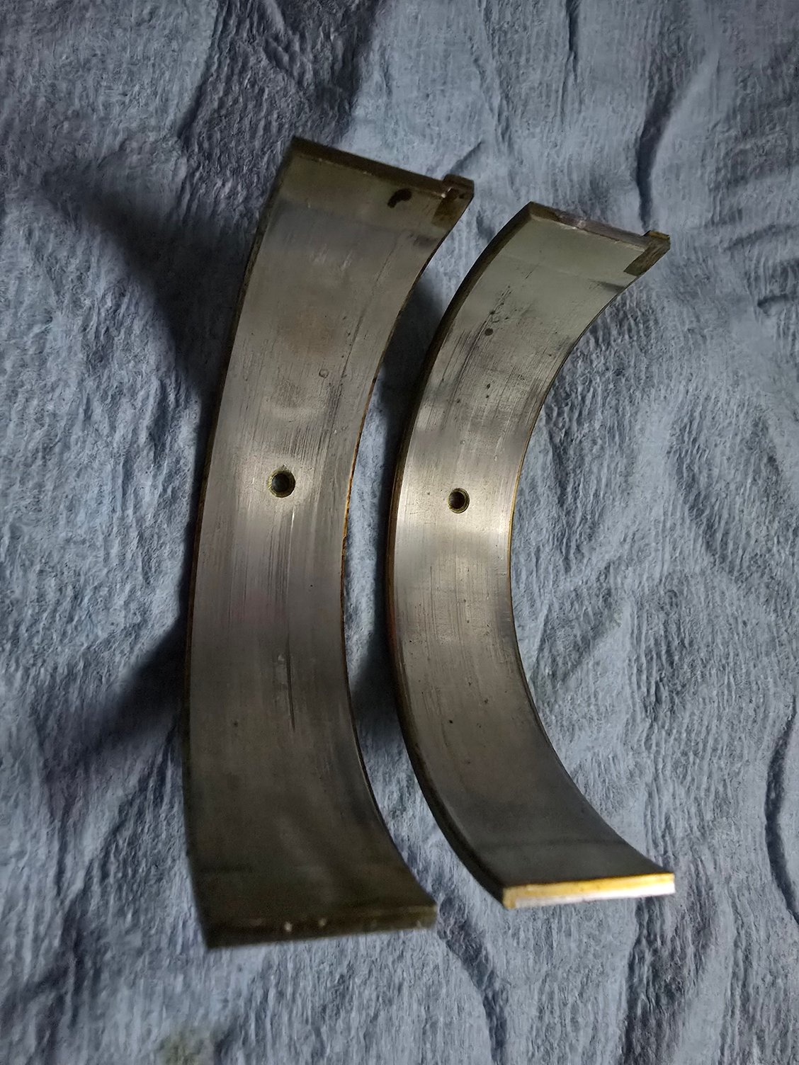

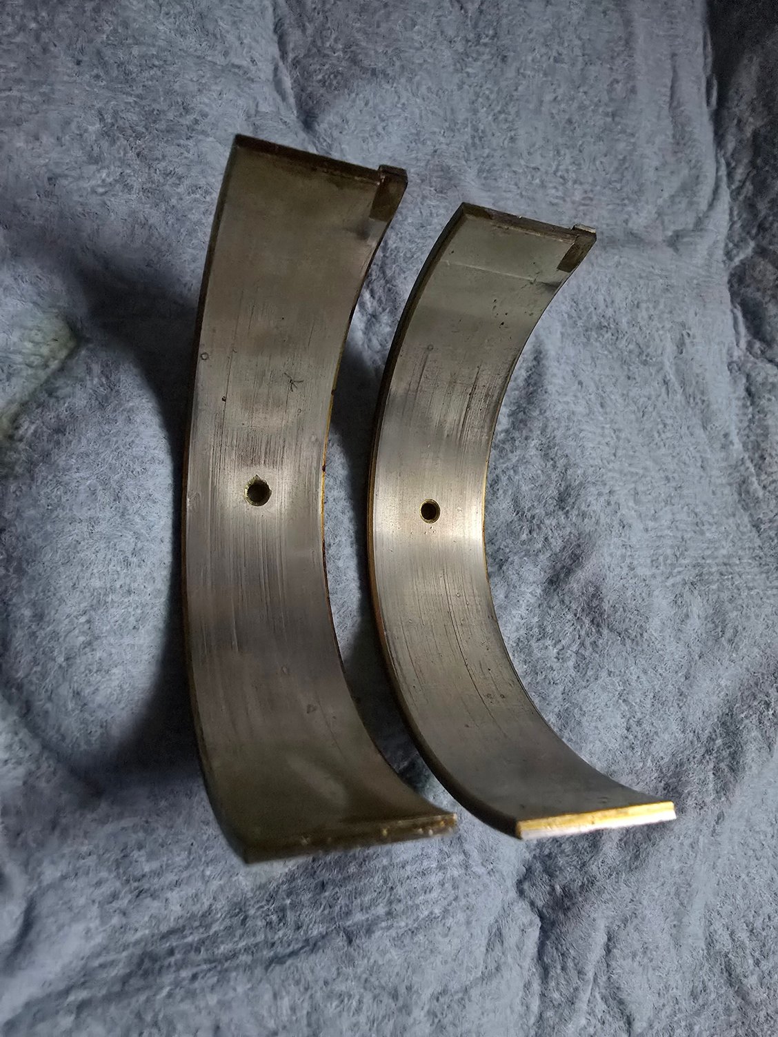

Well I couldn't sleep so here's the wear results for all cylinders. Under this lighting I was able to see a lot more wear that I couldn't see earlier. Guess I'm no longer surprised that the new bearings helped.
Cylinder 1:
Spoiler
Cylinder 2:
Spoiler
Cylinder 3:
Spoiler
Cylinder 4:
Spoiler
Cylinder 5:
Spoiler
Cylinder 6:
Spoiler

I was able to do it without pulling the engine and without unbolting the engine mounts and jacking it up. Although the oil pan clearance was good, the pickup tube was problematic. You have to drop the pan and rotate it around just right to remove one of the pickup tube bolts and loosen another so it swings around. I highly recommend at least jacking up the engine to give more wiggle room for the pan but I was stubborn. I took it for a longer drive today and I can say for sure the knock I was hearing and the vibration is gone. In true 6G72 fashion, the lifter tick is back, must've been coincidence it wasn't ticking when I did the first startup.
